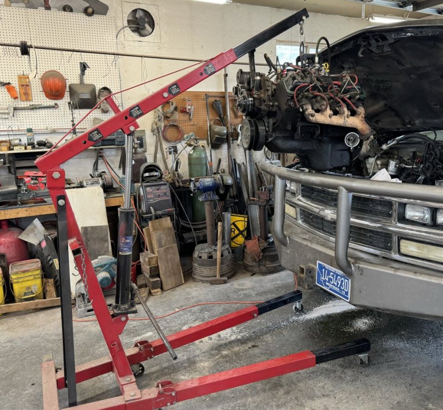

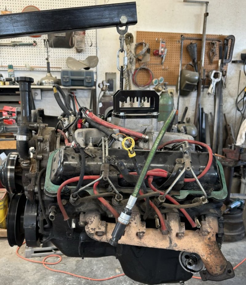

I love that lifting device.
The farthest forward notches was perfect.
Kept the nose in an upward angle throughout the lift.
I’m mighty glad that I unbolted the enjun mount saddles from the frame.
IDK how much weight one of those bolts could carry, not torqued down, just snugged to the plate, I would imagine it would be much greater than the weight of this engine, then, there is six of them.
I doubt that any three of the six would fail during this lifting process.
I would not work under the load though, just to be safe.

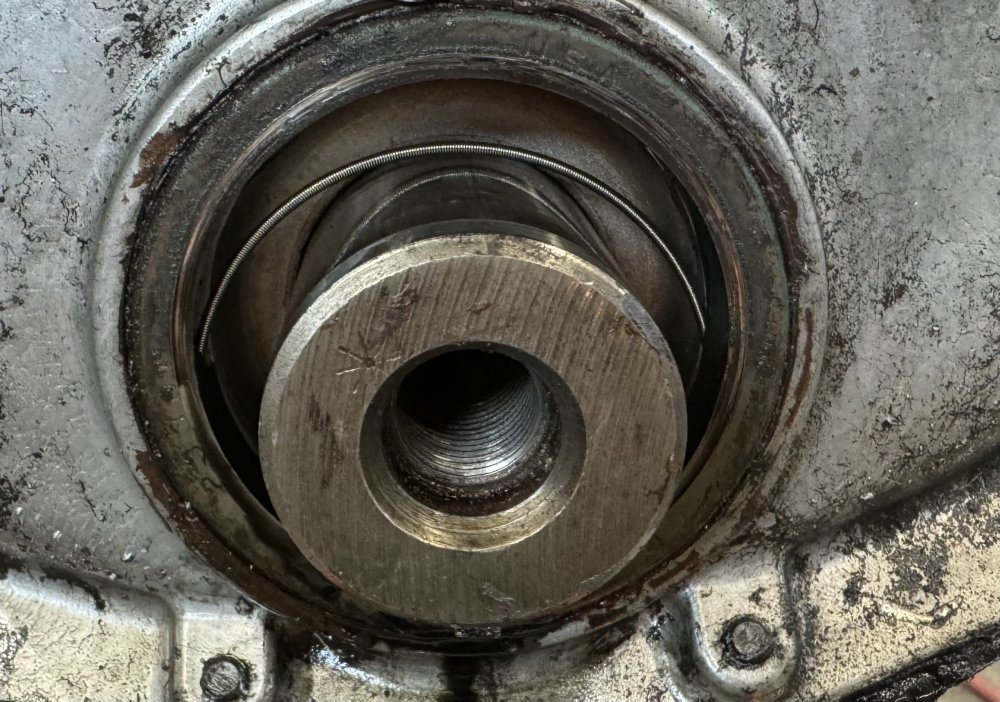

And the majority of the oil leak is revealed.
I always pack the backside of a seal with grease to keep the seal tensioning spring held in place.
IDK what happened here ?
I guess with the engine down in the hole and the radiator in place, aaand, my vision not being so good, I missed this one.
Or could have been my over confidence took over and I didnt even look to see that all was well. I cant imagine me not taking a look and seeing this. 🤷
Any how there it is.

Use only a light application of grease on the lip for installation. Packing it with grease does nothing, as it will wash out with operation.
I don't care for using the intake like that, I don't trust the threads...
Agreed. It wouldn't bother me on a cast iron intake but I'm not yanking on aluminum like that. We actually have a similar plate and debated on it but at the end of the day both the old and new engine were lifted and lowered using the steel hooks attached to the heads from the factory.
No. He is right to pack it full. Keeps the spring in as mentioned-Also add a tiny amount on the lip to lube until oil is flowing. The minor thickening of the oil is no biggie.
If you do NOT have a spring seal- then don’t pack it.

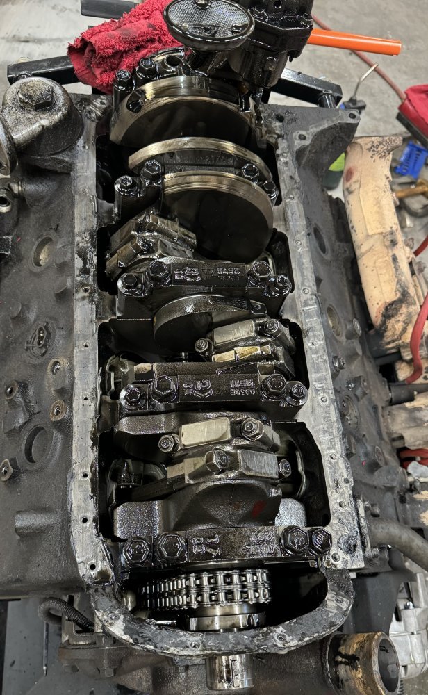

With a wipe down on the three main webs I can clearly see, there is no sign of cracks on the webs.
I am also questioning if this is the original engine to this truck.
Maybe I’ll know more after getting the GPs removed and rotating it through a couple of strokes.

I had dismantled the timing components.
Forgot, then rotated the crank a ways, washed the main web of the new exposed area with B&P cleaner.
There are no visible cracks in the webs that I can access.
Tried rotating the shaft a little farther and it got solid.
WTF
WELL DUHHHHHH. Guess I should not have been in such a hurry to remove the timing cover and components. 😹😹😹
