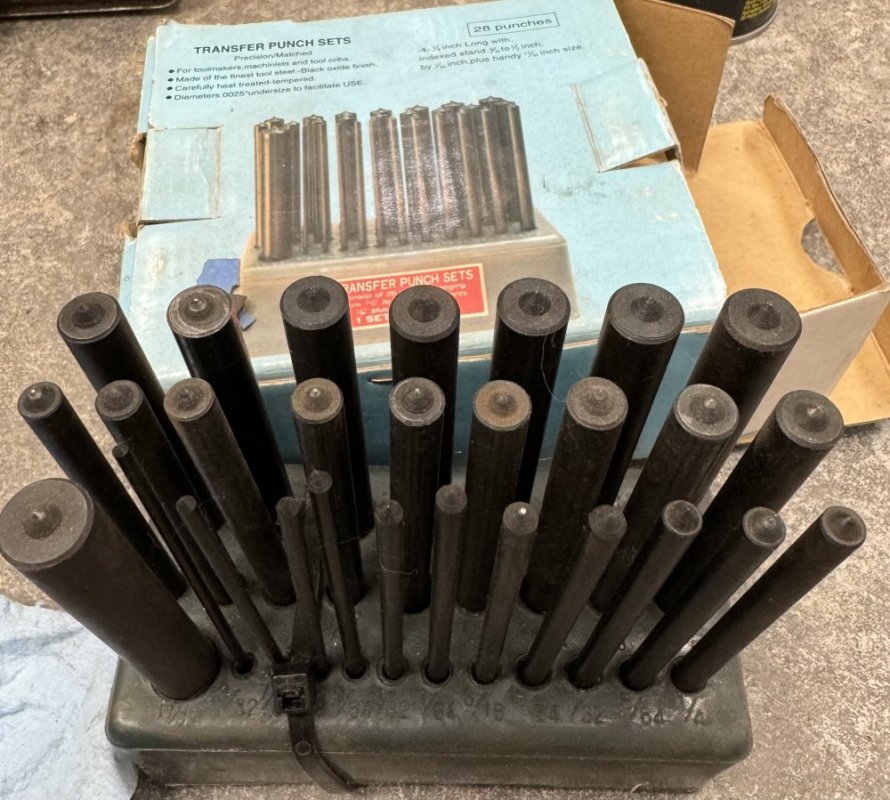

This is a cheap chinesium set of center punches but they have been used many times.
I even have used a bushing around some of them to reach larger diameters.

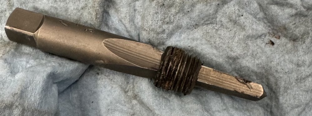

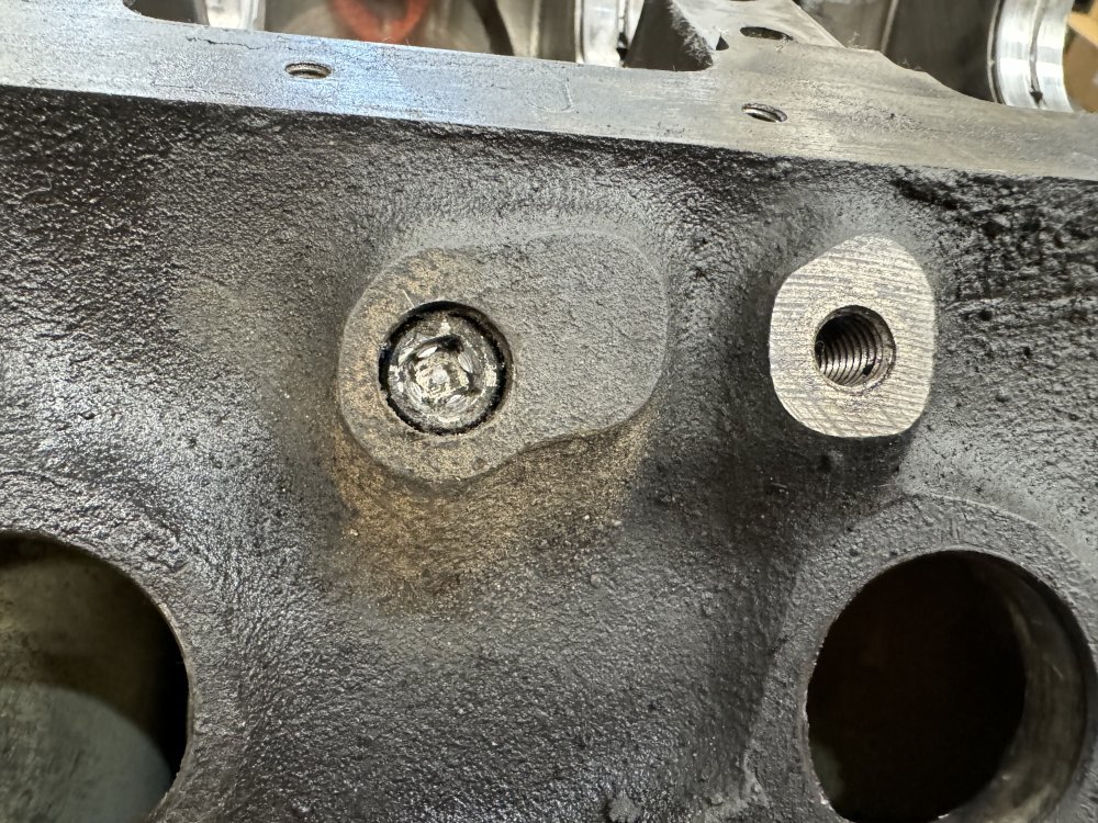

Punched the drain plug
Then heated the block around the plug with the bernzomatic. That didnt work, couldnt get the engine block hot enough so got out the oxy/acetelyne torcher And that warmed it right up.
Still took a lot of pressure on the crescent wrench hooked to the easy out
