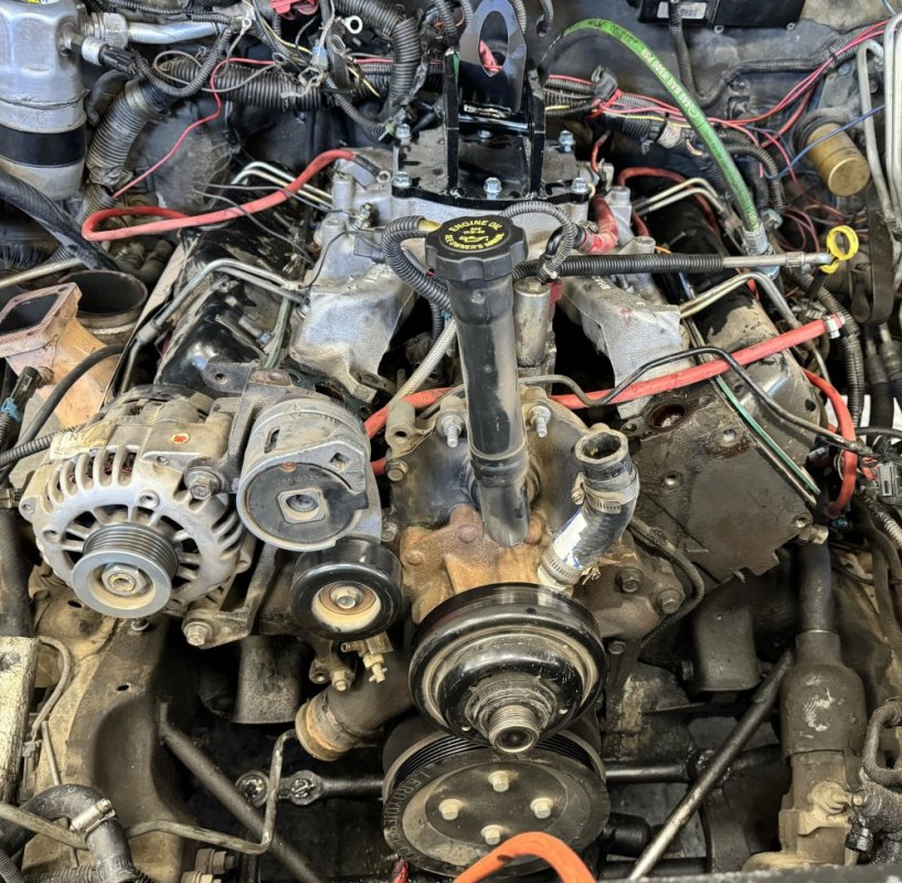

Be carefulStepped out and checked the progress of the draining radiator. The big tin pan i use is about half or more full. I think the radiator is mostly done draining.
I’ll get under tomorrow and pull the block drains then start unboltinguntil itiz hoist time.

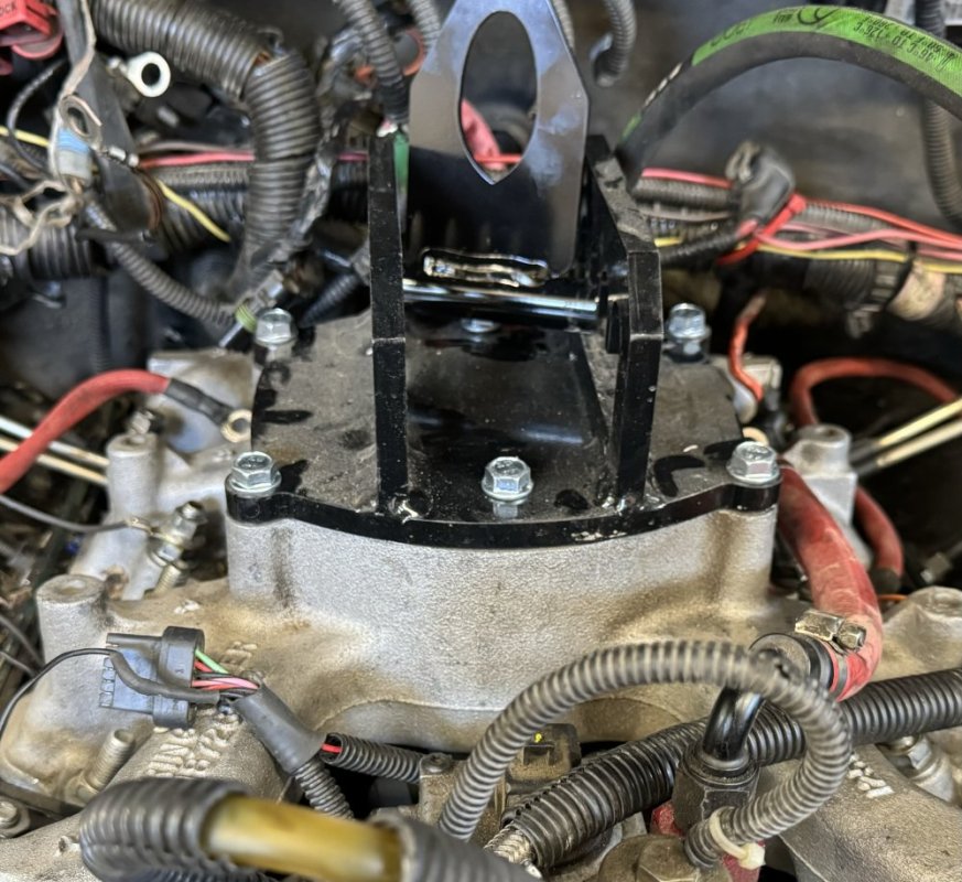

I do have a spare engine stand, I just hope it is heavy enough to handle the load.
I one time overhauled a Ford three cylinder tractor engines, one of them made in England units, might have been Ford Ferguson or some such, on a stand just like this one and it held just fine.
The mounting plate had two spot welds on it to hold it to the receiver. I run a nice bead alla the way around it and its been holding just phine ever since.

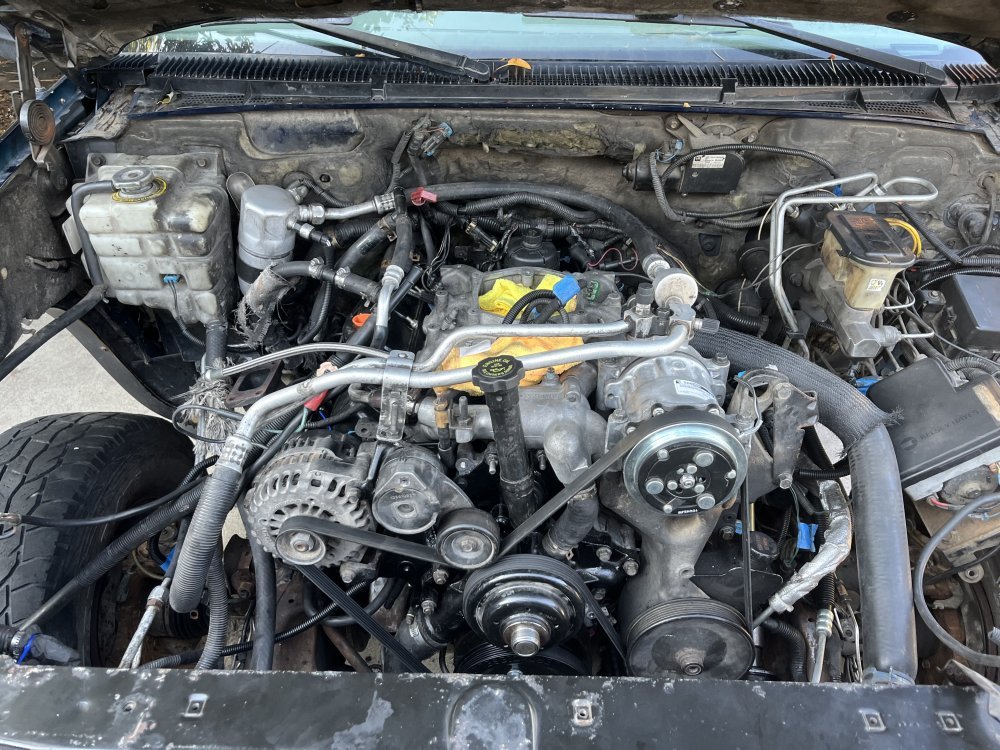

Delays…that’s an understatement. Bolt chasing, fittings, parts sourcing and such. Yesterday’s two joys: M8 bolts provided in a kit where 3/8-16 bolts are correct. “Maybe it’s M10 1.5?”… nope. M10 1.25?… nope again (store runs required each time), 3/8s?…store run by spousal unit…right thread, wrong style. Go back to store….We will light it tomorrow. Continue to face delays due to issues and difference between model years.
I am going to take the old 4L80e from the ‘99 in for rebuild. Once rebuilt, I will swap it back into the ‘99 and use the new proper lines I bought for it. The current 4L80e unit in the ‘99 will go into the ‘94.Delays…that’s an understatement. Bolt chasing, fittings, parts sourcing and such. Yesterday’s two joys: M8 bolts provided in a kit where 3/8-16 bolts are correct. “Maybe it’s M10 1.5?”… nope. M10 1.25?… nope again (store runs required each time), 3/8s?…store run by spousal unit…right thread, wrong style. Go back to store….
Transmission lines are for 97 and newer. This is a 99 burb but, trans isn’t…lines were too large in dia. for these fittings and incorrect for this model but, work for the spare one he has.
