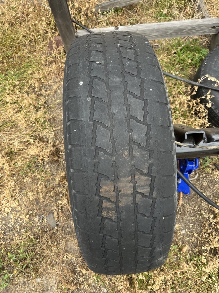

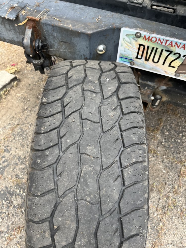

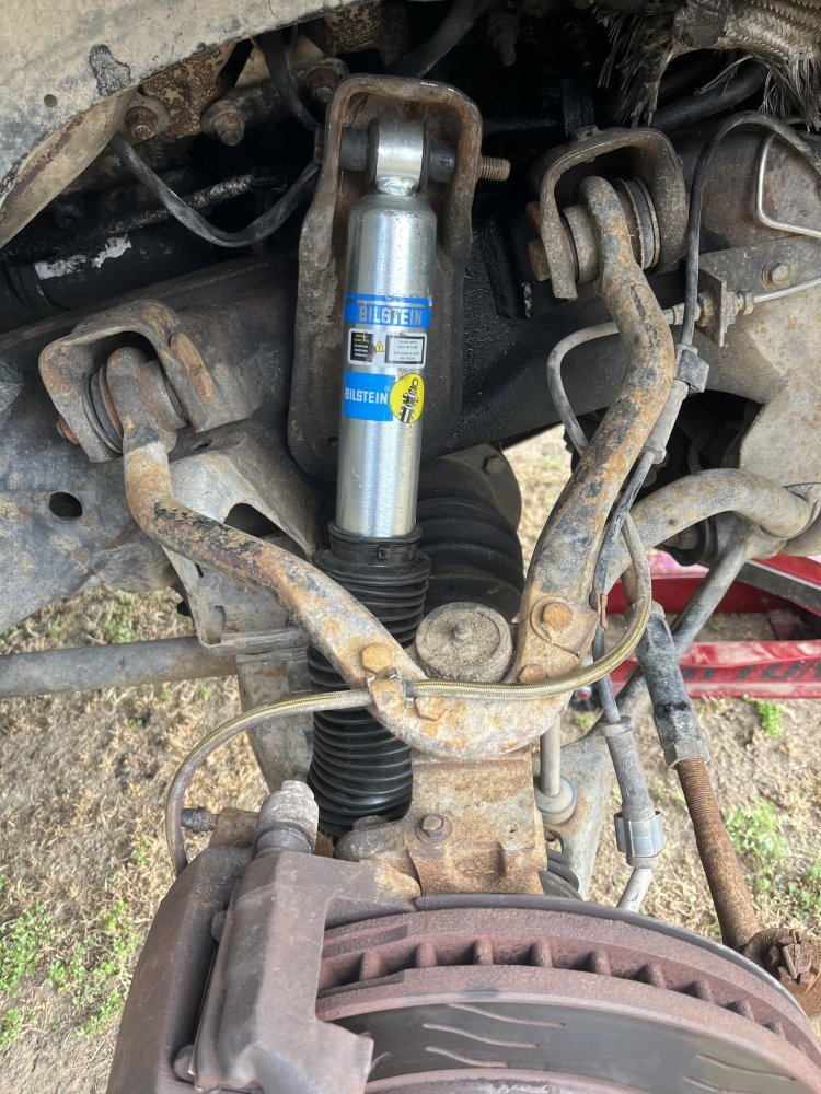

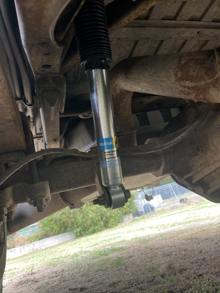

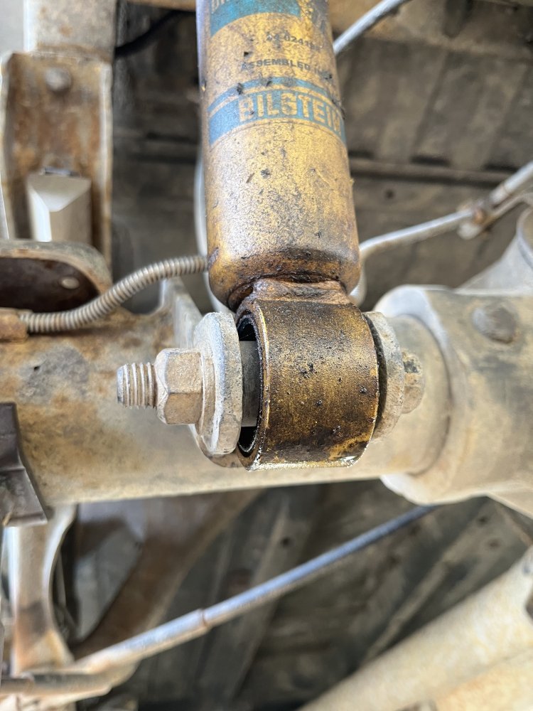

I replaced the rear tires on the ‘99, with the old ones going on steel wheels for the trailer up at Big Bear Lake home. While under the truck I noted the left rear shock (Bilstein 4600) was leaking, so I ordered a new set of Bilstein 5100s.

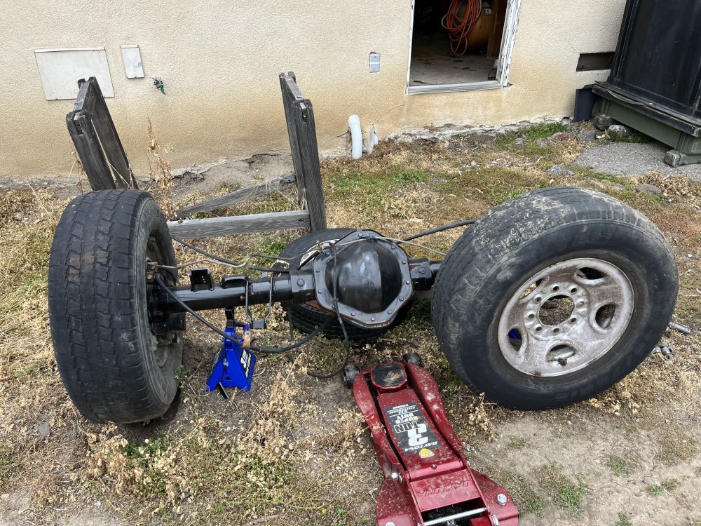

And yes the GMT 800 axle will soon get to the top of the to do list. Wife’s medical procedures are completely disrupting my schedule for things like painting the Suburbans.

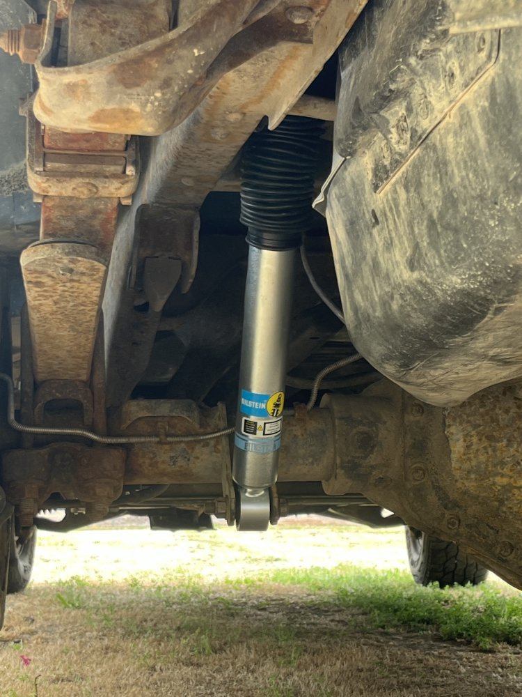

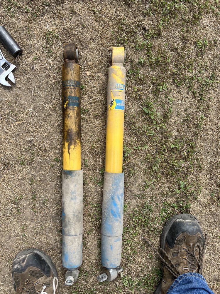

IMG_3231.jpegIMG_3230.jpegIMG_3232.jpegIMG_3229.jpegHad a leak on the left rear shock, which was a Bilstein 4600. Not a lot of miles on them, guessing 40K, probably about 10 years. Installed Bilstein 5100s today. Like the ride so far.
@Big T Don't the 4600's have a lifetime warranty?
Defects caused by one or more of the following circumstances are excluded from this limited warranty:
• Normal wear and tear – The gradual loss of performance over the lifetime of the shock, including dust boots and mounting hardware, such as rubber bushings, ball joints, heims;
Mine would clearly fall under this. Aside from the one that is leaking, the rest have lost performance.

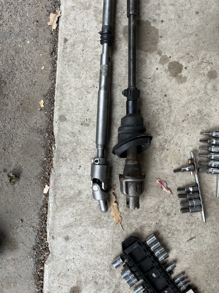

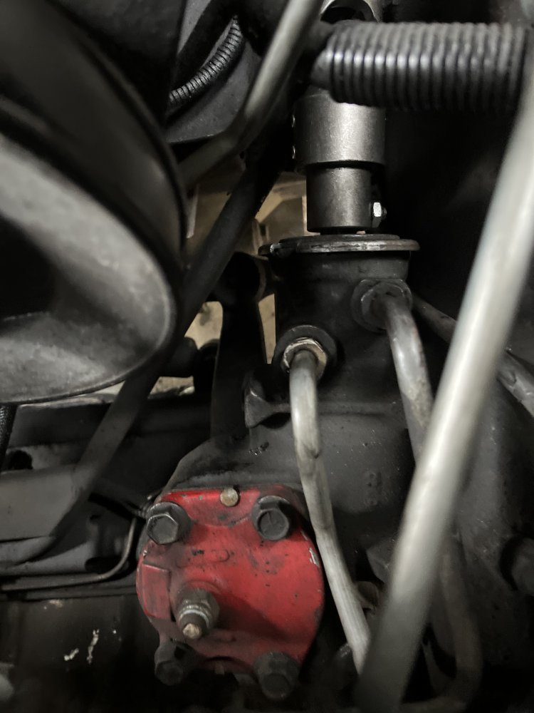

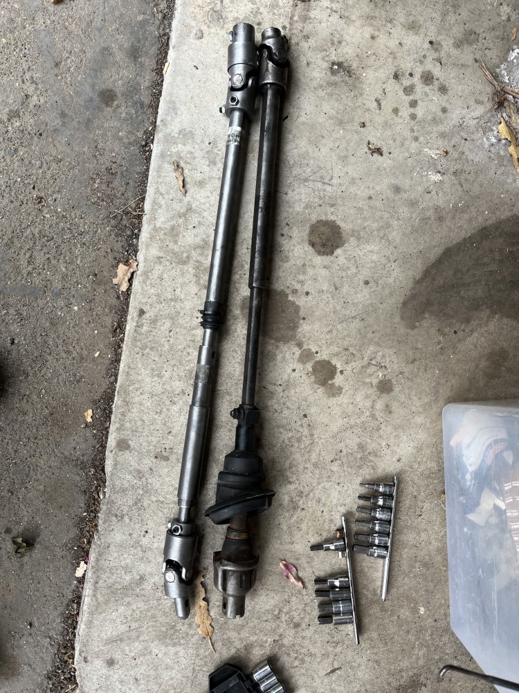

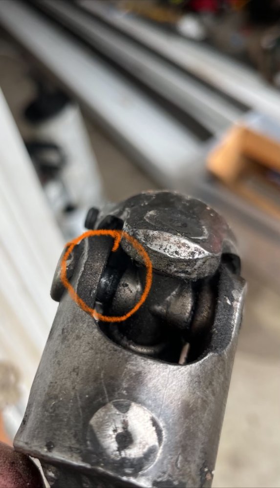

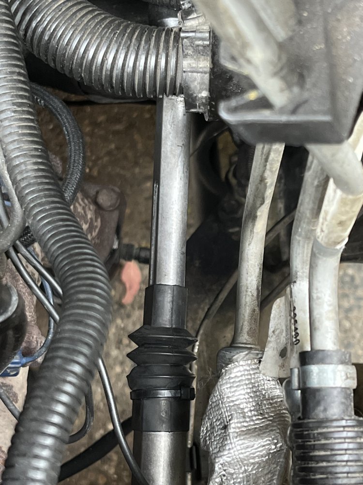

Replaced the lower steering shaft with a Borgeson unit. On the old shaft a needle bearing on the spider joint had disintegrated. They sent me the incorrect upper shaft for a 1999-2007 Silverado. It has a male end that goes into the steering column, whereas the OEM is a female end.
The steering wheel is clocked a bit more to the right after the install. Remind me, the pin on the end of the input shaft to the steering box only allows the steering shaft to go on one way? Or can I adjust it a notch to the left? I had tried to put it on a notch to the left, but it would not go on until I moved it one notch to the right.
The play in the steering is back to where it was. Obviously the worn steering shaft was contributing a lot to the play I was experiencing in the steering wheel.

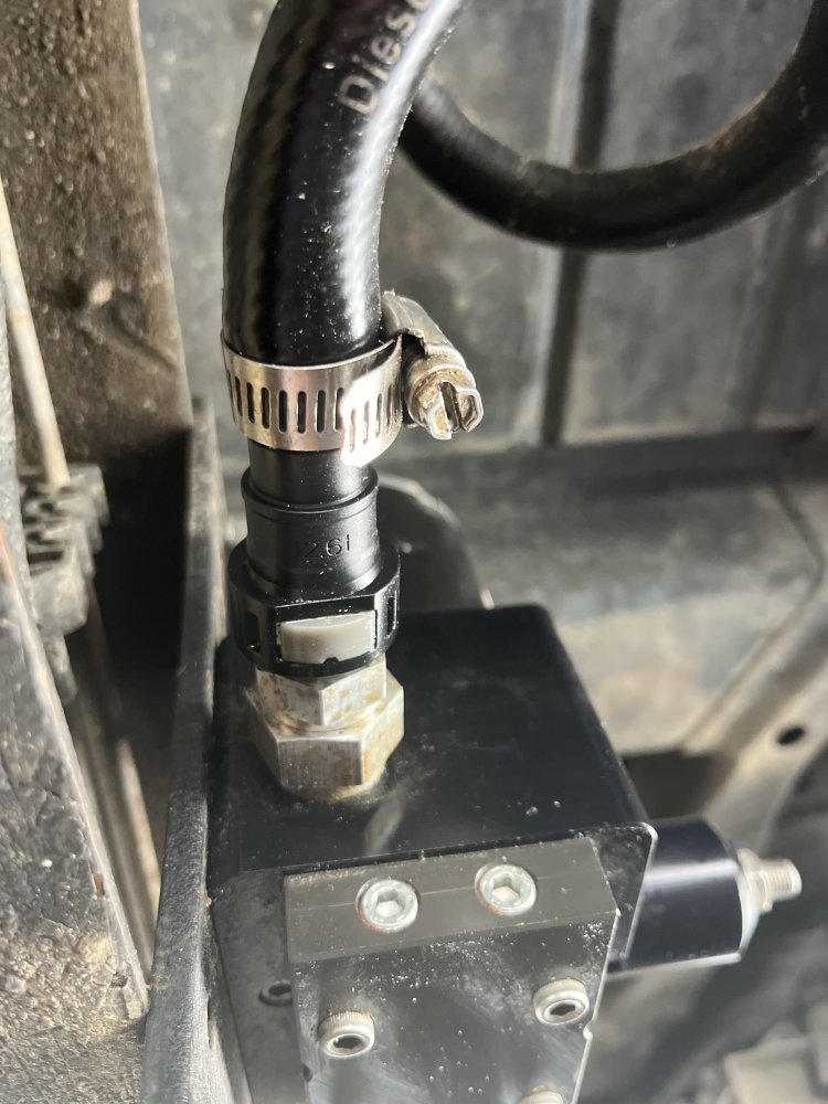

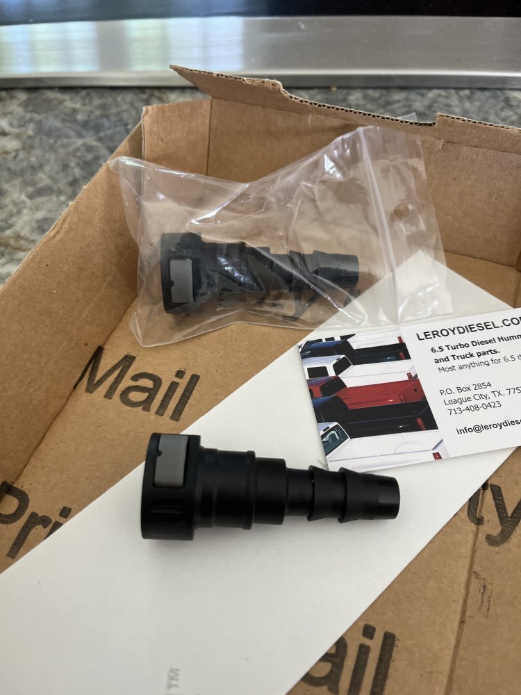

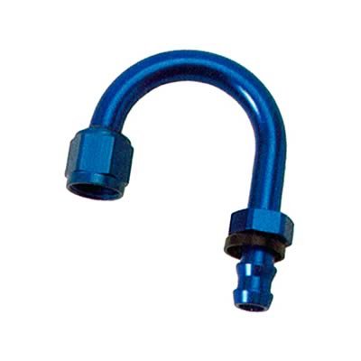

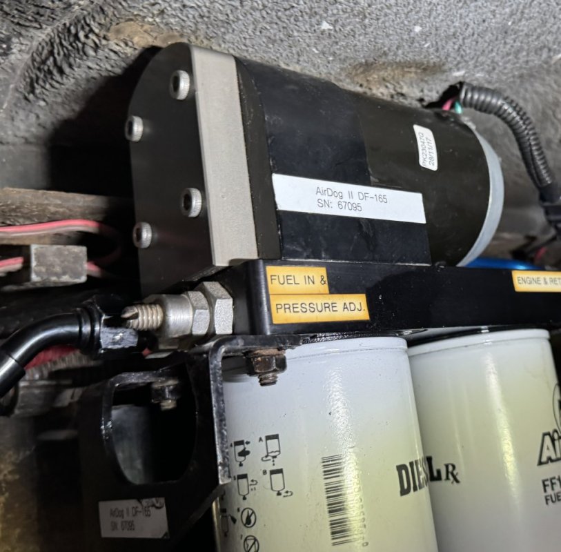

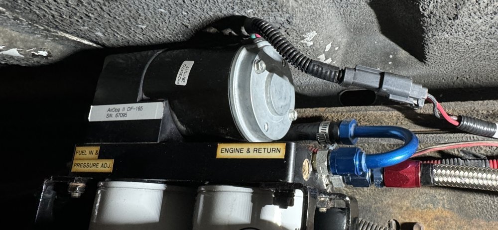

New fuel fittings for the Raptor lift pump arrived. Replaced the leaking one on the inlet side and new one is not leaking. Close inspection of the old one and it clearly was not leaking from the hose. There is an o-ring inside the fitting, but it was not compromised. Only thing I can think of was the fuel line had it on at a slight angle. Technically, I don’t need the hose clamp, but the old one was initially leaking there and the clamp stopped it. I cut the hose off the old fitting and pushed new section of hose onto the new fitting.
View attachment 87725View attachment 87726

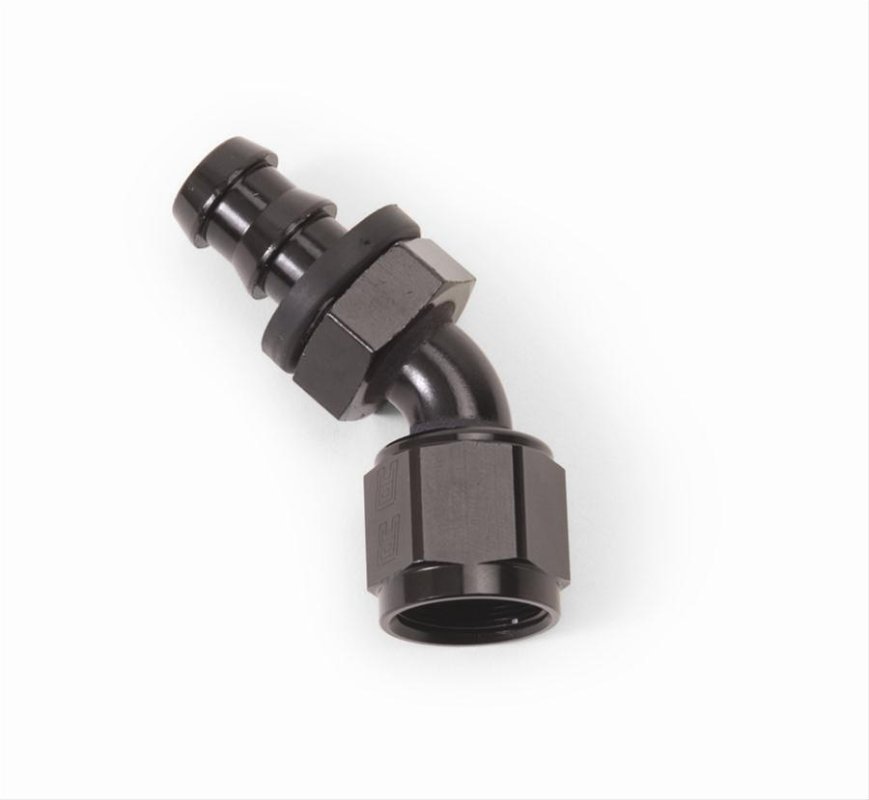

Why not just regular hose barbs ?
You tell me. This is what FASS and Air Dog are using on their lift pumps. I’d prefer a regular hose Barb. Paveltolz says he’s using AN-6 fittings on his Air Dog, though I have yet to see pictures.
I'd complain and cuss them to tears
I'd also leave terrible reviews.
That seems to strike a nerve. Might get something changed before I buy one
