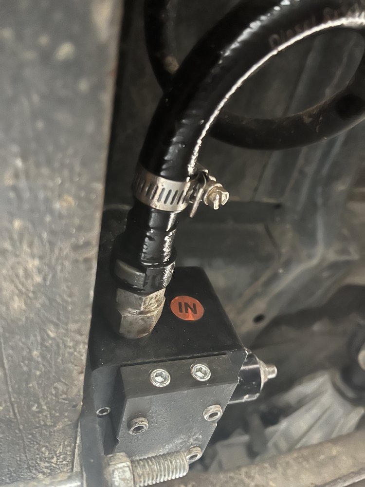

Thanks guys.I appreciate the reply.They snap in place nicely but I did read online they sometimes allow air leaks as well.I’ll just toss em in the toolbox.This is how my current setup looks without the fittings in place.

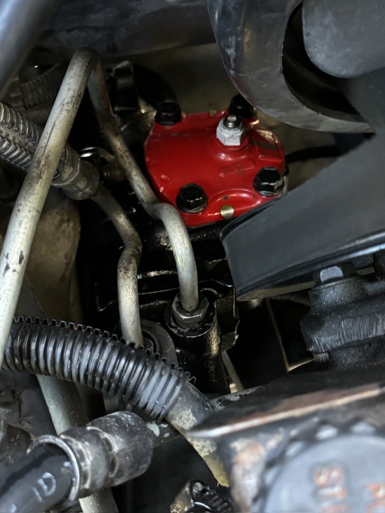

Here’s a pic of my recent leak on an Air Dog Raptor lift pump with the push on fittings. First leak was at the hose, probably to removing and reinstalling the hose twice. That was cured by a hose clamp. The leak here was from the fitting itself. Look closely and you can see that I had to loop the hose from the pre-filter to the pump. That creates some side pressure on the push on fitting and the internal o-ring seal, which probably resulted in the leak. Got new replacement fitting and that is working so far. When I did the replacement, I cut back the hose to fresh, unstretched hose.
