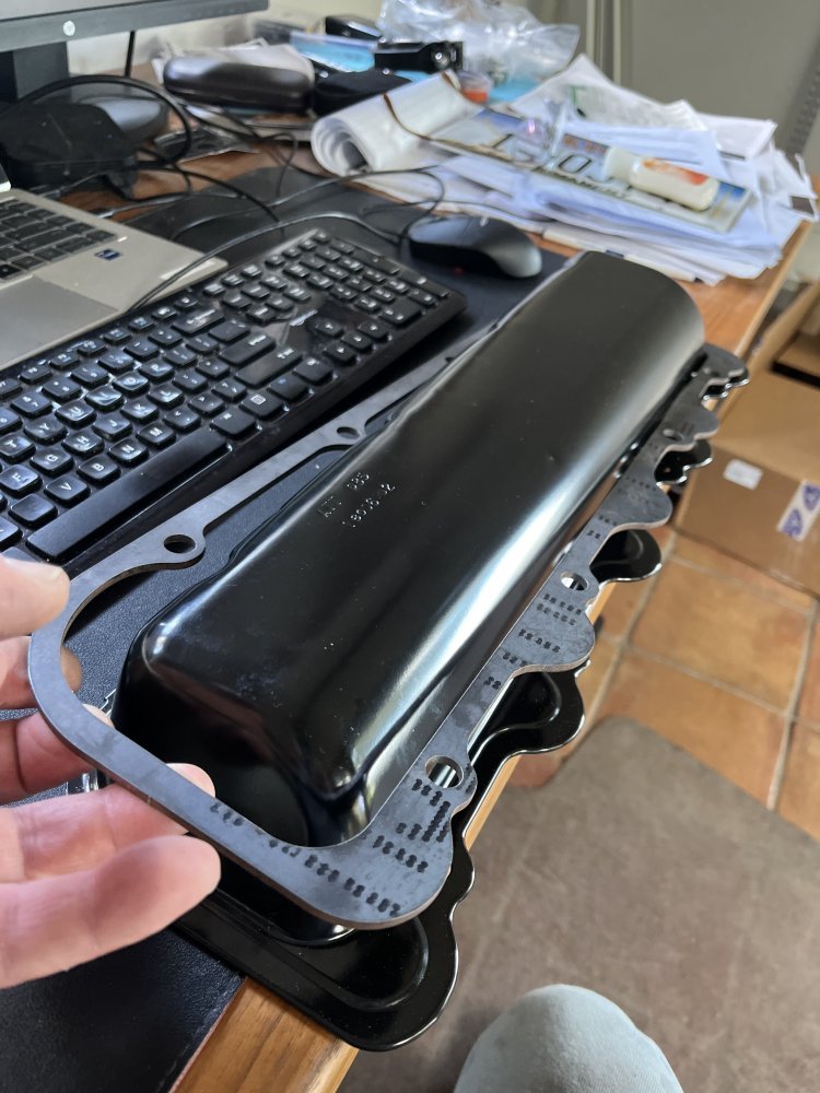

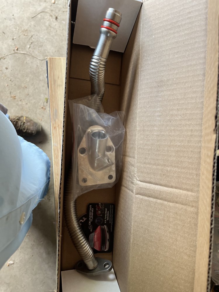

That drain tube set up looks like a quality piece of kit.
As long as the mating surfaces on the turbo and block are free of old RTV and gasket material, one should have a dry passenger side motor.
I’ve learned by sad experience that if you don’t, especially the turbo side…you don’t.
Looking forward to seeing the results.
Looking at the piece that mounts on the block, there is what looks like a smaller plug. I wonder if that can be used to add a drain for something like the provent.
That is precisely what it is intended for. Get the Pro Vent check valve and you’re good to go. It’s 1/4 NPT. So 1/4 npt to 6AN male fittings and then 6AN to 3/8 hose barb should do it.

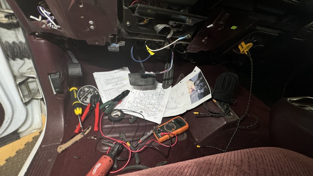

Finished wiring up the brake controller. Biggest hurdle was where and how to tie into the Brake Light wire since the You Tube video’s truck wasn’t quite like mine. Ended up splicing in at the main harness for the turnsignal and all under the steering column. Tight quarters.

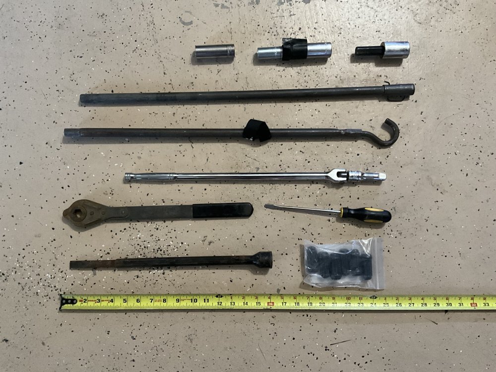

Then the best project of them all. Trying to figure out how to save some room under the back seat for the tire changing kit and make it more accessible over the OEM set up.

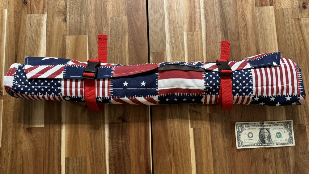

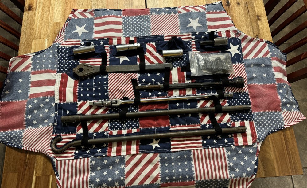

This is what my wife came up with for me, the 6.5 and Father’s Day all in one. ($1 is for scale).
“Lovingly Made in the USA by Maggie W”
No more rattles, lifting the rear seat to unbolt the ‘too big for what it does’ factory storage unit. Easy to pack around etc.
Pockets for OEM and Aftermarket Lug Sockets, Lug Security Socket and 5/8 Allen to speed up lowering/raising the tire. Bigger Pocket for spare lug nuts in case of an ‘O Fudge’ moment. All the tools have their respective outline for ease of replacement when I start to lose my memory…more of my memory TBH.
Sometimes, you just have to go to the spousal unit for project solutions.
The Jack is on its own tucked out of the way in a corner. Poor Jack,

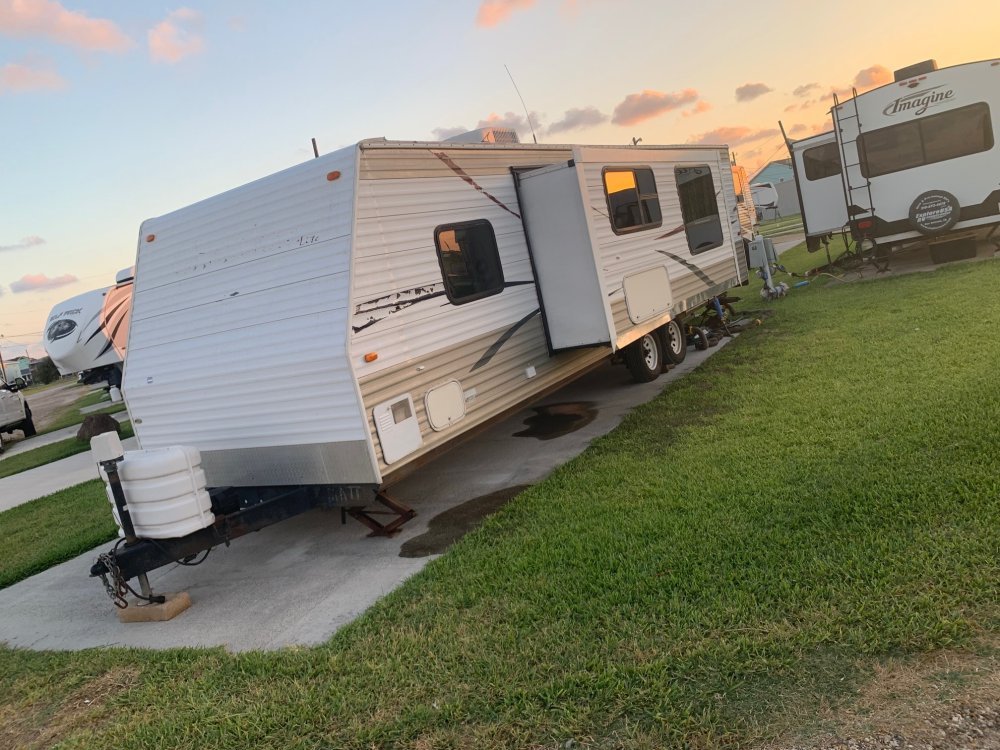

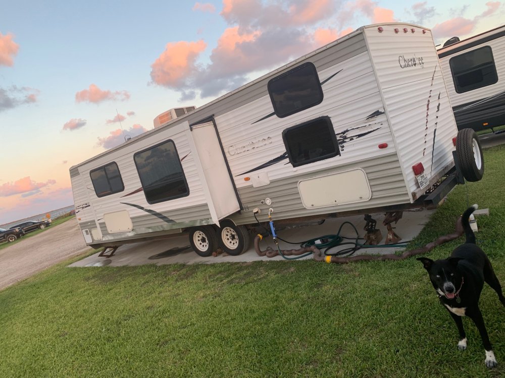

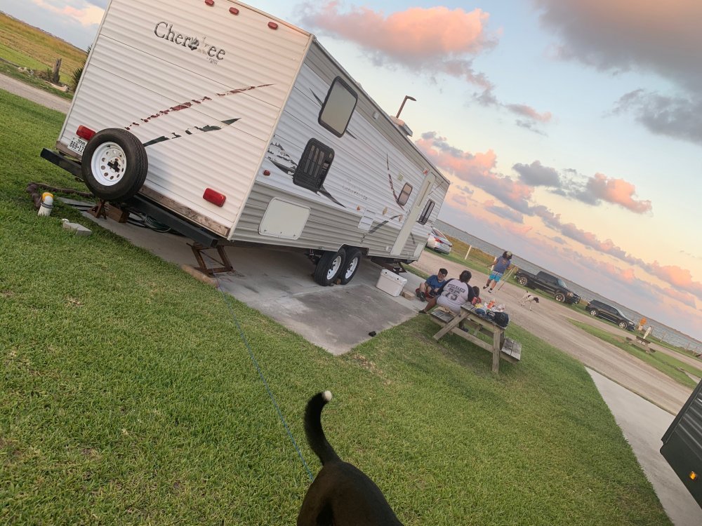

I didn't take pics of the truck connected, but here is the trailer at the campsite in Rockport TX. BTW this is the trailer we got for free!! still needs some work, but is functioning :)
Not bad for first time pulling anything this big this kind of distance and being first time RV'ers LOL
