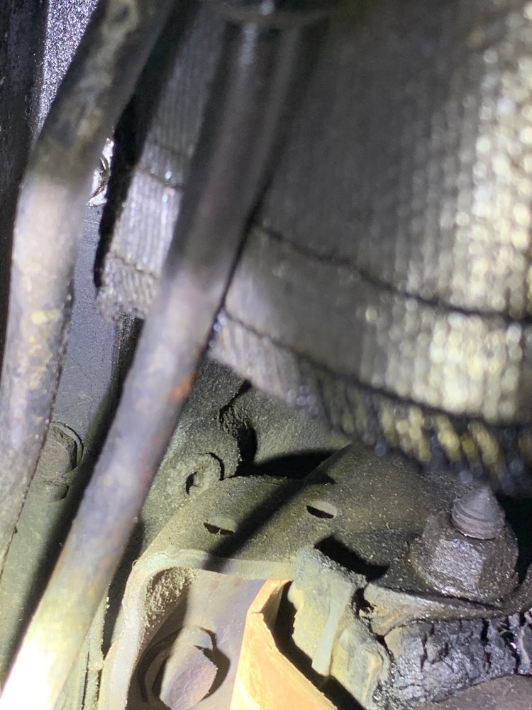

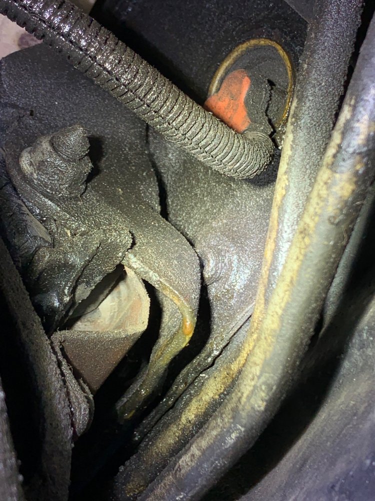

I will see if I can put it up on ramps tonight and get under there. iirc I found where a flat area was right behind where the motor mount is on the block on both sides. I looked at the 6.2 block I have and there are plugs in that same spot on it.
@Will L. Your pics as requested!
I stand corrected. me being blind in one eye and cant see from the other... I found the block drain plugs! they are 1/4" ntp plus with a square inverted hole. Note their location and the blank boss I had thought was where they should have been. the motor mounts would have to be removed from the block in order to remove them! Nope not going there unless I have no other choice LOL
also take note of the condition of the rubber mounts as they were replaced not that long ago.. anchor brand I got off RA.
