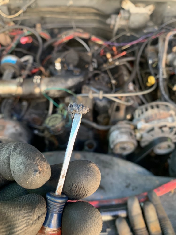

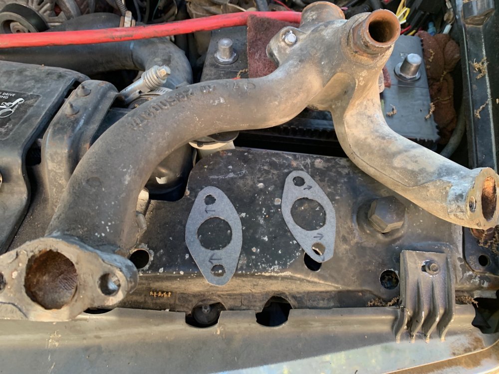

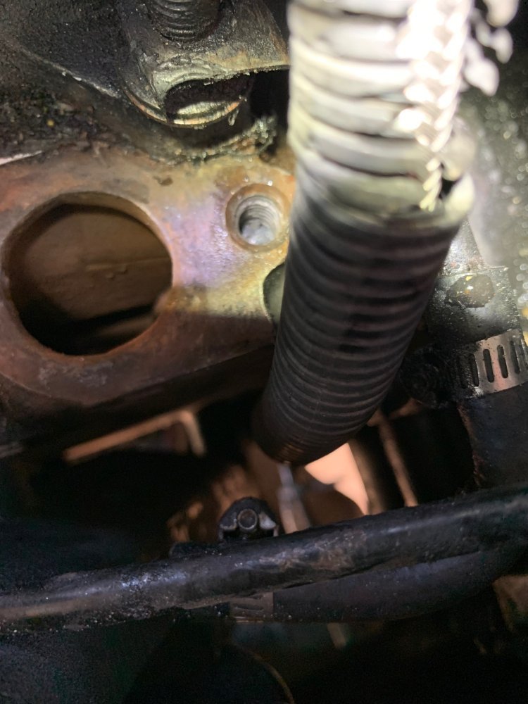

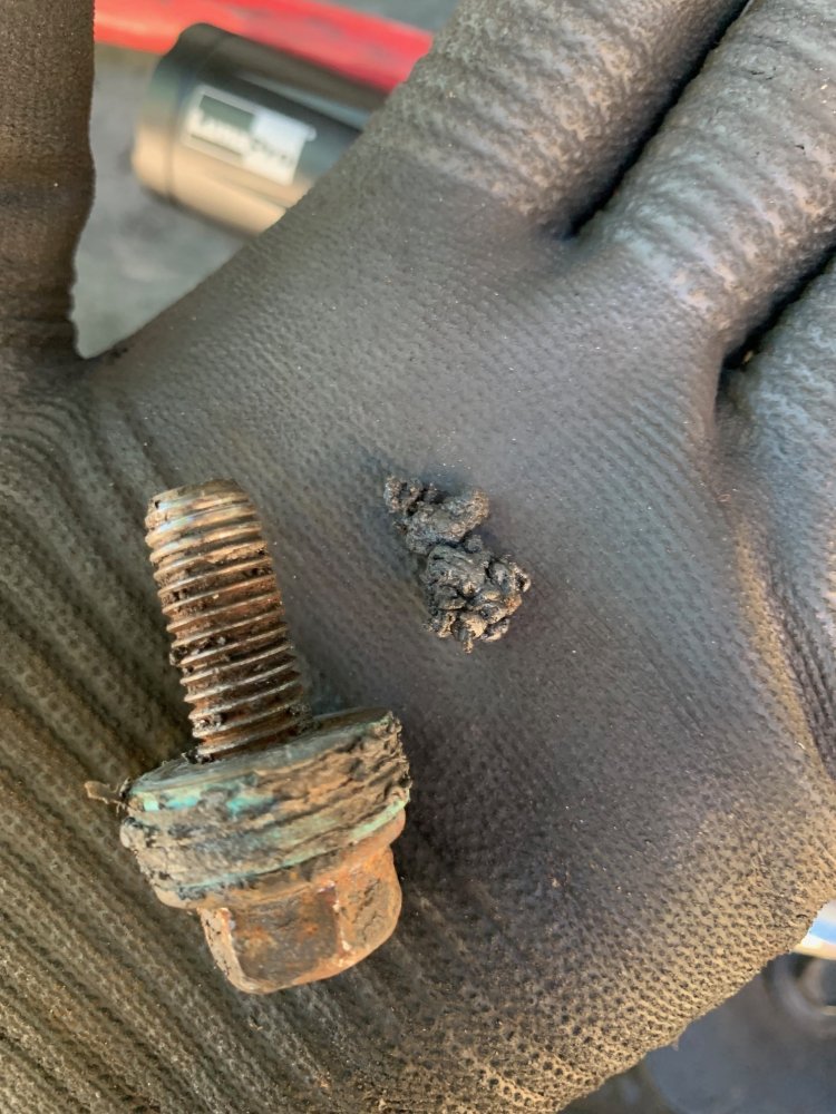

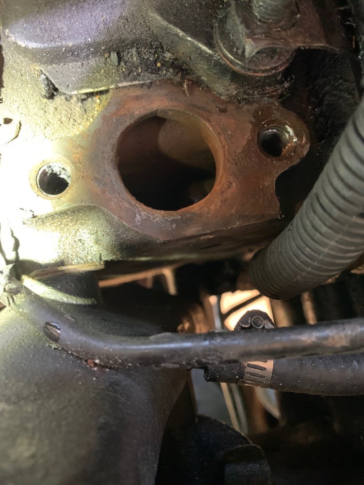

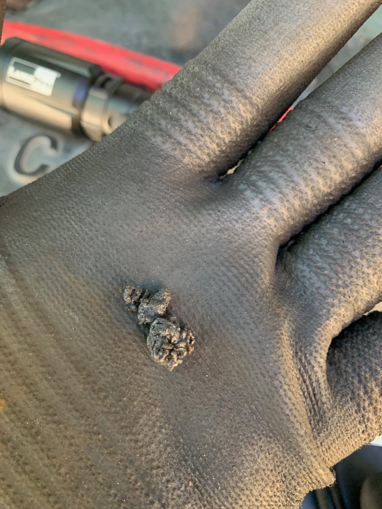

This afternoon I got time to finally fix the leaking crossover. Pulled it off and first thing I did was check the bolt holes in the heads. Come to find out all four holes were half full of old "the right stuff" sealant. I spent a good amount of time with a pocket screwdriver and a small pic getting ti all out. test fitted the bolts into the holes and they were able to tighten down without the need of the washers.
How much of this sealant does one have to use to get the bolt holes half full of sealant?? I also made two gaskets from some material I had since after cleaning the surface of the head and seeing it slightly pitted. buttoned it all back together, filled with water and seems to not leak anymore!
I still need to do a complete flush, but I wanted to get this truck running before I do anything else.
Here are some photos of the aftermath from what I found causing the leak.
