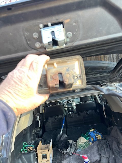

Replaced the lift gate latch and actuator assembly on the 2014 SR5 which has 350K miles. Latch assembly was rusted and getting stiff, then the actuator itself finally went out. Replaced it with a Chinese Knock Off by Himiki for $52 off Amazon. Guys are asking $120 for used, rusted OEM units on eBay, but why buy someone else’s problem. Once installed, the Himiki unit works just fine. Pretty straightforward job.
