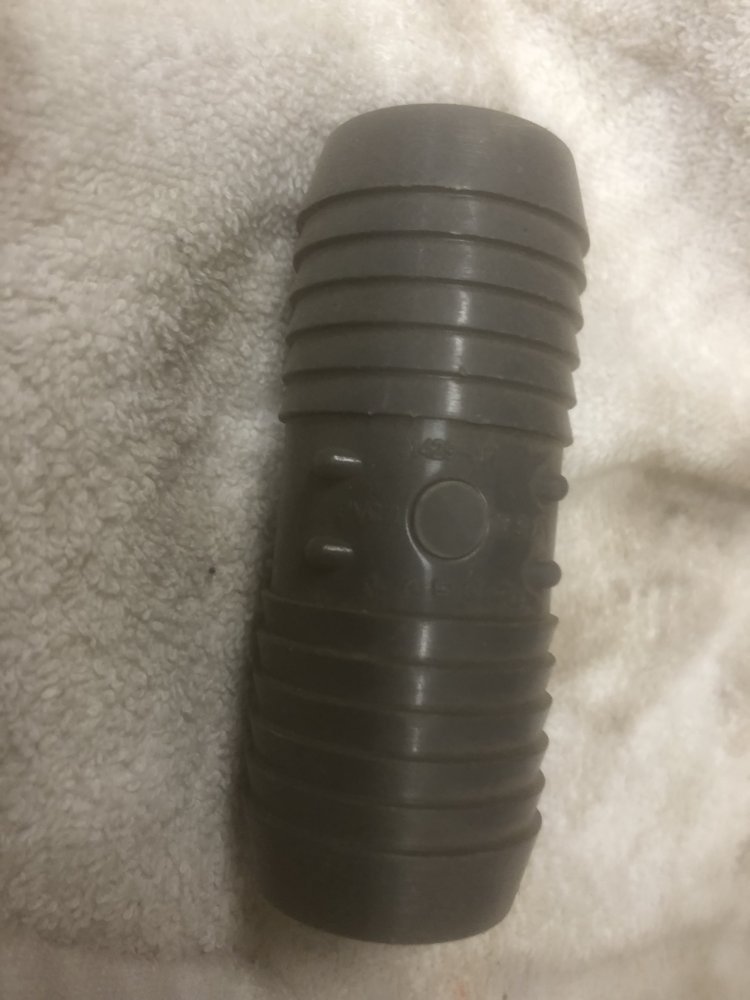

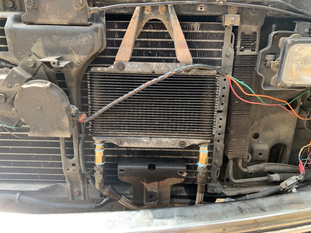

Well as a temporary repair I swapped out the oil cooler for the shorter one. I ended up reaming out the inside of one of 3/8" npt fittings to two drill bit sizes below 1/2" since the two I had were different. now they are the same size inside diameter. cleaned it out from any burrs and cleaned out the cooler though it was already clean, I wanted to make sure. ran the truck till it was up to normal temp and the oil at the cooler was at 162 degrees making sure there were no leaks. oil pressure started out cold at about 60 psi and slowly decreased down to about 30 as it has been doing normally, so don't see any pressure loss there. This will work for now until I order another cooler.

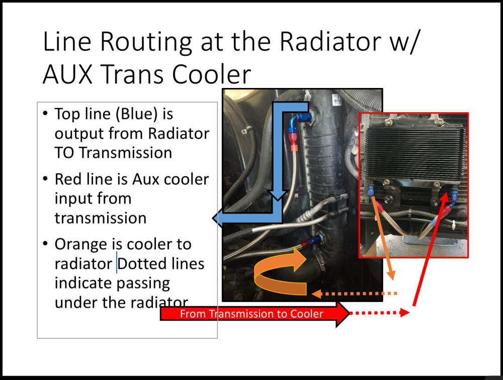

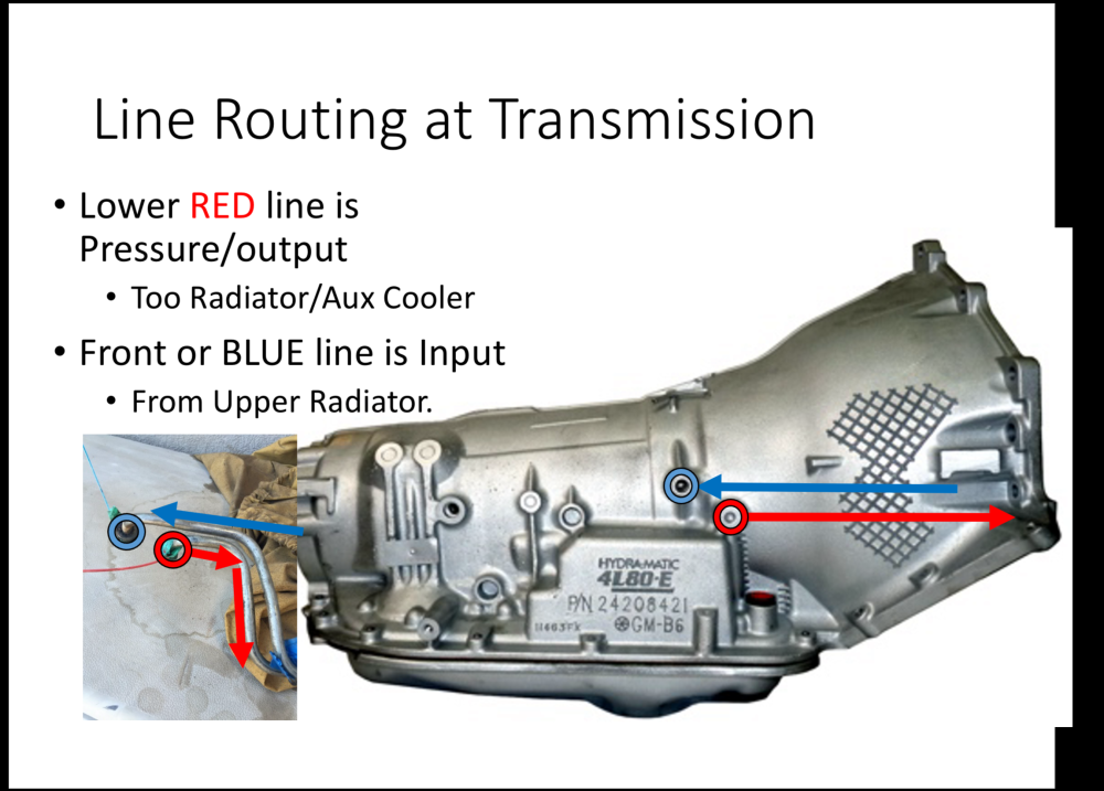

This truck does not have a trans cooler external to the radiator, only the internal one. I was thinking and wondering if I should install one or not.
