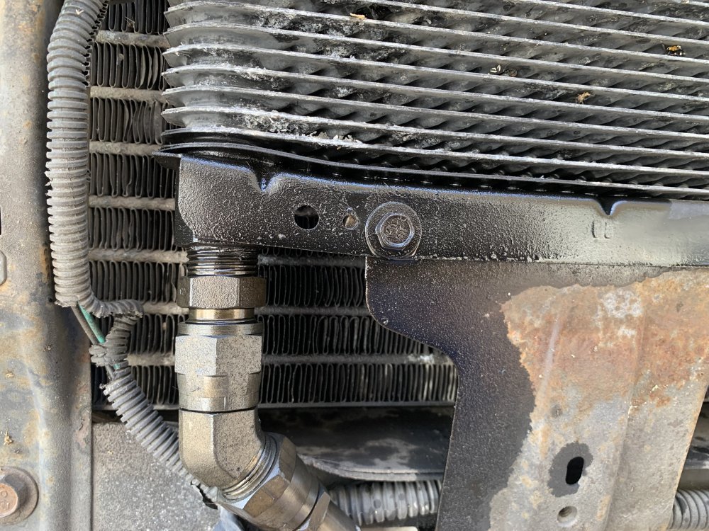

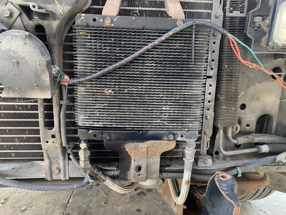

Welp…. Houston I may have a problem…. I scored me a front bumper today and while I was installing the center brackets I discovered this oil leak!!
That sucks. Had that issue last fall. Couldn’t find a direct replacement. Contact Leroy once you confirm fitting sizes (1/2” or 5/16”) and, if you’ve got the correct sized fittings, order just the cooler from him.
It looks like a factory cooler but it has Leroy's hoses so I'm not sure. I have another cooler but the fittings are some sort of orb o-ring type. not sure if I can get adapters for it.
The fittings in this one look to be 1/2" pipe to #8 jic or an fittings
I just did my cooler, one of my lines blew a hole. Made a nice mess all over my driveway.
I did not replace the cooler. But I did replace everything else.
My fittings were one size smaller including the hose.
I kept my old cooler, plan on doing the fan one under the cab.

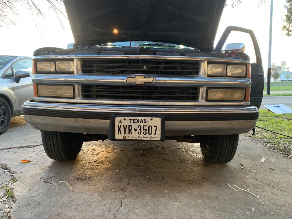

I Got the bumper installed finally. had to do some slight tweaking with the floor jack to get it all lined up. it's not perfect but it's much better than it was without any bumper. Oh yeah and I forgot to post a pic of the newly installed stereo.

On the fitting for the OE cooler, I did manage to find that it's a special fitting. 18mmx1.5 male o-ring, but that size normally uses a 10mm diameter tube (same as a power steering hose) making it too small for the cooler. the tube where the o-ring sits is about 1/2" or 13mm diameter. I was also watching one of Leroy's youtube videos where he showed how to id the coolers vs his cooler. the spare cooler I have is in fact an OE one (has marks on the hex of the fittings) the one on the 93 truck is one of his coolers which is pipe thread.
as a temporary repair, I also found a shorter cooler (looks like a trans cooler) which has 1/4 npt thread. I might be able to run to the hardware store and get a couple of male 1/4 npt to female 1/2" npt or 1/2" flare (not sure what Leroy's hoses have on them) and cobble in that shorter cooler until I can source a replacement cooler with npt fittings or find a set of adapters with the correct size o-ring ends.
If I cobble in that shorter cooler with 1/4npt threads, will there be any issues with flow?
I would NOT do anything that reduces size of fitting for flow. You can go up in size then back down to original size. Going from 1/2” down to 1/4” is a huge restriction in flow. I would rather no oil cooler than that.

I was mistaken on the shorter cooler i have. the fittings are 3/8" npt not 1/4" I guess me looking at it in the dark isn't a good idea LOL. I wouldn't think going from 1/2" to 3/8" would be that much of an issue at least for a temporary fix.
That's like a 33% reduction in flow.
Very true. I just returned from the hardware store with some fittings. measured the ID of the brass 3/8" male coupling, it's a 1/16" from having a 1/2" ID. I can't say what the cooler flow is, but it's structure looks identical to the factory oil cooler other than being a little shorter.
