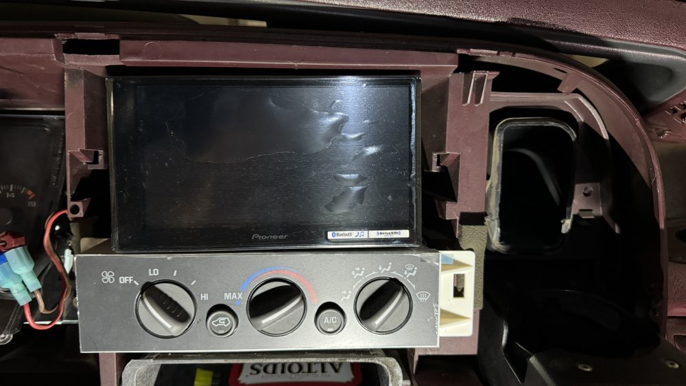

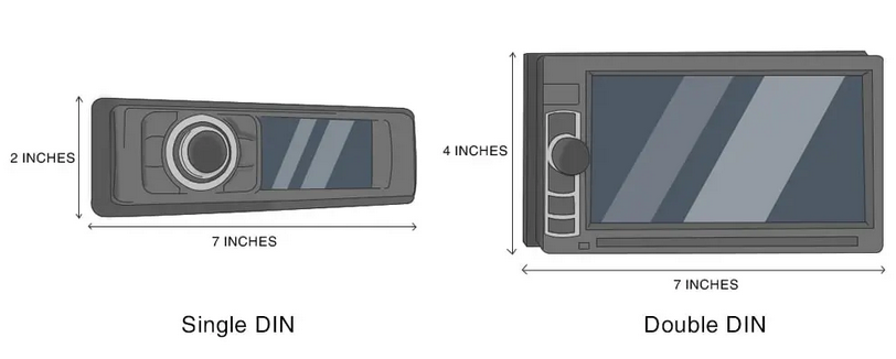

I don't even know what a double din radio is.What have yall guys done on the 94- trucks in mounting a double din radio in the dash? I was looking at this and realized a large portion of the dash has to be cut out. I'm not liking that idea. I just acquired a really nice Pioneer stereo with all the bells and whistles

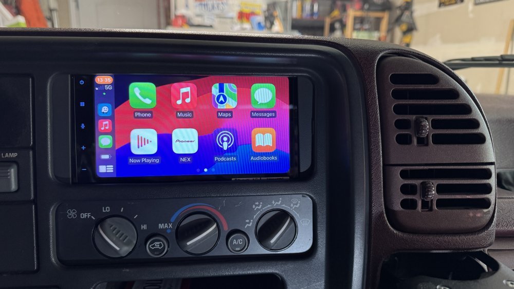

That looks like the same unit I just bought. Pioneer DMH-160BT. I have an older Kenwood unit in the 95. it's got awesome sound but drives me nuts trying to reconnect the bluetooth if I walk too far away with my phone when it's on. I can't complain since I only paid $50 for it on the marketplace.1996+ are double Din. Put this one in the truck in December and had a similar one in the 99 Burb.

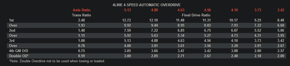

What axle ratios are You running on that ?That looks like the same unit I just bought. Pioneer DMH-160BT. I have an older Kenwood unit in the 95. it's got awesome sound but drives me nuts trying to reconnect the bluetooth if I walk too far away with my phone when it's on. I can't complain since I only paid $50 for it on the marketplace.
I just returned a little while ago from picking up the used tires for the 93. Paid $140 for a set of 245/75/16 Toyo A31 open country tires all 4 with a date code of 5120 - 51st week of 2020. not too bad of a score. it's the factory size for the 93. I have the 265/75/16's from my 95 on it now and the RPM's are a tad on the low end when on the freeway. it has a scooch of a hard time increasing speed from 60 to 65 going up hill with the OD unit on. I looked at the TCI display while on the road and it was reading 1800 and almost 70 MPH. I figure going from 265's to 245's should put it back into it's power band or at least slightly closer. but I do have to say even with the engine wore out with all the blowby and loosing oil like it does, it cruises the freeway like a dream! smooth and quiet!!
Oh my thats nice.it's running 4.10's but with the gear vendors OD unit it makes it slightly lower than 3.73's
Looked it up.It has a lockout if wired up to a 4x4 it's supposed to disable it when in 4x4. this one is only a 2x4 so that part isn't needed. I need to look up on the online calculators and see what it says my RPM's should be with that size tire
