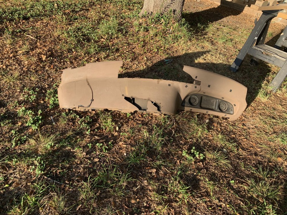

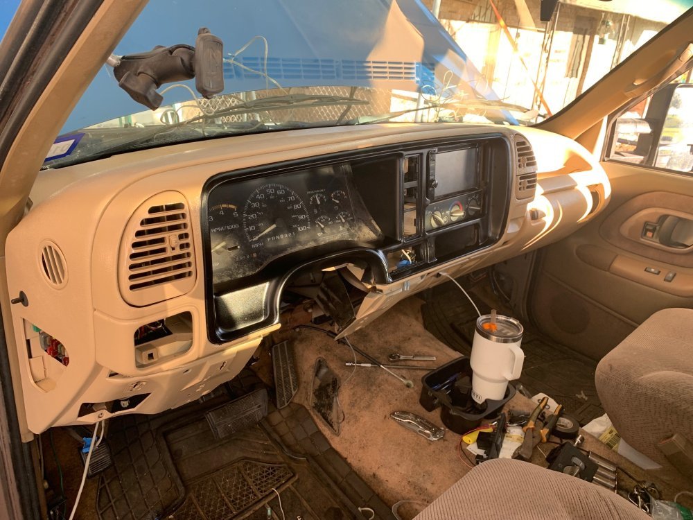

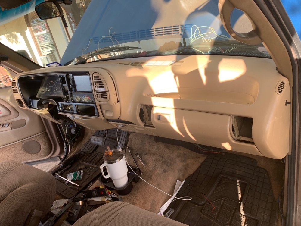

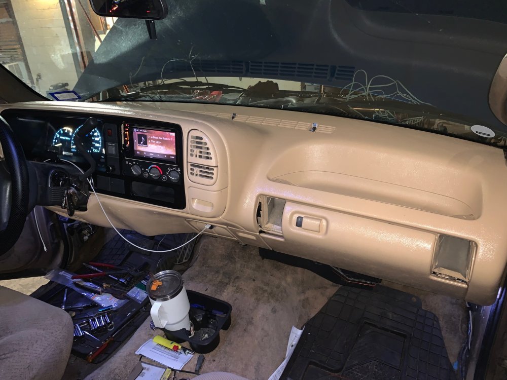

Just got done painting all the odds and ends. I ended up pulling my front cowling that houses the drives dash vents and covers the ac controls, radio and gauge cluster and cleaning and painting it. I had already trimmed it up to fit my stereo (double din) so I don't have to cut up the one for this new dash. I'm not sure what I want to do down the road for a stereo and if I end up finding something to better fit a 1.5 din space, I will still have a un-molested cowling.

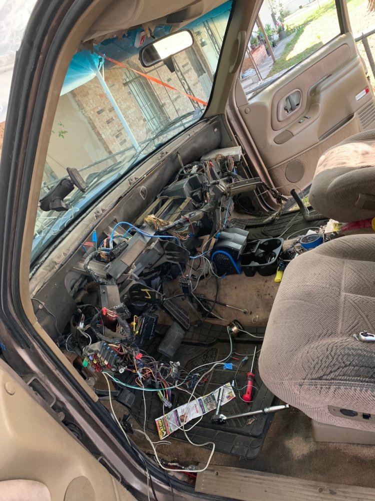

Well, here's some photos of today's adventure. I will admit, it got a little messy there for a bit, but she's coming together nicely. I did use a tad too light of a beige color, but it's better than having a blue dash LOL. Now I am just waiting for the Amazon delivery van, I ordered a mic for my stereo so I can actually use my hands free talking. once that arrives, I will get the bezel installed and the steering column. I still have the dash vents drying.
That's awesome work. The first picture with everything laying out like a gutted cow is the stuff of my nightmares. You're hired.

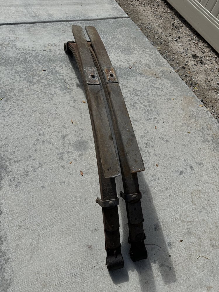

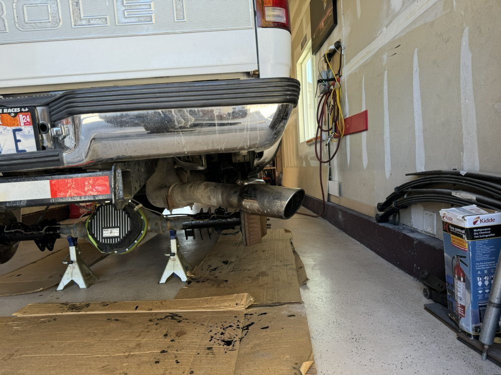

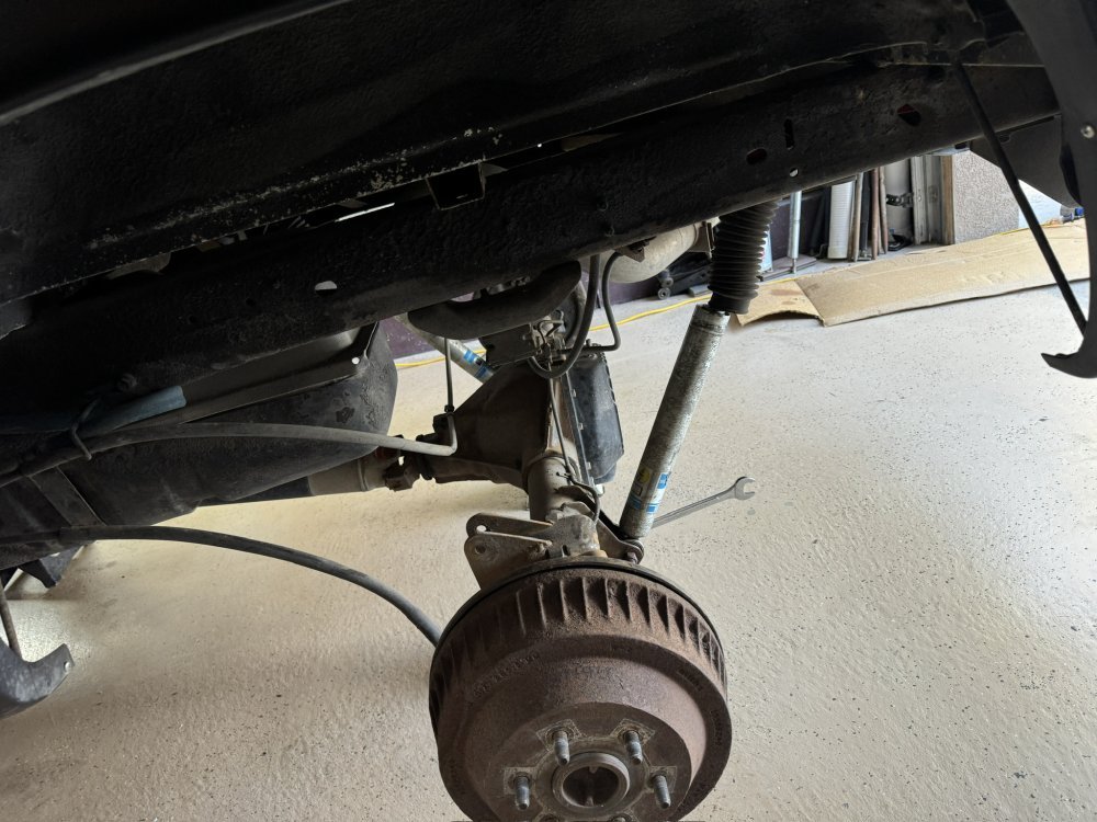

Got the last leaf spring out. Passenger side fought all the way. Had to cut out the forward bolt. Rust/welded to the bushing. Scraped, degreased and steam cleaned all the rusted areas back there on the frame and diff. so I can apply POR 15 and top coat on Monday.

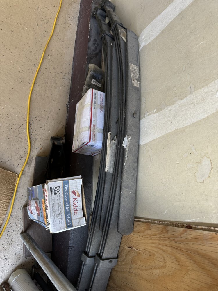

Old 4" lift BDS units. Free. Come and get 'em cause I'm not shipping . You'll need a new front bushing. It spins but, the bolt is not budging...what's left of it anyway.
"New" units and hardware (box) on the garage floor... waiting there for a few years for me to get up the courage.

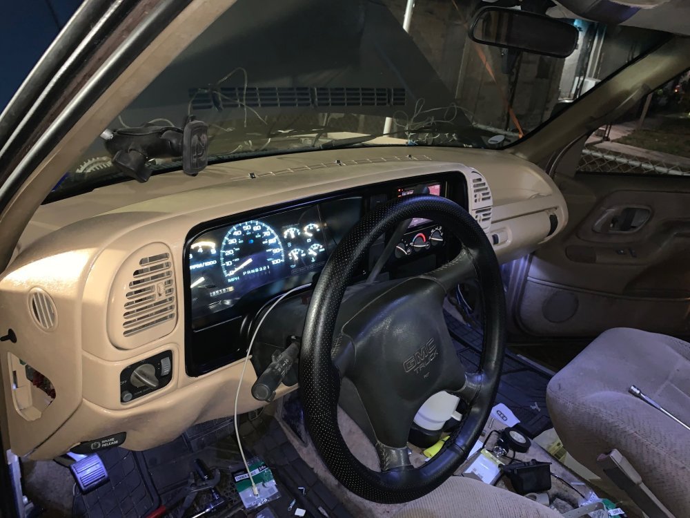

Here is the almost finished product. I still have the passenger side dash top cup older the get installed along with the passenger dash vents. got it together enough to venture out in town for some dinner!

Well, I went on a trip into town to the grocery store today. the sun was out and I found out real quick like about my mistake for using gloss paint on the new dash! reflections into the windshield! LOL as soon as the paint is cured well enough I will be putting the carpet dash pad back over the dash! I will give it about a week to cure.

went into town tonight for some dinner from yard bird central (Chicken Express). I was amazed at how much quieter the cab noises were. I guess that old dash had a lot of rattles in it. I also noticed that my WTS light is not working anymore. at first I thought I must have blown the glow plug fuse during the process, but I soon realized at the drive though window when I turned on the key I could hear my lift pump working for a few seconds and stops, telling me the glow plugs are working and the bulb in the cluster is out.
I will add that to the list of to do's. to pull the cluster back out and replace the bulb.

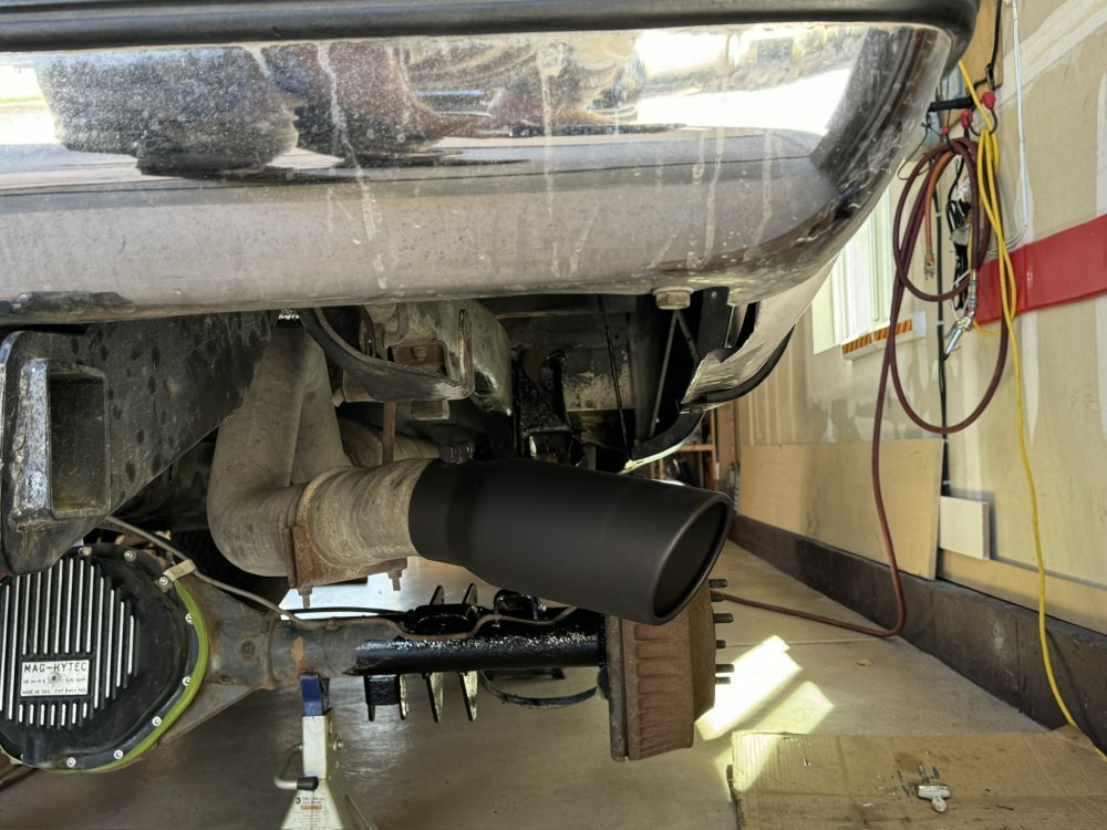

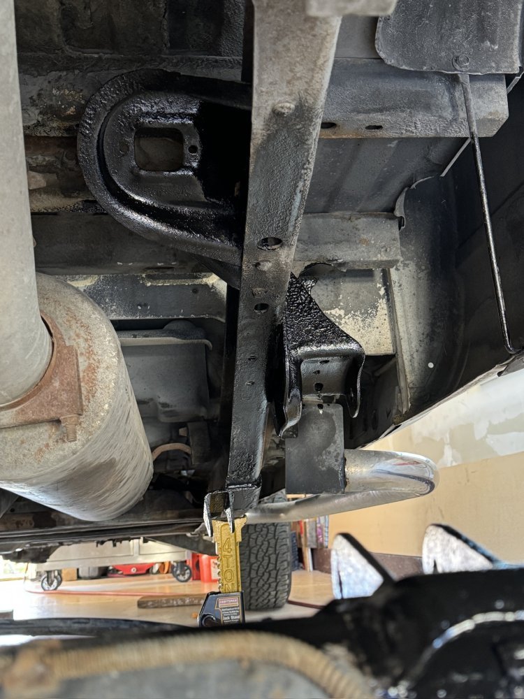

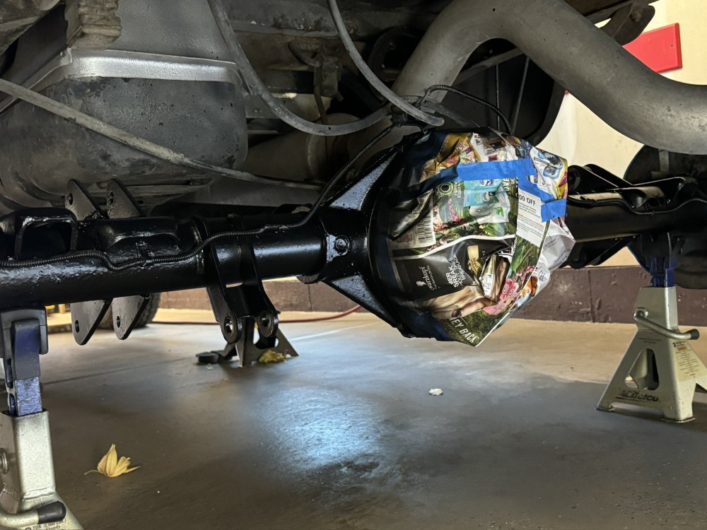

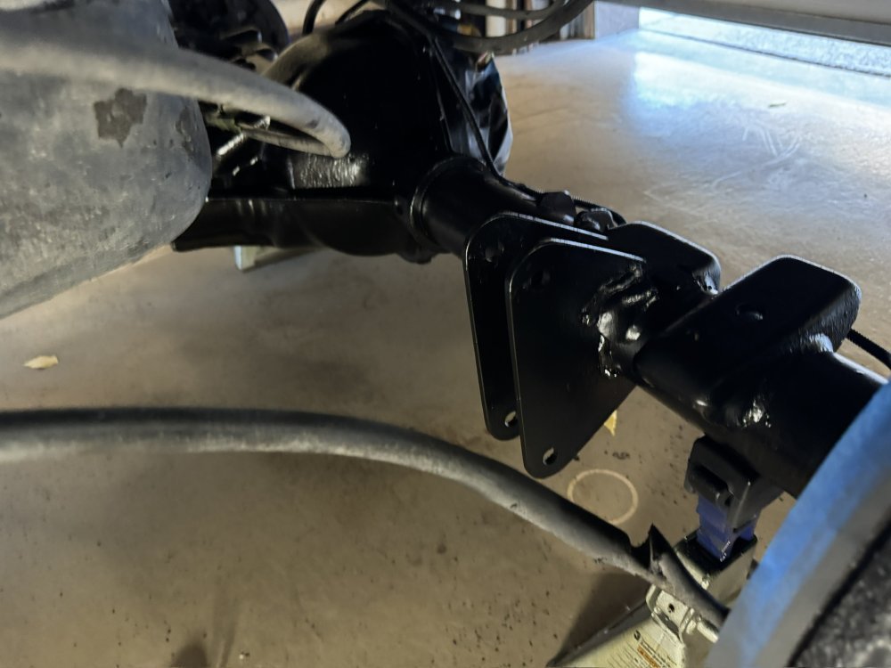

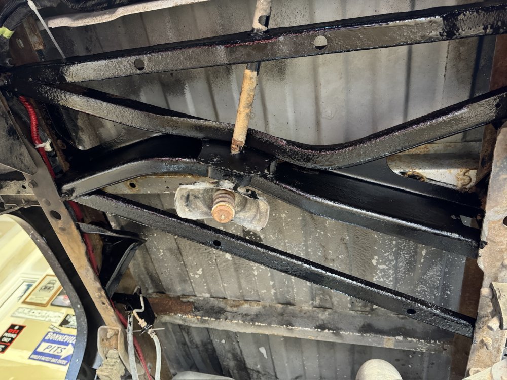

Finished the rust treatment on the rest of the differential. Top coats of paint on everything (sub-frame for tire hoist and braces, shock mount points, leaf spring mounts and ladder bar attachment points).
Never did care for the way I put the Chrome exhaust tip on many years ago. Looked like it stuck out too far so, cut it off and replaced it between coats of POR-15.
I would have ventured to do more but, got distracted...again.

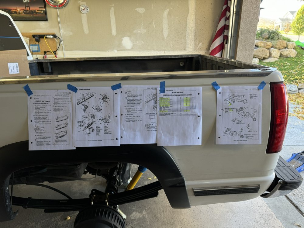

Tomorrow, the Leaf Springs and Shocks go in.

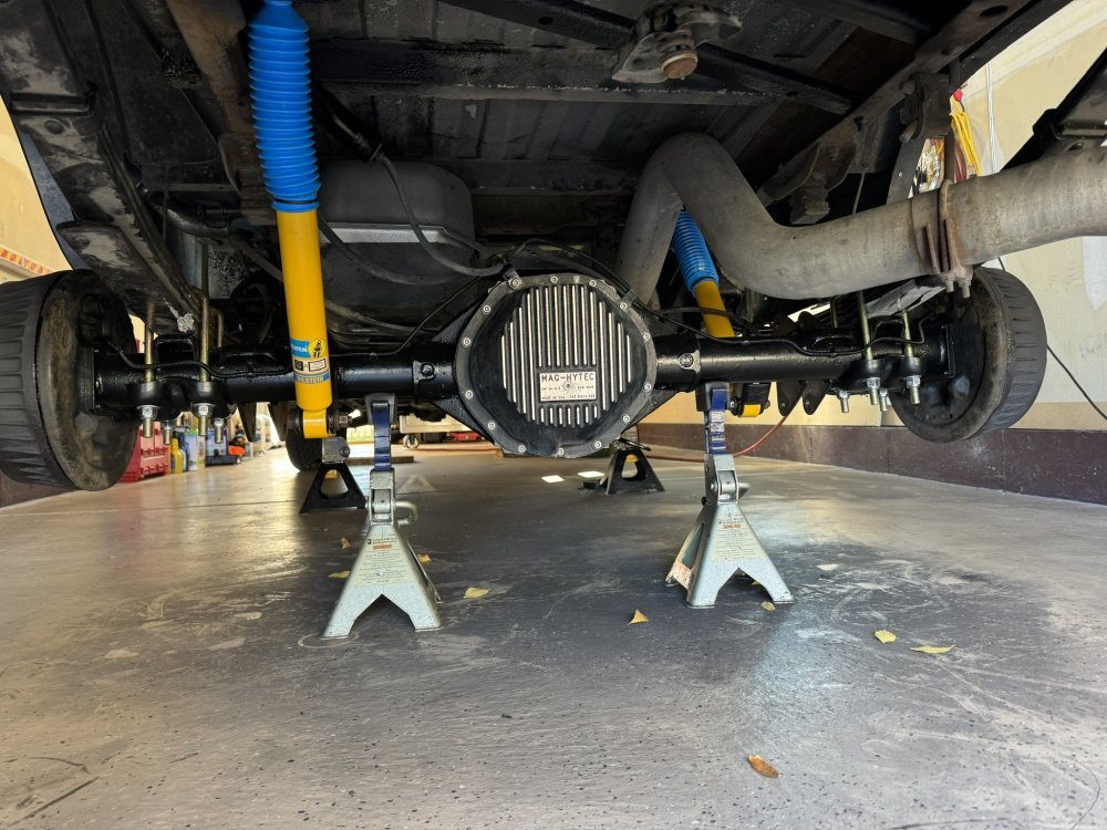

All buttoned up, torqued down.

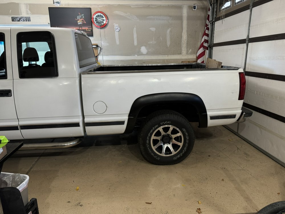

Just followed the instructions. May not have been 'so easy a cave man could do it but, I did saved over $500 doing it myself vs. chickening out and handing it over to a shop (and I didn't have to switch to GEICO). Plus got all the side work done.
Ride height back to "normal" AKA boring looking.
