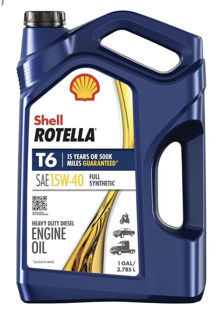

A couple days ago I changed the oil and filter on my 96 gmc with the 6.2.I used the T6 5W40 with Napa platinum filter.I ordered some rotella T6 15W40 synthetic from Amazon to have when the warmer weather comes by again later on as I can’t get the 15W40 where I am but 5W40 is readily available.Anybody use the T6 15W40 formulation?Changed the oil on the old girl today. I normally try to change it at around 3k miles even though I run synthetic. But this time I ended up overshooting that by 2k. she's got 296,049 on here today just under 4k to go before hitting 300k. I looked at the old oil filter (I write the date and mileage on install) noticed here last change was back in March with 291,500 miles! 7 months ago. at my normal rate I should be hitting 300k around February, a celebration will be in order for the 300k LOL
I also switched back to Mobil synthetic (was using Rotella T6) now that you can find it on the shelves, plus at $20 a gallons vs Rotella at $30 a gallon that saved me about $20!
Running her out to 5k on a change, I didn't see any ill effects, though she's got a decent leak on the valve covers I need to address before old man winter arrives.
