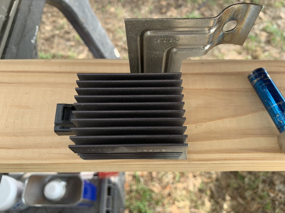

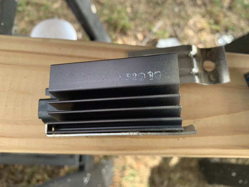

While waiting for the first coat to dry. I was looking at the dash and found this odd heatsink box underneath Googling the number on it apparently it’s some kind of resistor rectifier module thingamagig. I’m curious but I don’t think my truck has one of these. Anyone know what it’s for?

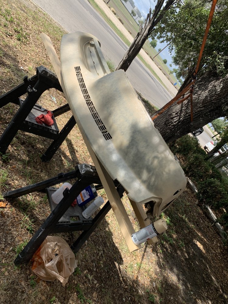

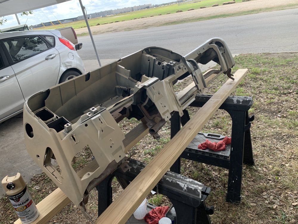

Got three decent coats on the replacement dash. now moving on to the trim parts, glove box and other things that take more time and detail.
hopefully I can start pulling the old dash out in the morning and install this one. not sure how much of a PIA the wire harness will be to fish out and in the new dash, but I will be finding out soon!!
as long as I can get the old one out and the main part installed with the steering column in so the truck can be driven, I can take my time on the rest buttoning it all up.
Giving us that P/N would help us identify it and what it's purpose is for for you so much easier than "module thingamajig". It may be the voltage drop unit for your DRL's if so equipped, as you'd need to dissipate a lot of heat for the resistance to voltage drop a pair of 55W bulbs. Of course, unless specifically designed to do so, LED Hi-Beam bulbs won't illuminate on the lower voltage of the DRL at a dimmer output.
