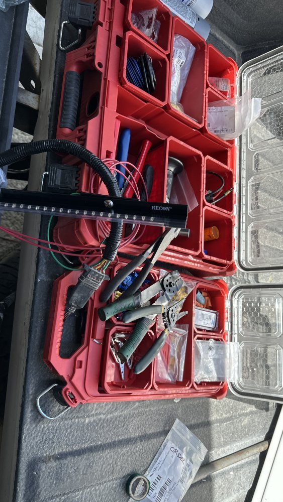

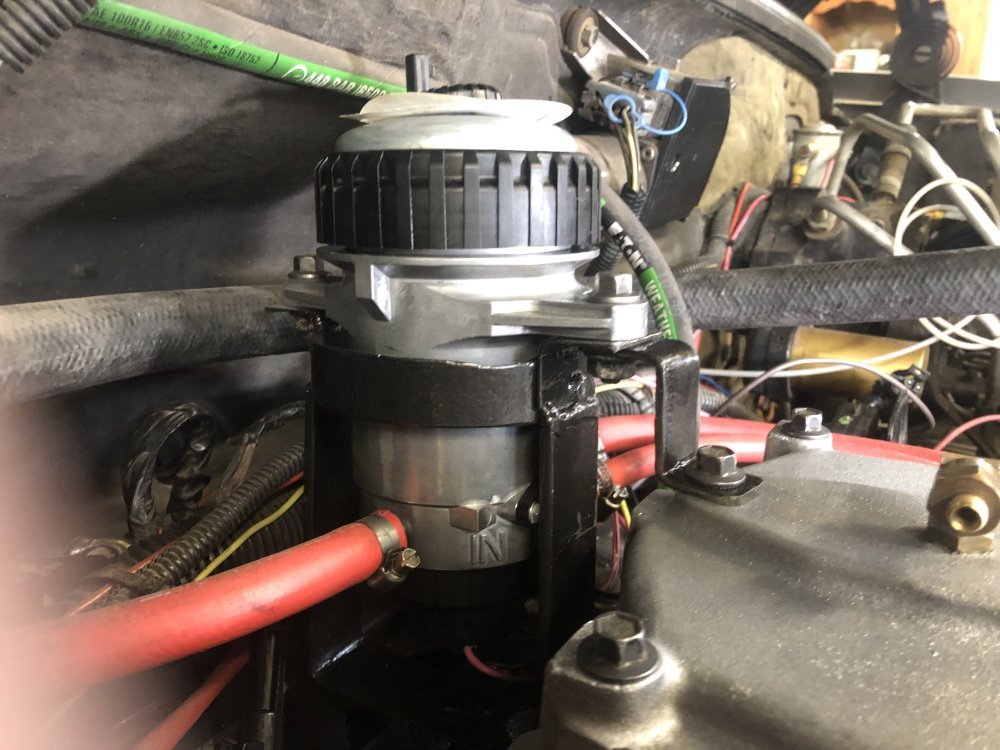

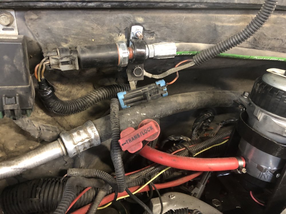

Got a double L bracket made for the FFM mounting device.
Also drilled and cut a tab to drop the hood lamp terminal connector, then used the same stud for that drop tab and also for the wiring P clamp to secure the remote oil pressure sensor/hose. I did have to extend the harness about a foot so the wires could reach.
I have part of a harness I robbed from an old truck several years back so I was able to snip wire and do it all in color code.

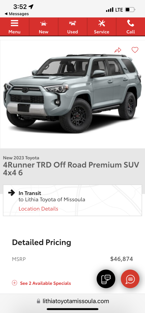

Oh and the big news is I checked on the Lithia Toyota of Missoula website and they had an Off-road Premium 4Runner in Lunarock color in transit. Had my wife call her rep at the dealer and her name is now on it. Should be there in 4 to 6 weeks:
Her 2014 4Runner SR5 is still going strong at 330K miles. Nothing but impressed with the 4Runner.

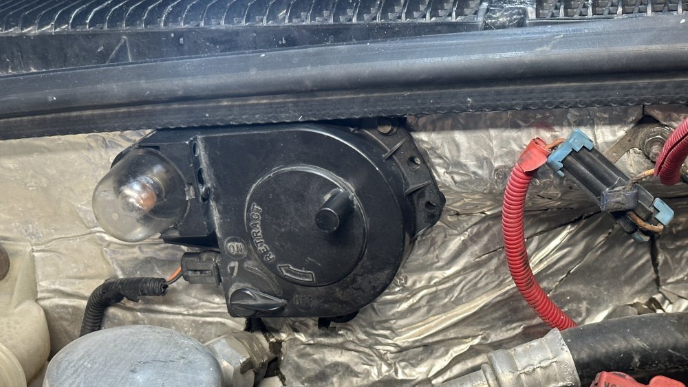

- While searching for the Headlight Switch I found a couple of Under Hood Reel Lamps. Took one apart, cleaned it up, corrected contacts that had stopped contacting, did a continuity check, reassembled and installed.
- Another time killer this morning; I noticed the right headlight was out. Figures. Been ridiculing all the Utah ‘one-eyed-Jacks’ lately and, as it turns out, I R 1 2.

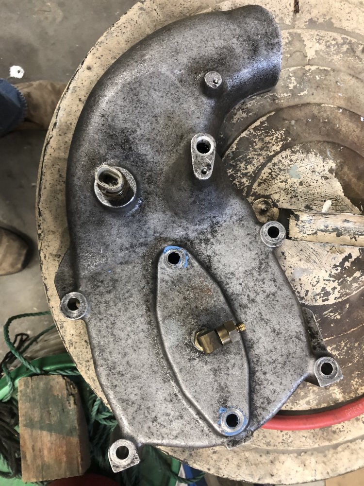

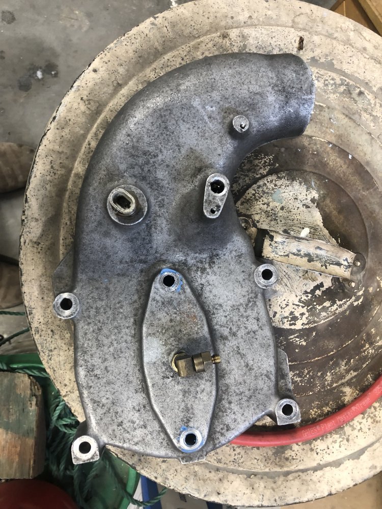

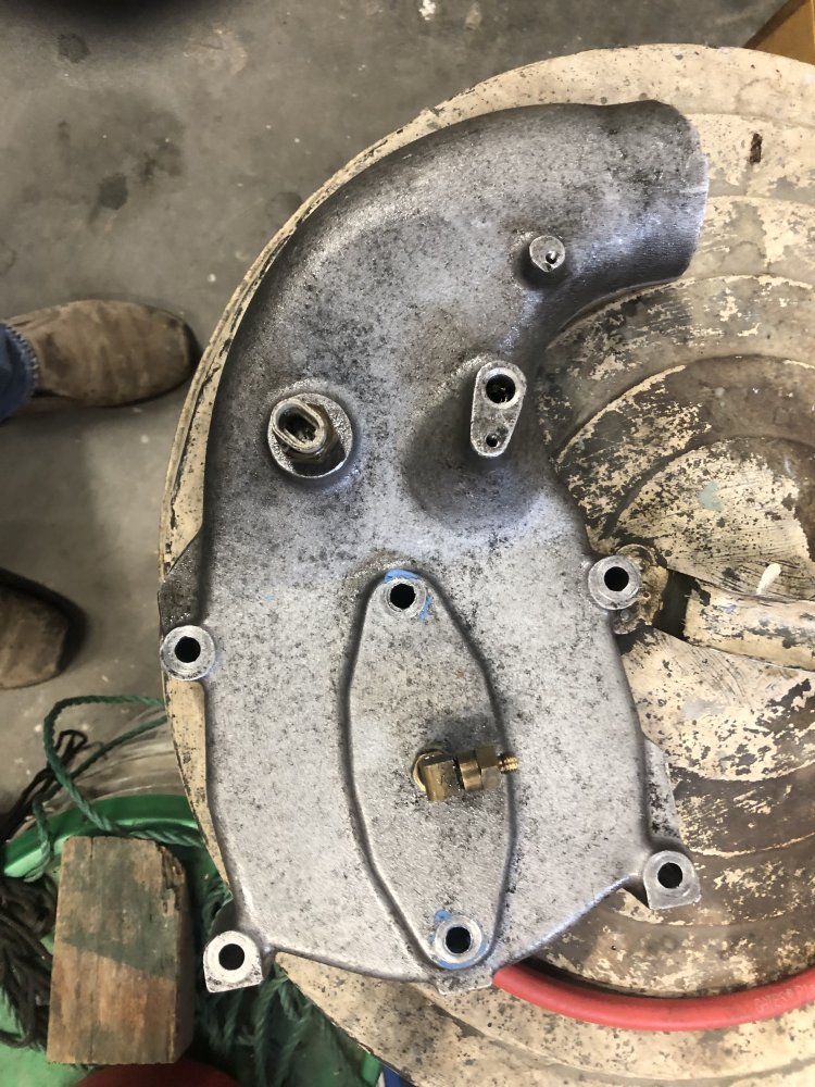

WARNING ! ! ! ! Be sure to use some parts cleaning gloves if attempting any cleaning using DMSO.I used some of that DMSO solvent to clean the upper intake manifold cover.
The manifold cover was heavily stained and so I tried several chemicals for cleaning it.
Before any cleaning attempts.
Mineral spirits, same as parts cleaning solvent and wiped dry.
Sprayed with B&P cleaner and blowed dry.
About five minutes of lightly brushing using DMSO.
About four hours soaking in DMSO then a light wire brushing using one of those tooth brush size wire brushes.

@MrMarty51 Good work. That’s a lot of effort and I get it. I was using wire wheels on drills and drummers for a while. Then I learned I was fortunate my buddy has a small media blaster that the intake and exhaust manifolds could be cleaned in. Saved a lot of time pre-powder coating. The coated said he’d have blasted them for a ‘small’ fee. Rather do it myself.
