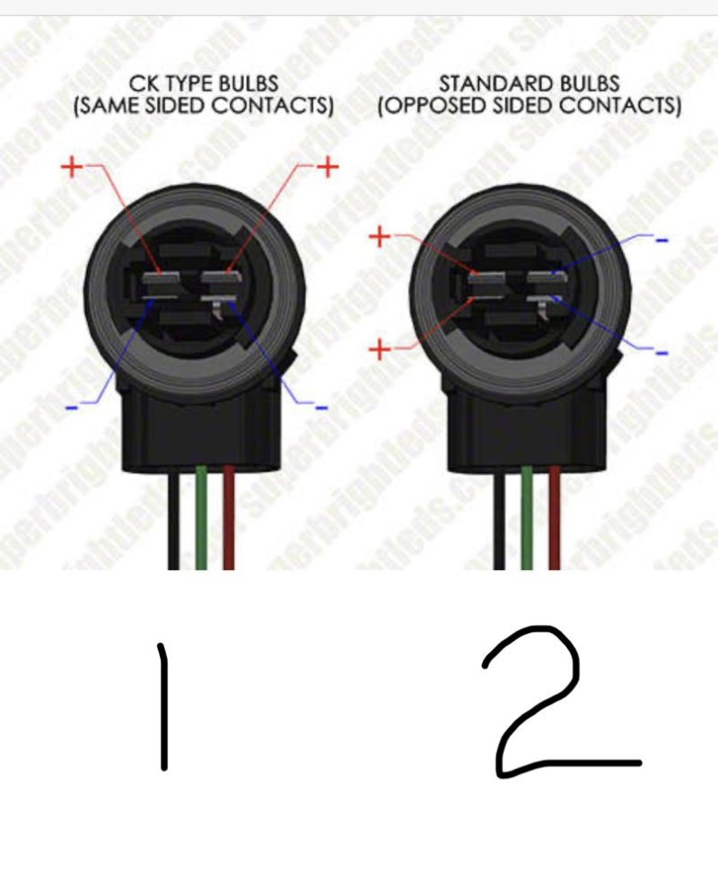

Superbrightleds.comI need to repair the engine bay lamp in my ‘99. Where did you get these?

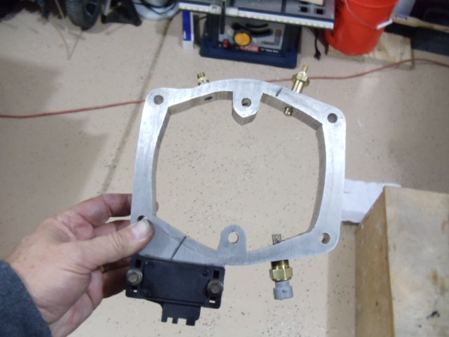

That stainless valve cover girdle would be well worth the $30.00 extra, I think.DieselSite sells a valve cover plate and stud kit, stainless but $30 higher than LD. Nobody on here is running it I guess given the lack of input.

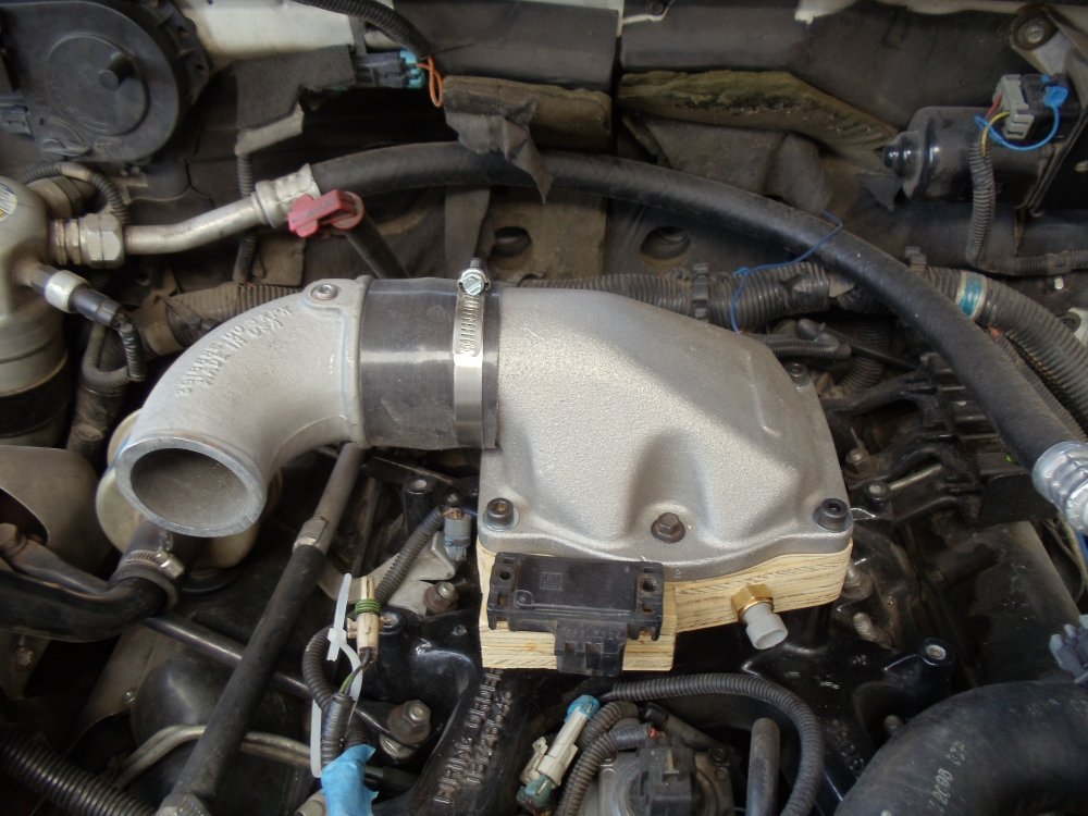

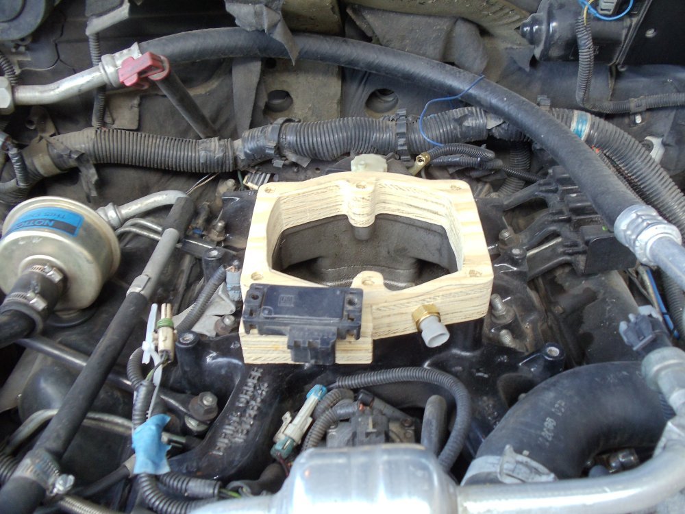

If my buddy was still doing machining I'd like to try a thicker girdle version of LD's, kinda like the P-400 crank girdle only out of aluminum like my air intake spacer he fabbed up.

I went to that site. Their SS girdle kit is 1/4” thick.DieselSite sells a valve cover plate and stud kit, stainless but $30 higher than LD. Nobody on here is running it I guess given the lack of input.

If there was a good metallurgist in the area, I’d take the LD girdles and have them hardened to tool steel grade.I have wanted cast aluminum valve covers for ever.
With all the advanced cutting machines out there, I have thought about wanting to scan and cut out a steel valve cover that 1/4” thick for the base. Then I would just chop and weld the regular cover onto it.
I never heard of this other site where he makes the stainless ones.
Leroy’s is a good idea and that was my plan- but they are simply not rigid enough. The girdle itself has to not bend.
Yes.The LD ones- are you referring to Leroy?
AR used to be pretty reasonable. We used it a lot in the grain industry.Ya have to know what the carbon of the steel is to begin with- or add carbon to it which makes it labor and therefore cost inhibiting.
1/4” ar plate thats water jet or laser cut, made like Leroy’s. I wonder what that would cost…
Shucks! I coulda had a few test runs made for you guys at my last job! Too bad, I left there a month ago. They’ve got water-jet and plasma tables and a billion other tools I miss already1/4” ar plate thats water jet or laser cut, made like Leroy’s. I wonder what that would cost…
