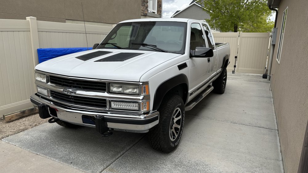

42F83876-EFB6-450C-9D62-59556613A5ED.jpegFender Flares Installed, wheels back on, truck is on the ground.
New bumper assembled and installed and the brackets are torqued to the frame as they should be.
Another bitch about LMC. The bumper has been in the box since purchased a few years ago. Turns out they sent me a unit returned by a previous customer who mounted it on their truck (chrome scared from bolts torquing down at all mounting holes), dented it at the left nostrile, and slightly twisted the left corner mounting points at the bottom. Jerks one and all. Of course, that’s the receipt I can’t find and since I’ve been away from their site, LMC log on doesn’t work and their system doesn’t ‘remember’ me. Great. Oh well. I got it to fit with the help of my wife keeping things from falling on my dented skull. She also stayed out in the cool (ice cold to her) weather and helped mount the flares, holding them in place, peeling the 3M mounting tape etc. You few who have met her know what a treasure she is. Truck need another bath cause we got more winds, dust and rain. Still, it looks good with the flares and new bumper.
