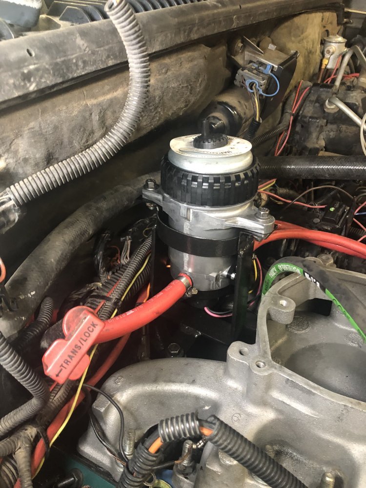

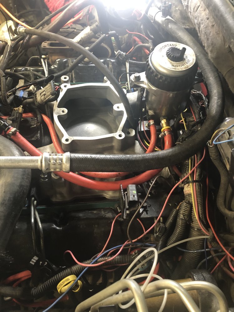

I removed the FFM, laid back wiring and items and got the intake manifold set atop of the heads. Did that late yesterday afternoon. When accomplished it was back to the recliner to ease some back pains.
Awoke about midnight and me and the little puppydawg trundled off to bed.
Just getting awokened and moving. See how much I csn get attached today.

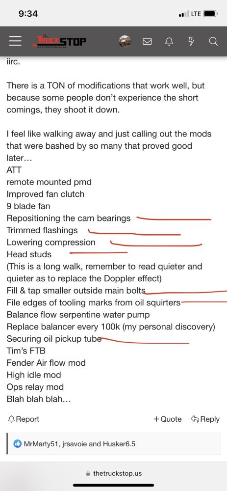

Of all theee, only repositioning the cam bearings has anything to do with moving internal parts of the engine.
Bro- you just wanna argue.
Wrong again.
I marked the 7 I Listed- yes cam bearings are inside.
Please show me the other 6 …how they are not inside the engine, how they couldn’t destroy the engine just as fast or faster?
And there is a BUNCH MORE I didn’t write
Girdles
Sizing oil bushing portals
Edging things like crank, rods, pistons, cam, lifters, etc.
Dude- apparently no one ever explains to you when you’re wrong.
Just swallow the pill man, you’re wrong. It happens. Get over it and let it go.

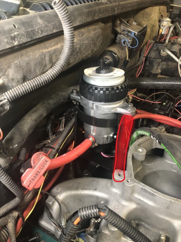

@MrMarty51 Make you a bracket from the intake to the FFM to limit some of the vibration for the FFM. this way it lessens the chance the pedastol you made coming loose down the road.
Good plan. The center bolt for the upper intake manifold will be an excellent mounting position. A simple two hole tab and possibly an offset S kind of a bend and done.

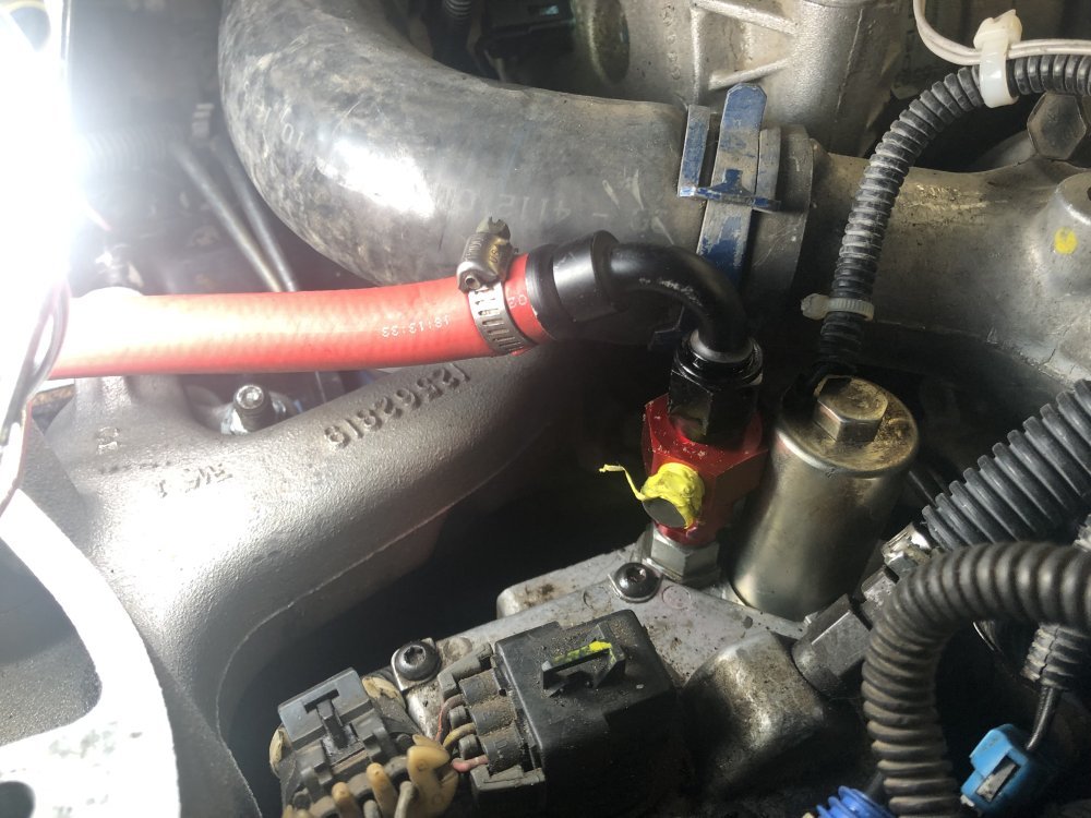

The hose made for the oil pressure remote sensor is also some too long. It will work out good though.
Going to make a two hole tab to mount the underhood lamp connector too, a stud mounted to the firewall with a nut keeps that in place, mount the two hole tab to the mounting tab of that connector to drop it down about an inch and a half, then a wiring P clamp around the oil pressure sensor switch and that will have a secure mounting position high on the firewall and the OP sensor harness/connector will still reach it.
I had that remote hose made 24” long and that length is just right for this secure mounting position.
I do not know how long the hoses that Leroy sells is so I dont know what a good secure position would be for the sensor when using His remote hose.
