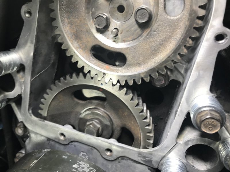

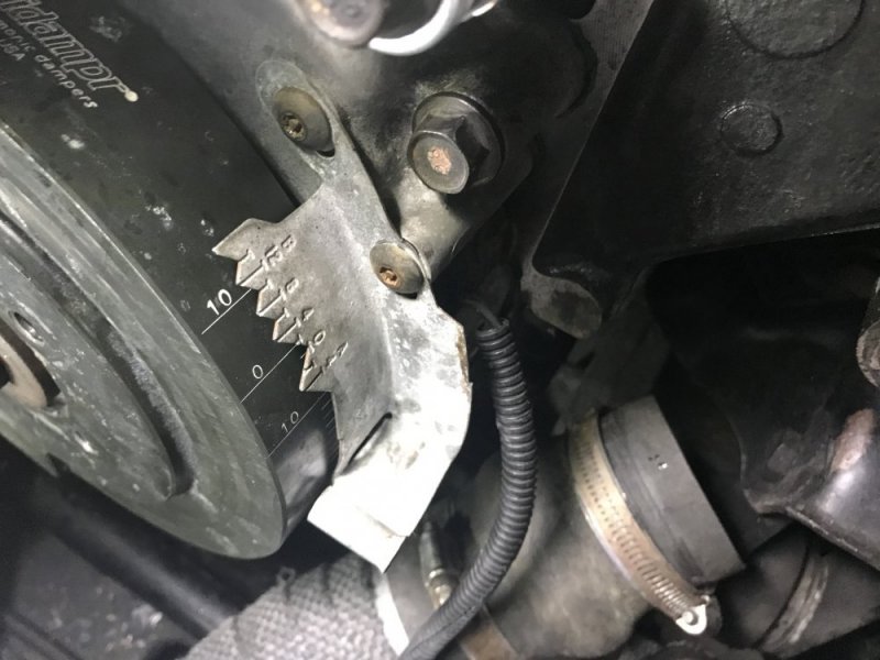

And this would mean if I rotate the crankshaft one revolution clockwise the cam would turn 1/2 a revolution which would put the crank dot @ 12:00, the harmonic dampner @ 0* lined up with the 0* mark on the timing indicator on the gear case and the cam gear @ 12:00 and the IP gear dot @ 6:00 which would mean the the engine would be at #1 TDC exhaust stroke correct? So the pictures here would put the engine at TDC #1 exhaust stroke.Hey guys, I'm going to try and do a leak down test on the cylinders without removing the valve covers and the rocker arms by counting crank revolutions to get each cylinder on TDC compression stroke. I just needed to confirm that when the crank gear dot is @ 12:00 and the cam gear dot is @ 6:00 number one cylinder is at TDC compression stroke correct?
That should be correct.And this would mean if I rotate the crankshaft one revolution clockwise the cam would turn 1/2 a revolution which would put the crank dot @ 12:00, the harmonic dampner @ 0* lined up with the 0* mark on the timing indicator on the gear case and the cam gear @ 12:00 and the IP gear dot @ 6:00 which would mean the the engine would be at #1 TDC exhaust stroke correct? So the pictures here would put the engine at TDC #1 exhaust stroke.
