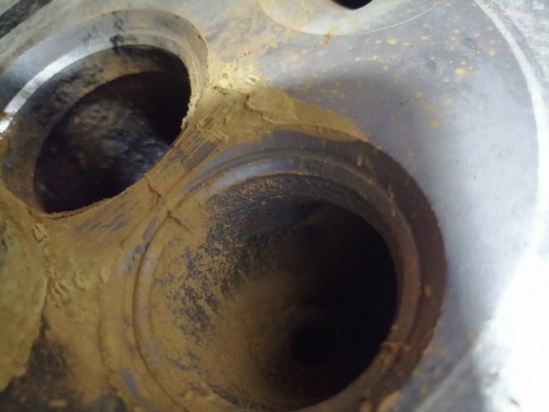

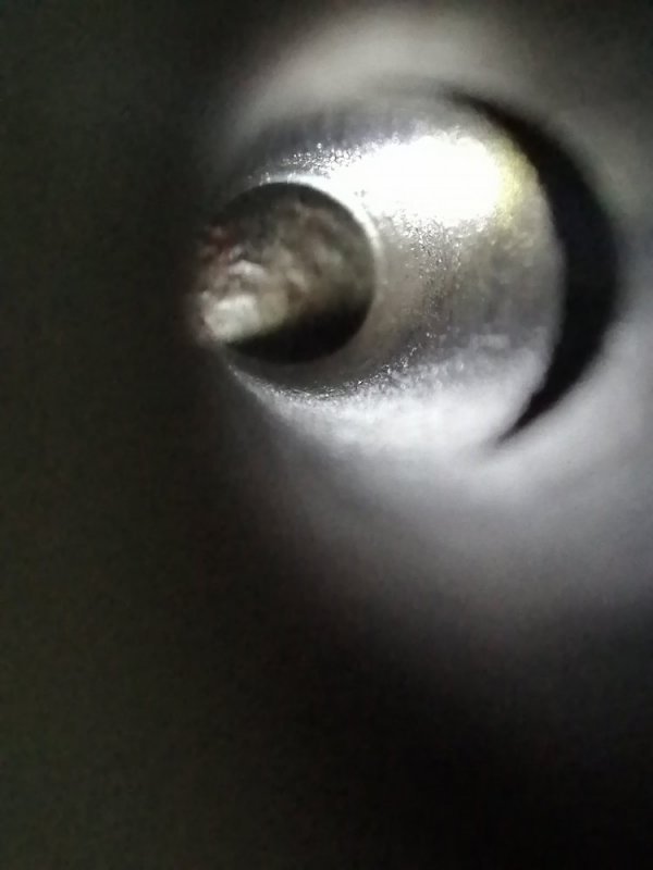

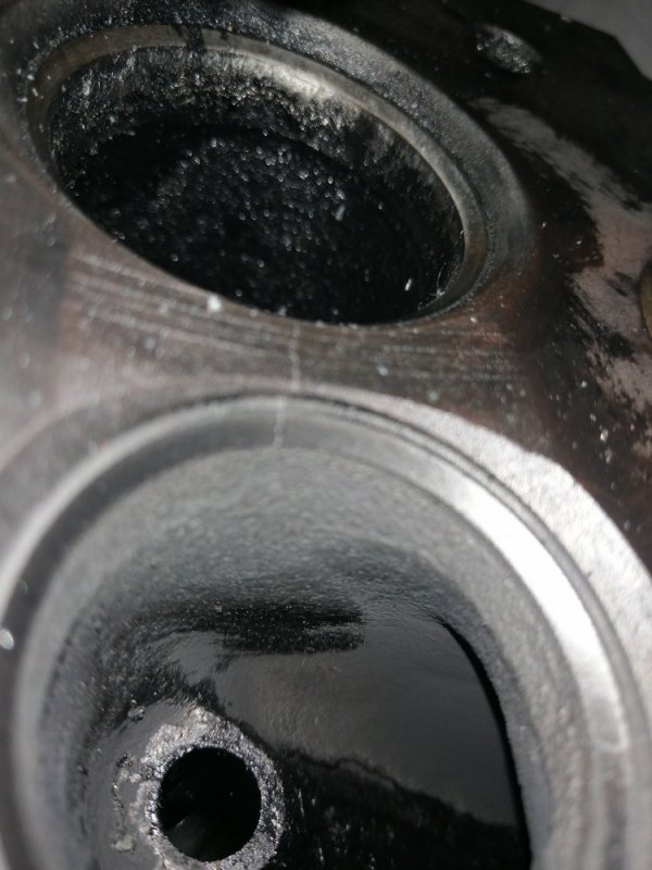

Is it a custom head? Are guides and saddles installed? Is it made from an ordinary head or is it a new type?
A saddle cannot be inserted into an ordinary head; could it be a hole in the cooling cavity?
My head cracked. A crack went through the saddle. The cooling channel between the valves seems normal. But I will not put this head. I am looking for a repair solution or a new head.

Leroy price 1200 $
Maybe there are more options? Where do you buy parts other than Ebay?
