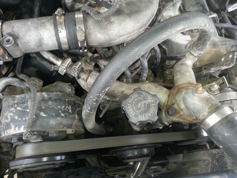

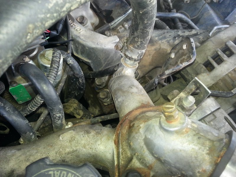

Funny home made cross over tube thingy from original owner

Funny home made cross over tube thingy from original owner. I would put a plug in the pump and plug the other end of that hose. No need to recirculate more hot water as that is all it's doing.

I am assuming one of the many prior owners was military. Because the hmmv t-stat/crossover housing has a port there. This one was welded on there by Joe smoe.
