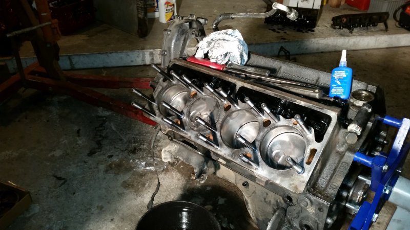

Well the motor is all back together with : head studs (torque to 110 ft.lbs.), felt .010 gaskets, marine injectors, new crank pulley, 1999 high flow water pump, 195 t-stat, luk solid flywheel and clutch, and a whole bunch of new gaskets and rtv.

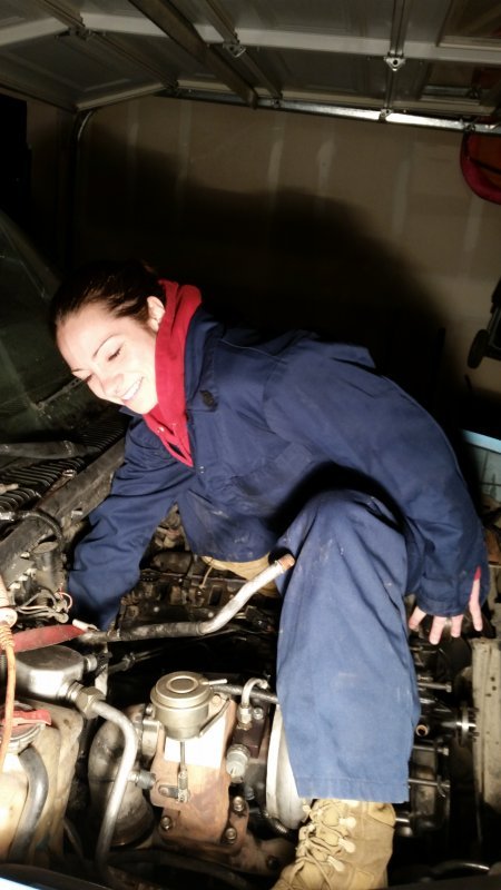

20150123_211557.jpg Almost finished it last night. Just have the starter, battery cables and crossover pipe then she should be running. Big thanks to my wife who helped until about 1100 then stopped me at 0300.
No. It started when I was a lcpl we stole her some coveralls and because she always worked with us on our projects my friends pinned cpl chevron on her so she could be my boss. Now I am a Sgt but I still haven't been able to pass her up. I find I am never really in charger as soon as she shows up. I think it's a wife thing.
And those are my old boots. They are like clown shoes on her but they are her only pair of shoes she doesn't care to wreck.
