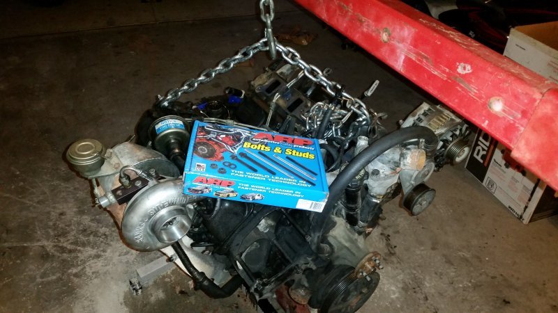

OK as you see head studs are "on the motor"
But now I have some questions. The directions say torque the studs down to 90 ft.lbs. by way of 30-60-90. My question is, is that enough? Seems very low to me. I am using .010 thicker gaskets so should I adjust or the extra material. Please let me know what you have torqued your heads down to when using studs

I did the 30-60-90 thing. My understanding is when you torque a bolt dry you have to use more force. With the studs and a nut on the end that is lubed up it takes less force to clamp the head.
Seems logical. And you have had no problems thus far. So your saying that following directions is the right thing to do...

A bolt must be installed by torqueing it into place by rotation, creating both twisting force and a vertical clamping force, which means it will stretch and twist. Two different forces simultaneously, its capacity to secure the head is slightly reduced, and requires more torque. A stud tightened into the block is stationary. A nut is torqued into place against the stud atop the head. The nut torque provides the clamping force, rather than the torque of the fastener itself, and the rotational force is avoided entirely. The stud is torqued from a relaxed state, the nut will make it stretch only along the vertical axis without a rotational load. A more evenly distributed and accurate torque load compared to a bolt and therefore requires less rotational torque on the nut.
When I custom made my 90* intake manifold studs, I used a tremendous amount less, iirc 60% less, and destroyed the first gasket set I used to determine the new torque required.
No added torque for thicker gasket.
It's 100 ft lbs with ARP molly assembly lube or 130 ft lbs with 30-wt motor oil.
If you didn't seal the threads of the studs in the block START OVER!!!
The threads will leak coolant if they are not sealed to the block. Blue locktight works. I then tighten the studs into the block. At least use something to seal the threads on the block side. It sucks to deal with coolant in the oil from this and it's easier to "fix" with the engine out.
