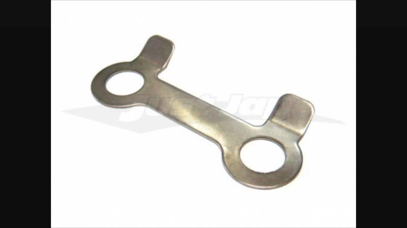

The new threaded flange is awesome. That the key. I say drill the bolt heads for safety wire, no thread locker use anti-seize. If you don't like safety wire then a couple of these. Just keep the pattern for when you start building these when evrybody wants one.

Oh, that's a good idea, thanks.
