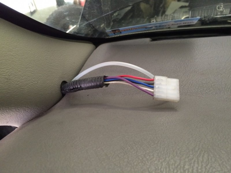

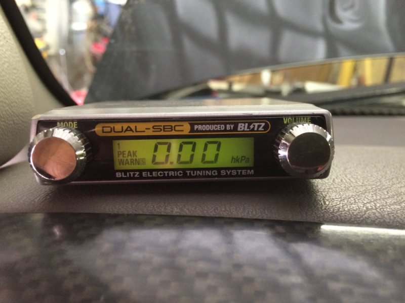

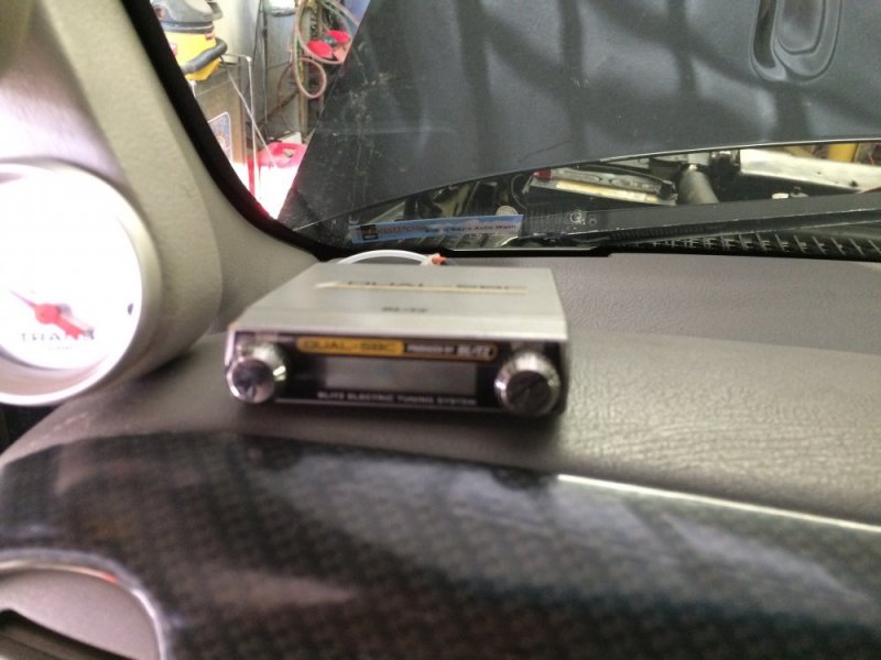

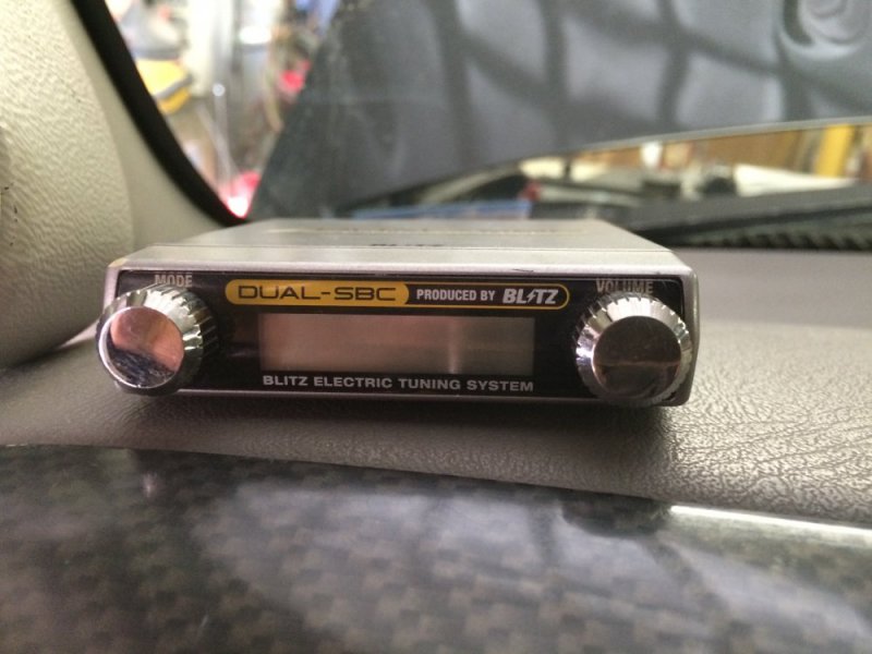

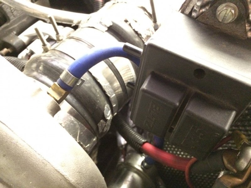

Easier? I don't think so because with the turn of the knob I will be able to adjust the boost pressure I want real-time while driving down the road. Now cheaper? Oh yes. However I was fortunate enough to have a friend of mine with this controller laying around and he gave it to meN8in8or, it's Tom Swift and his electric turbo! Wouldn't it just be easier to use the boost reference signal (hose) to the wastegate actuator and an adjustable tensioning spring to act against to set the wastegate opening boost pressure?
That's a fair point, but all I have to do is pop the hood, unhook the hose from the solenoid on one side, unhook the hose from the compressor housing and then connect the hose from wastegate actuator to the compressor housing..... and then I'll have the exact same setup I have right now. So no, I won't have a high boost available, but I'll have the same 16psi I have right now, so I won't exactly be a squid.....maybe just a mosquito fogger. Right now I feel like the ability to quickly and easily try different boost settings outweighs the chance for electrical gremlins.....now that may change should I start having electrical gremlins, but at least by then I'll know what boost level I'll want to shoot for.And in event of electrical gremlins, then what? Zero boost and billowing clouds of black smoke like a giant squid fleeing a sperm whale?
