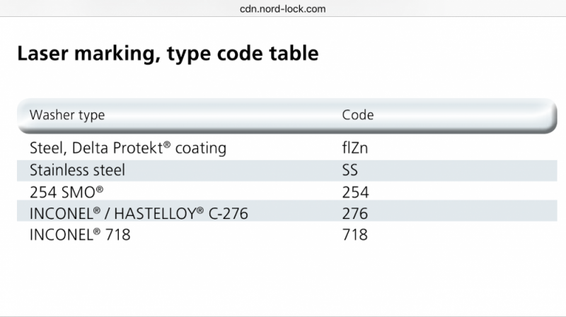

Will, I was under the impression inconel is a type of SS anyway. I attach a link to NORD LOCKS data relating to strength and temp limits on each type of material, admittedly I was confused at first and after conversation with my buddy he pointed out that exhaust manifold fasteners cab be of lower grade materials however for turbochargers, turbines etc inconel is the route to go 'as the links data shows.'
http://www.nord-lock.com/nord-lock/wedge-locking/washers/selection-guide/
