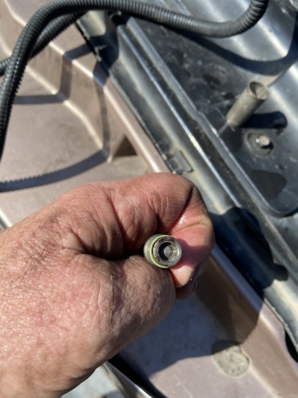

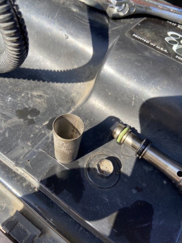

I checked the screen on the incoming to the IP and it was completely clean.

How is the fuel coming out of the inlet pipe to the IP that you disconnected from the IP to check the screens? Although subjective, if it's not a gusher with the lift pump running I would ask how old is fuel filter, remove the last ditch screen in the FFM, and suspect a hose kink or flapper between the FFM and IP.
You have good pressure at the FFM water drain: it then goes through the filter and last ditch screen.
