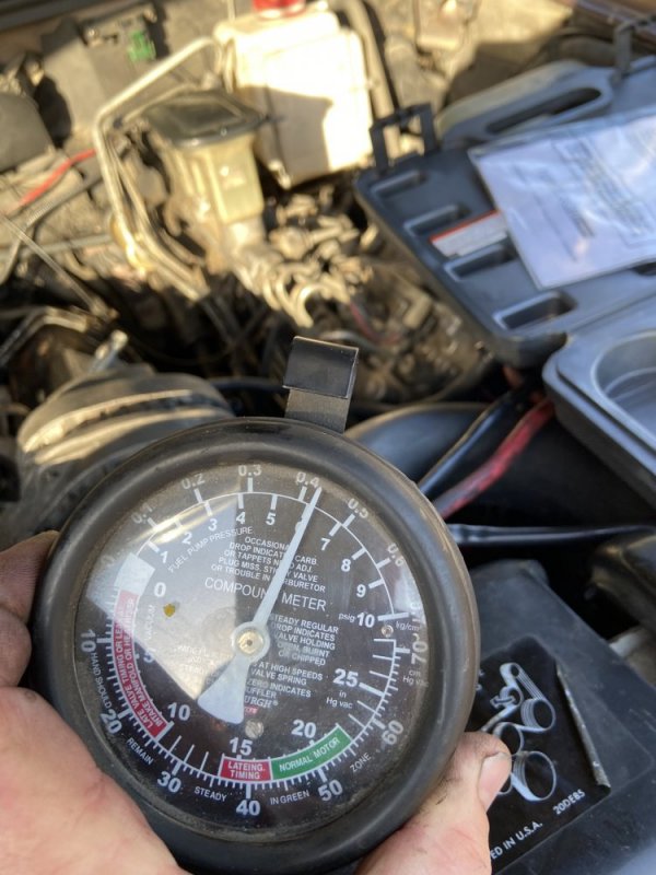

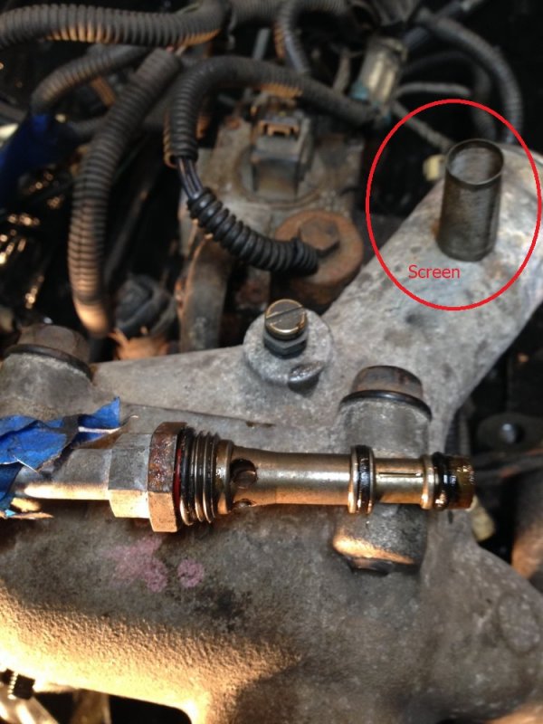

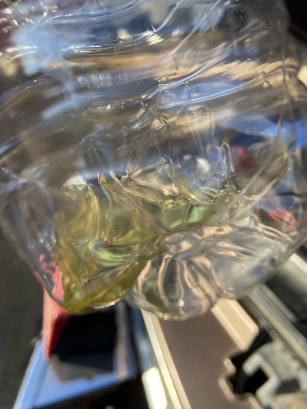

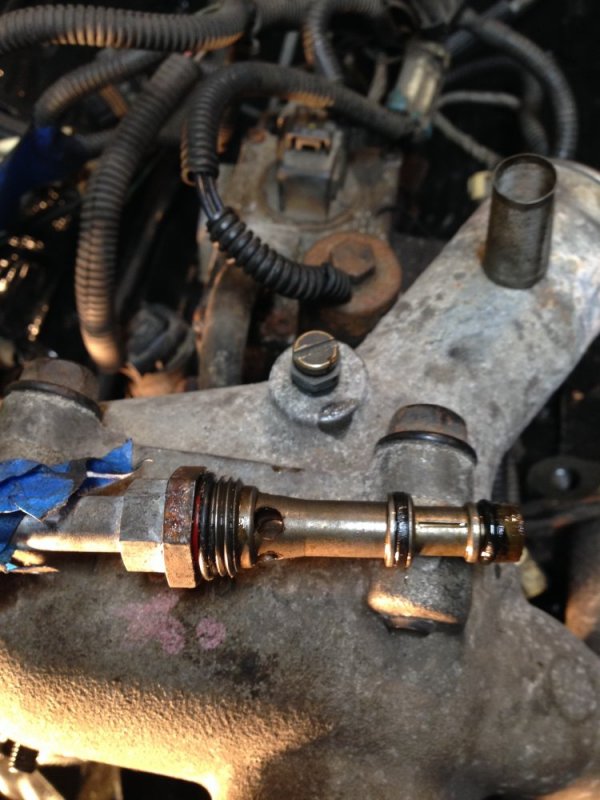

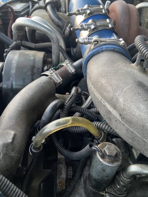

I agree the fuel system pressure have to be build up.
I would also make sure that the LP is on all the time during this process.
Start by bleeding the LP to FFM first and keeping the LP on crank the engine with some GP out with some pause to cool starter.
Make sure both batteries are strongly charged.
