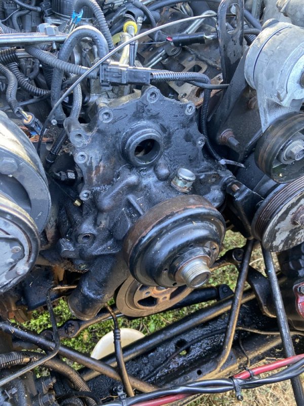

Water pump is relatively new, 60K. CPS is new. Have front main seal. Not sure how to install. It’s been awhile. Do I need to to pull the radiator or just the fan shroud to do all this?
I pull the radiator for ease and no damage. The extra hour doing it saves more time than that being able to zip everything fast and easy with impact and not trying to be cautious or fight for space.

If doing the timing chain/sprockets, cover will be off, just knock out old seal and drive in new one. Be sure to coat the seals outer surface and the seal bore in the cover with some no 1 or no2 Permatex. Thats how I doooit anyhow.
Be sure to coat the coolant pump gaskets too. I think maybe a couple or so of the coolant pump bolts might benefit from sealing the threads too. IIRC.
If not doing the timing chain/sprockets and replacing the front cranking shaft seal with the front cover in place, also be sure to fill the seals spring side cavity with grease to keep the spring from bouncing out.

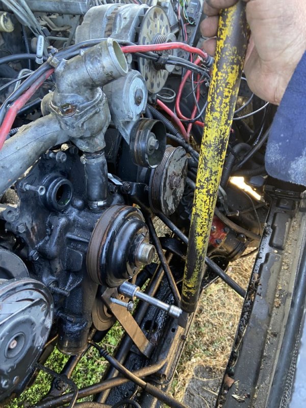

For removing the crank bolt holding the HB, IIRC I used a demo bar bolted to the pulley and braced against the frame to fix the crank, then I used my floor jack handle over a breaker bar to get it loosened. To put it back, I reversed that.

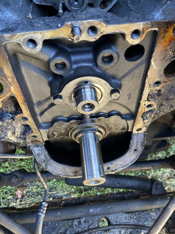

Leroy rents the puller/installer iirc local parts store have them, but not normally the thread we use.
Hink sells a simple installer on ebay or something- can’t remember where he does or if he still does.

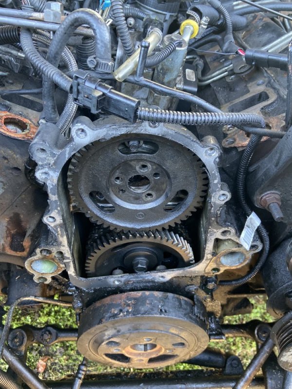

290K miles on this timing chain:
Do I need a gear puller to get the lower gear off?
Used my Rigid cordless 1/2” impact which made things go fast. Had my wife sticking bolts into cardboard in the pattern they came off to make the reinstall easy. All cleaned up and it goes back together tomorrow.
Use some no2 permatex sealer on the water port gaskets and on the coolant pump gaskets or else they will leak. Found that out years ago, the hard way. It also might be possible that some of the bolts extend into water jackets, be sure to use sealer on the threads of those bolts only, not on any that goes onto capped over holes. I usually feel inside of the opening to see if the bolt hole is open.
