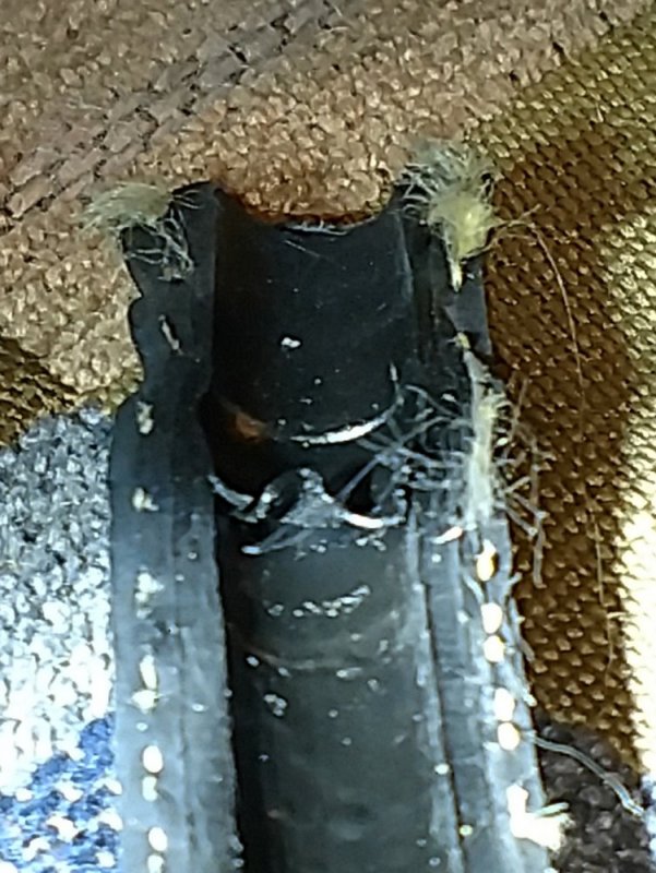

Also, inspect that hose really well- I have seen Many fail inside and create a flap that plugs the line right at the fitting. A bug part of why I want to see metal “Tee” used fat the ip for fuel pressure gauge.

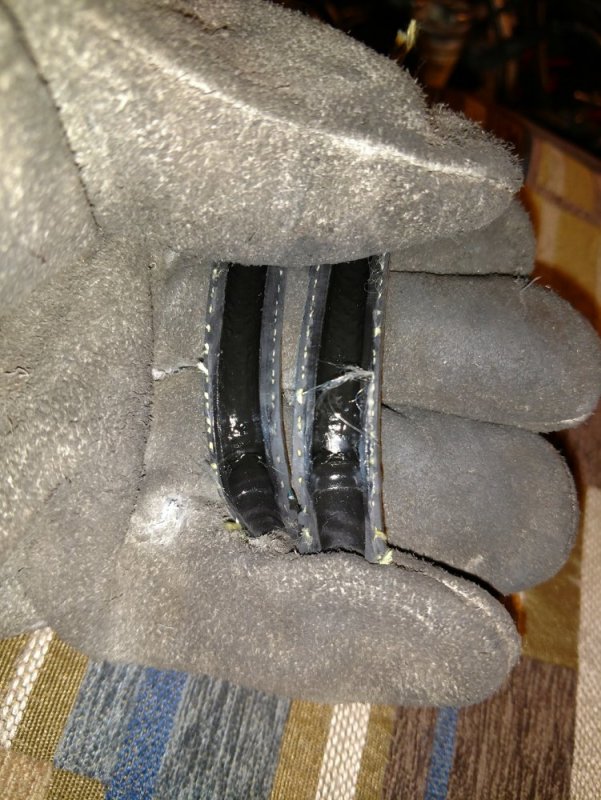

Hose flapper example at inlet to IP. Kinked shut hoses soft from Biodiesel also gave me no end of trouble.
