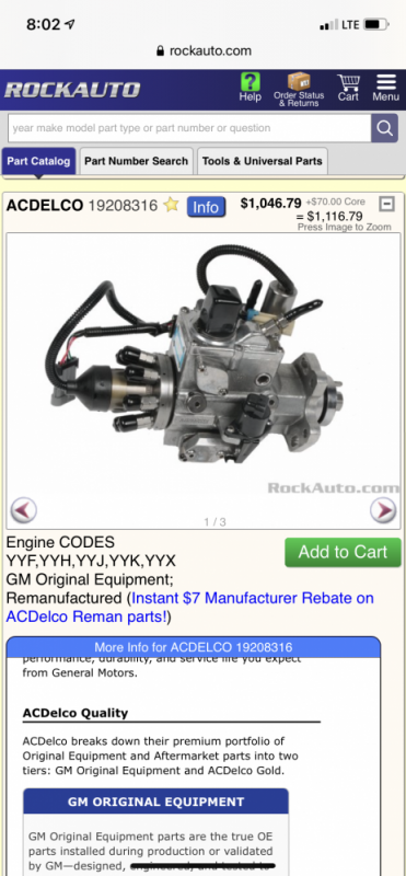

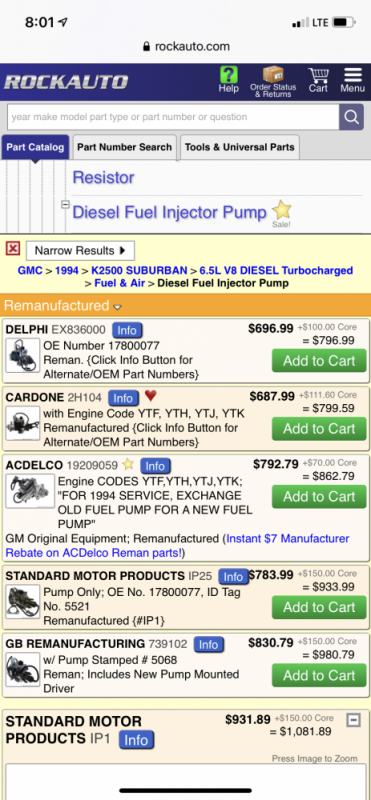

Rockauto shows two different AC Delco IPs for the ‘94 Suburban with different prices:
They identify by engine code. Where do I find that? Here’ the VIN:
So which one?
