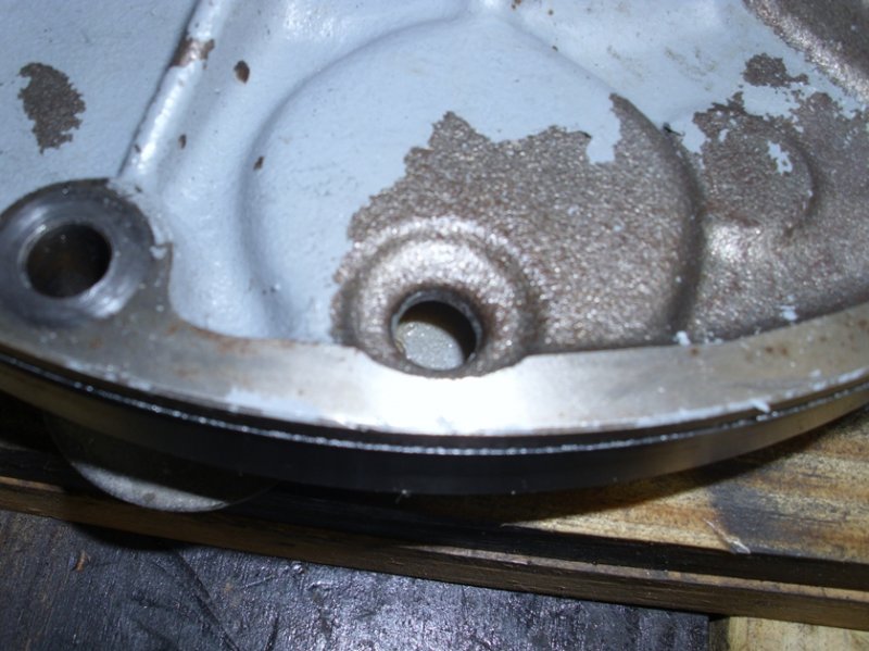

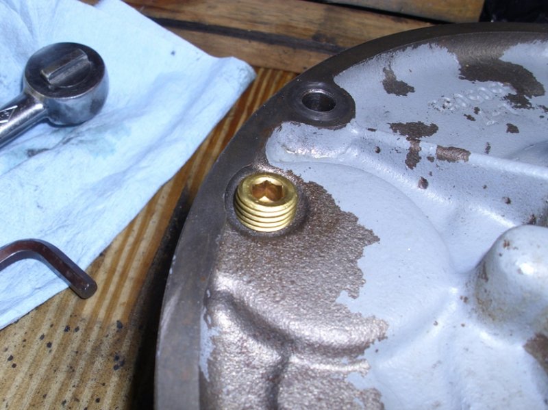

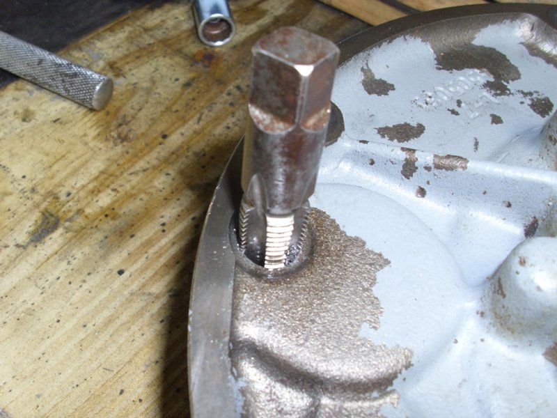

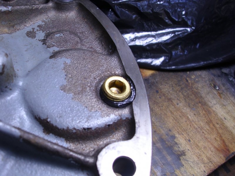

Here are some more images of the 47RH front pump "vent block-off mod" I used gasket maker that is synthetic fluid friendly.

I didn't know that some gasket maker isn't synthetic friendly.
I suspect these days most RTV can stand up to the synthetic fluids, some time ago AMSOIL had posted a bulletin about it and recommending to use gaskets in place of GM recommended RTV in some assemblies using synthetic fluids...now I just buy RTV made for synthetic fluid applications because of the expense of these fluids nowadays add to this any water ingress will require new fluids so I plan accordingly.....

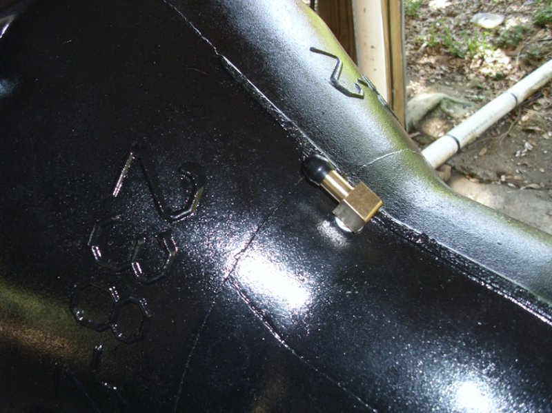

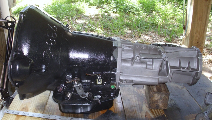

Finally, finished the 47RH 2wd conversion to 4x4 used lots of billet, ALTO & ceramic clutches also increased clutch count as needed.
The valve-body has many of the TransGo and Sonnex mods & updates too.
90 deg vent will keep water at bay...now on to the NP241c input shaft so I can bolt it to the 4x4 trans.
