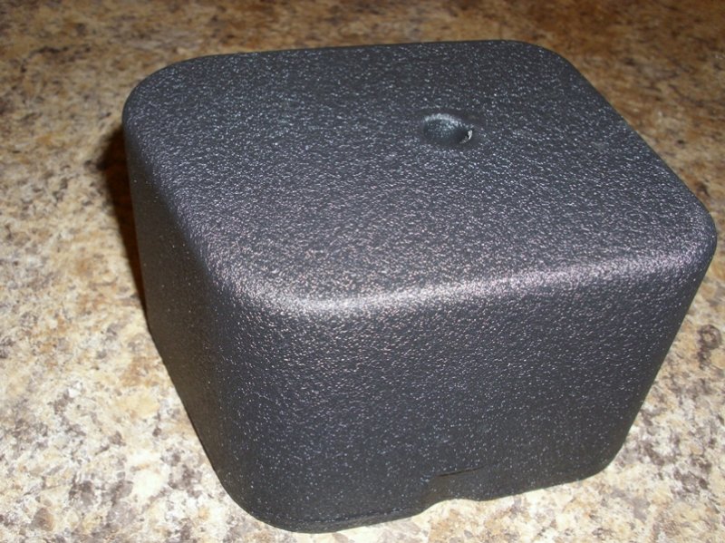

Powder coated the (6) valve covers and hi-flow intake runner on manifold a nice black crinkle coat.

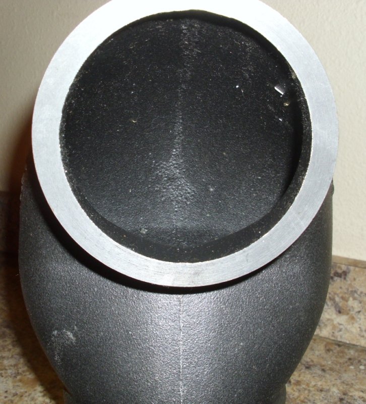

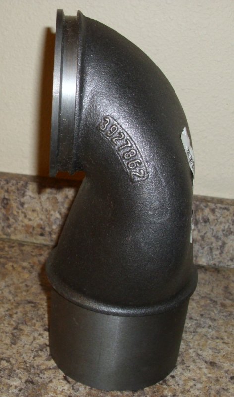

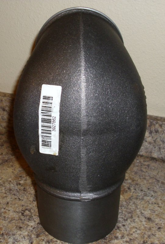

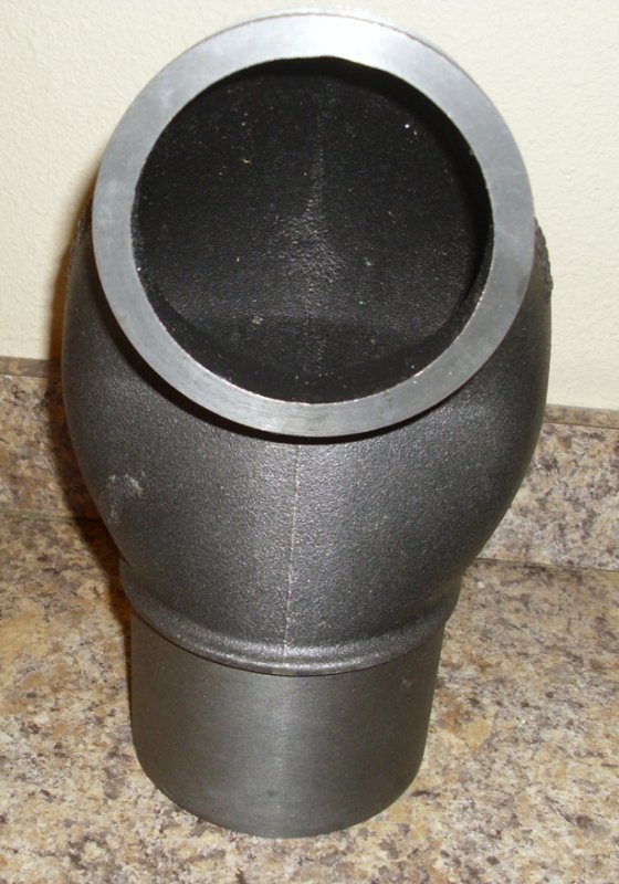

Here's the rare HX40 Cummins cobrahead I'll be using for my project. It's highly sought after by those building compound turbo setups which has driven the price up.
FORD has went to this design and claims 30+ HP gain over round elbows.
