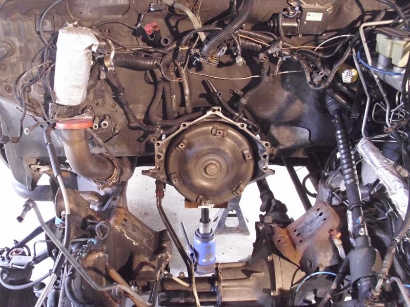

I've decided to do a Cummin's conversion
Things are a little slow with the cleanup from the hurricane taking a front seat to everything else. As I'm not a young 'rooster' anymore and have disabilities I'll eventually get it all done 'slow but sure' in the tear down mode now.
So far I have the 12 valve, destroked 12v to GM adapter w/billet flexplate, 6.0 powerstroke starter, manual t-case floor shifter w/trim, and gmcuminsconversions.com motor mount brackets that use the 1st gen dodge ram cummins mounts.
Still a GMT400 gasser throttle pedal-cable, Quick4 trans controller, low stall torque converter, FERMS NP241c & lengthened front driveshaft to the IFS diff for now.
After I get all the conversion bugs worked out and do some shake down runs I'll do the SAS conversion.

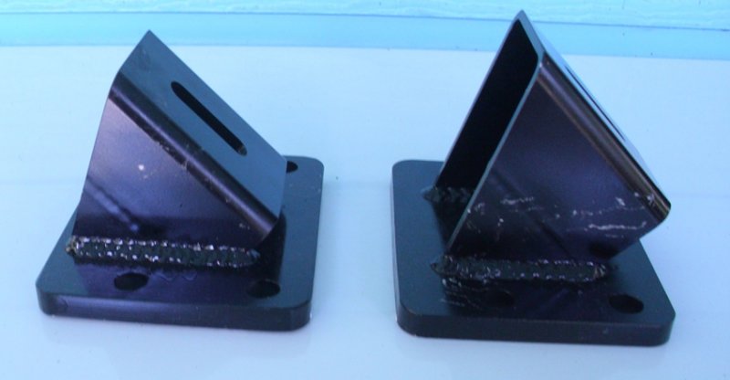

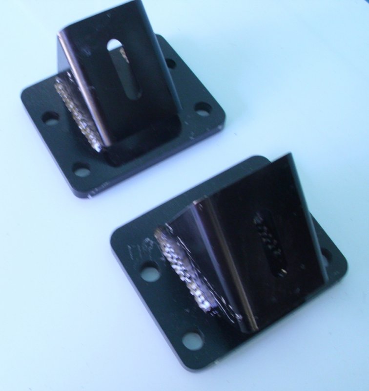

The motor mount bracket kit is from gmcuminsconversions.com is of high quality excellent instructions and over the phone help is well 'excellent too.' The kit allows mounting the 12 valve on the existing GMT400 motor mount chassis pads and comes with front differential clearance bolts uses 1st gen cummins ram mounts.
Aside from moving the 12 valve back (mine will be 2.25") I get to use the factory Cummins cooling fan/clutch. The firewall needs to be recessed too for diesel to trans adapter clearence and for access to the bell housing bolts.
Picked up heavy walled drive shaft shortened 2.25".
The 12 valve to Chevy/GMC adapter, 2k foot lb flexplate is from Destroked, starter is FORD 6.0 diesel.
Finally will get the 6.5 long block out this week end.
Picture soon to follow.....

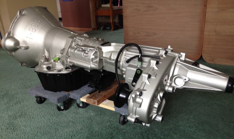

As the transmission goes my objective is the 47rh w/241 DHD 'like pictured' it's controller free w/2 wires one for the OD and the other for LU if perhaps I lose one or both I can still drive but with only 3 gears w/o damaging anything. 'Notice the GM styled trans mount.' I have a low 1.0/1.2 k stall converter on my 47rh and can say it's a dog from a stop but there is no slippage to get things rolling as with a higher stall speed.
