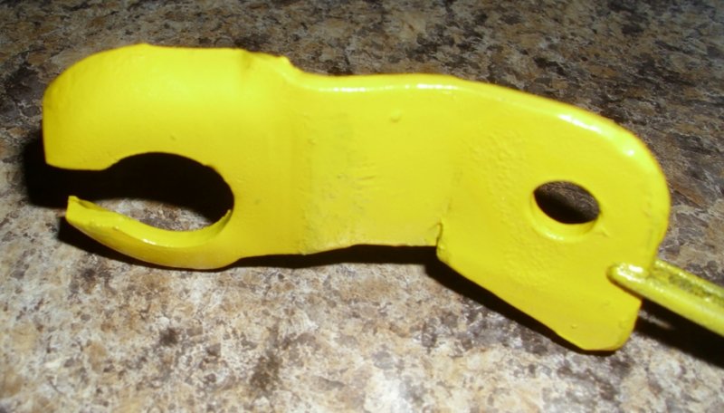

Latest "KEEP IT SIMPLE" is a transmission shift cable bracket made from the factory 4L80e bracket to us the GM shifter cable with the Dodge 47RH transmission. Mounts just below the starter hump on the bell housing and will not rotate.
The cable is routed into engine bay then looped facing to the rear when attached to this bracket it pulls the 47RH linkage forward "on the CHEVY/GM it pulls backwards." Once installed the cable can be adjusted for travel.
