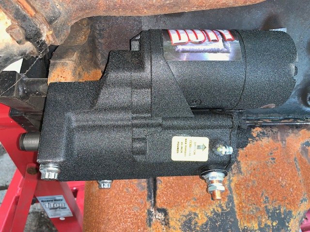

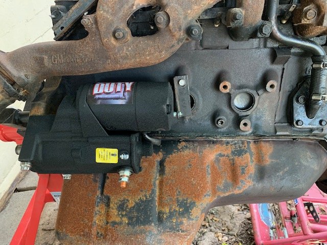

Went to crank it click click click batteries charged up did a load test on both batteries good. Gave it on more try and when it clicked I put a wrench on the crank pulley turned it a little and heard the starter drive return back out of the fly wheel did that a few times no luck. Out there today getting ready to pull the starter and I thought I’d give it one more try and it cranked over. Still think there a problem w/the starter. Bad spot on the armature maybe. So with all the GP,s out KO turn the LP on and the
