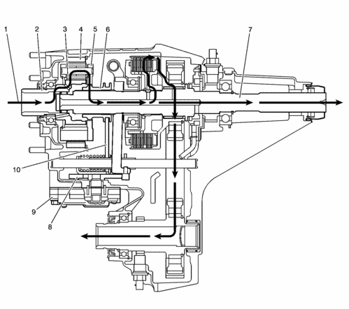

When shifting the AutoTrac transfer case to the 4 LO mode, it commands the encoder motor (9) to turn the control actuator lever shaft (8}, to move the high/low range shift fork (10). The shift fork (10) moves the high/low range collar (6), which is slip splined on the rear output shaft (7) toward the rear of the transfer case. The range collar (6) outer teeth disengage from the input shaft gear (2) inner teeth. The range collar (6) outer teeth then engage in the planetary carrier (5) teeth. The power flow is now from the input shaft gear (2) planetary teeth to the planetary gears (3) in the carrier. Rotating the planetary gears (3), which are engaged in the annulus gear (4), the planetary carrier (5) rotates. The planetary carrier (5) engaged to the range collar (6), drives the rear output shaft (7), providing a 2.72:1 reduction to the speed of the rear output shaft (7). The power flow to the front prop-shaft is the same as it is in the 4HI.
A neutral position is obtained when the range collar (6) is not engaged to the input shaft gear (2) or the planetary carrier (5). Neutral position is used for towing the vehicle.

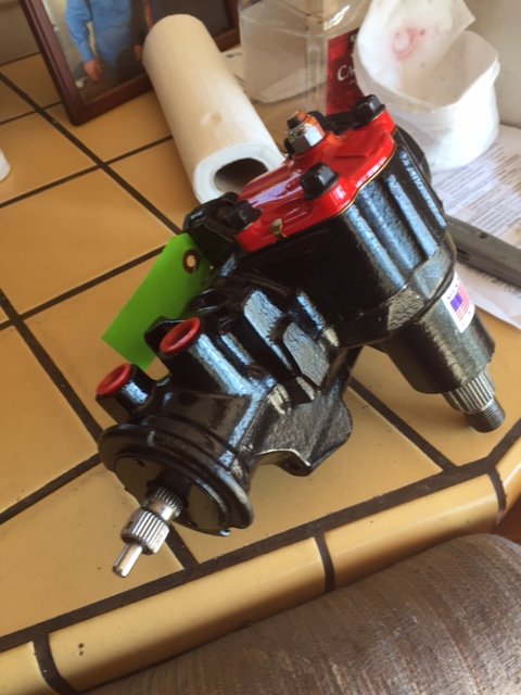

I installed the Redhead Steering Box today, but could not get it into the alignment shop. I'll get an appointment next week and my wife will take it in.
Steering box was long over due. This cleaned up all the slop in the steering. None of the issues that Fermanator had with it being harder to turn in one direction. Steering is one finger control with no slop.
I passed on doing the bushings in the upper control arms. May do that tomorrow, depending on the plans my wife has for me.
Next we'll send the spare steering box core from the '95 wreck to Redhead to get that ready for the GMT 800 brake conversion on my son's '94 Suburban.

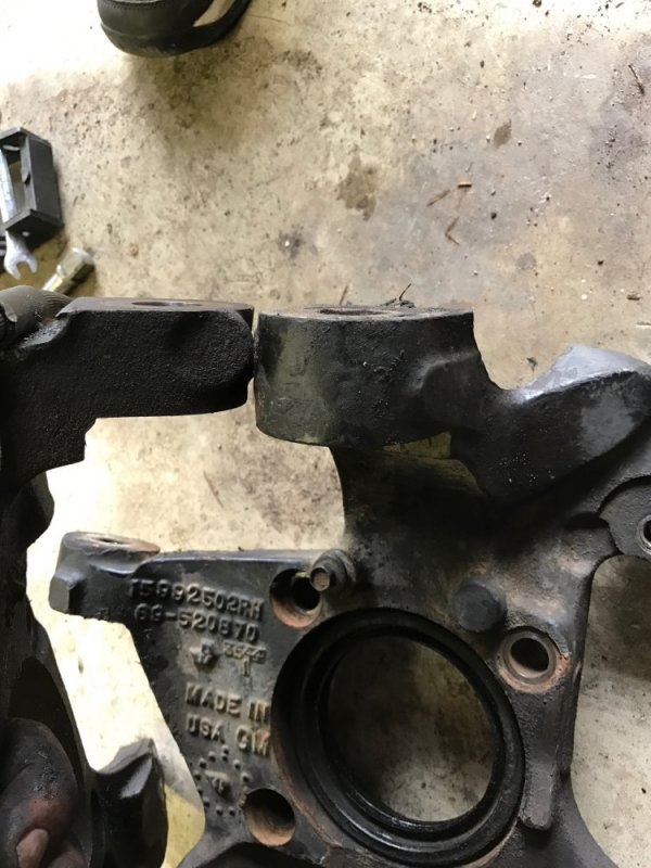

I mentioned it before that the GMT 800 is a thinner casting than the GMT 400 where the ball joint go through. I've attached a pic showing the side-by-side comparison. Though I used the existing ball joint to measure as I reamed the knuckles, when you go to torque down the ball joints you run out of thread and the holes for the cotter pins are beyond the castle nuts. I used two 5/8" SAE washers to take up the space. Alignment guy said it shouldn't be a problem. The alternative would be to find ball Joints with not as long of threads.
