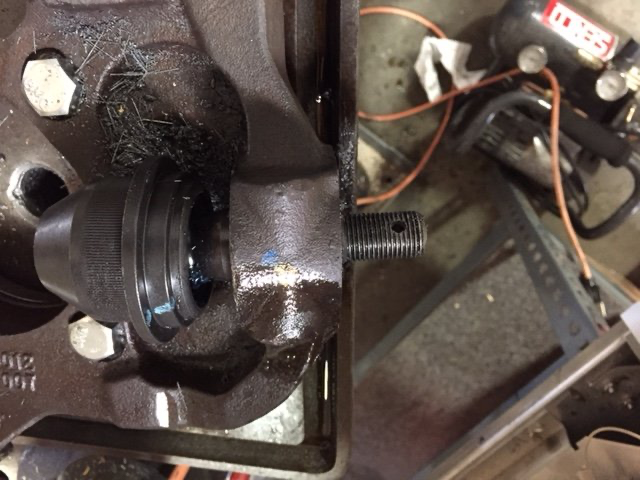

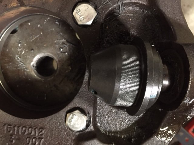

any update on the forged swap? I have stamped arms and I ran into a similar problem as you with the lower ball joint. It didn’t seem to sit all the way in. If I keep reaming I’ll need a 1/2 spacer to keep the nut from borrowing out on the threads. Have you had any problems with the lower ball joint not being completely seated? It’s similar to what you have in your pictures.

I did need to use washers as spacers under the nut to the ball joint. I just over did it some with the ream, though I was using the ball joint to measure the depth. We have had no issues with it.

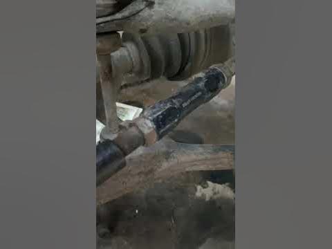

Have not finished the video, but he alludes to some using threaded adapters to the GMT 800 tie rods. I used the adapters on my '99 and reamed the spindles on the '94. If I had to do it all over again, I would not use the adapters. The adapter on the passenger side had some minor play in the threads after it was spun into the GMT 800 tie rod. Over time, I believe that play caushed wear in the upper control arm bushings which you can see in the following videos:
In order to correct this, I will need to thread the larger side of the adapter all the way down to where it’s machined smaller to go into the tie rod, then install a jam nut. Of course I need to redo the upper control arm bushings and replace the bolts. I have a set of black urethane bushings at the Fullerton home and I just got a set a bolts. So more knuckle busting work ahead.

I noted he errantly reamed at an angle and had to used spacers. I reamed too deep using the ball joints as a guide. Thought it would give clearance to the CV hub. I had to use spacer washers (2), but there are no issues.

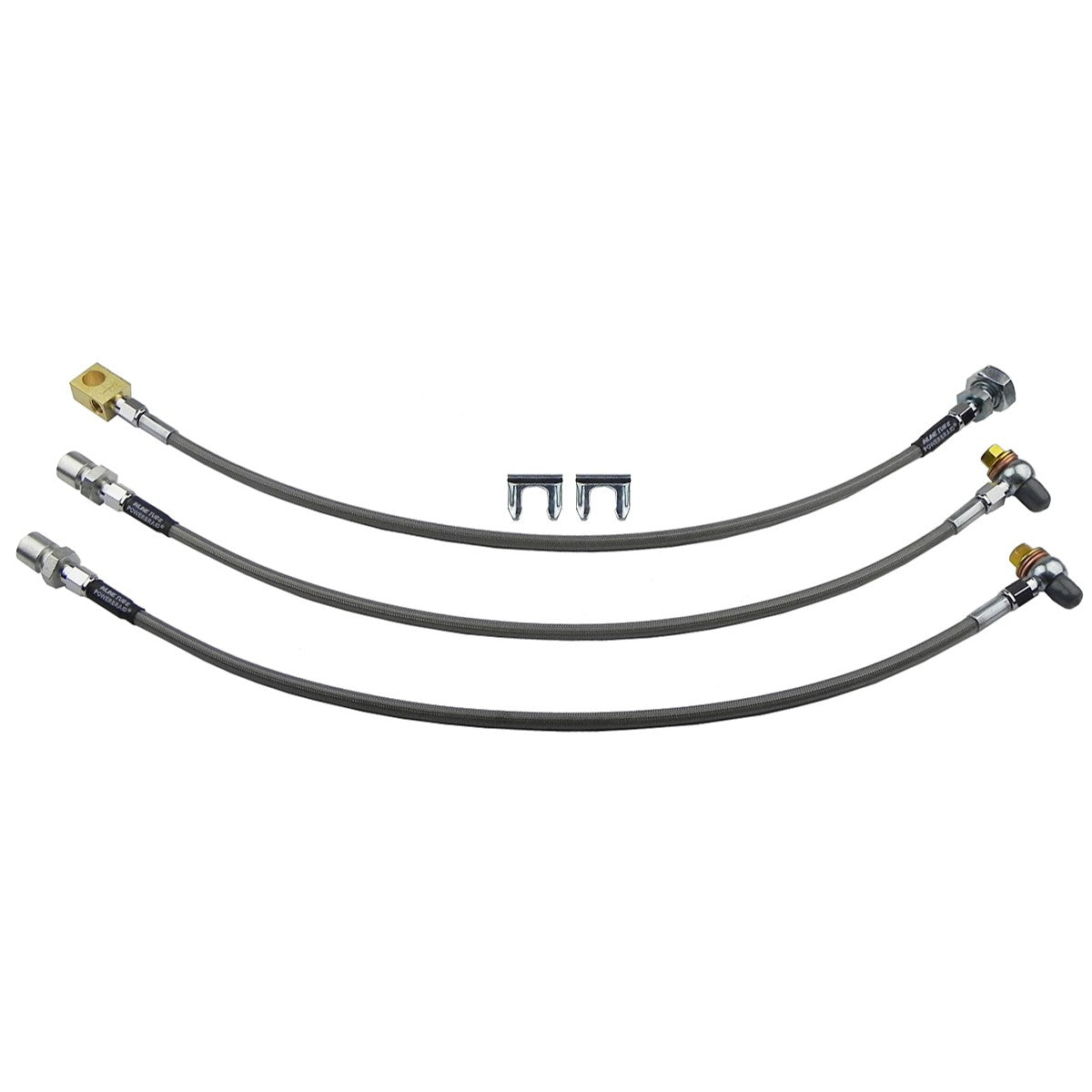

here's the 88-98 stainless hoses from inline tube, assuming these are the ones @Big T already had on his rig they should bolt right up to the GMT800 caliper
Says 24” on the hose length. Wondering if that is the length between the fittings? I measured 26” end-to-end.
