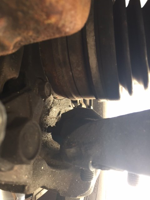

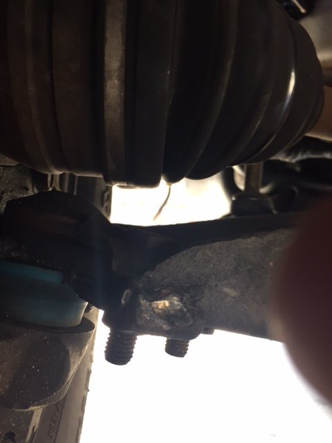

Sorry for the delay but here are some pics of the issue. We might have to look at swapping in forged lower control arms.

Did you ever figure out why the knuckles don't rub on your 1999, but do on the 1994?
I would say they don’t rub, it’s just that the stops on the forged LCA allow more steering travel.
Haven’t installed the forged LCAs yet. Hope to get to that this year. Still a lot on my plate and still recovering from foot surgery.
