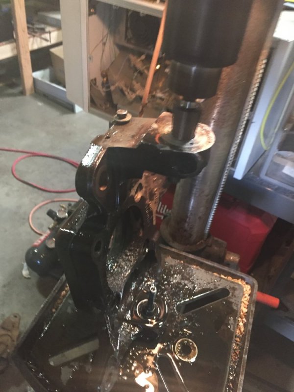

So I used the 2" ream to do the top ball joint tapers of the 2500 HD knuckles. Used a new Moog ball joint to gauge the depth and no problems. Took about 30 to 45 minutes per knuckle using a drill press with the knuckle bolted down.
Question: How do I use the drill press to ream the lower ball joints? I need to come in from the axle side of the hole, but the upper ball joint portion of the knuckle is in the way.
So the holes aren't lined up with each other I take it?
See at the bottom of the spindle where I've used a bolt with washers to hold the spindle to the table of the drill press. I need to come down into that hole to ream it and I can't get the drill press down in their due to the upper portion of the spindle.
so back to my earlier ? do the holes line up? If they were in line you could make an extension for the drill press to allow it to reach through.

My second issue is that the lower ball joint hole is larger. I was using a new upper ball joint to gauge the depth of the ream on the uppers, but it just gets swallowed in the lower hole. I need to order some lower ball joints to gauge the depth of that lower ream job.

I hunted around and could not find a 1/2" drill chuck with a 3/8" hex adaptor which would fit into a 12" extension. Could not find something online either, but I'll give that one more effort. I think my fall back for reaming the lower ball joint holes will be a 1/2" angle drill that my son has. Won't be able to get the pressure that I could from a drill press, so it will take longer.
