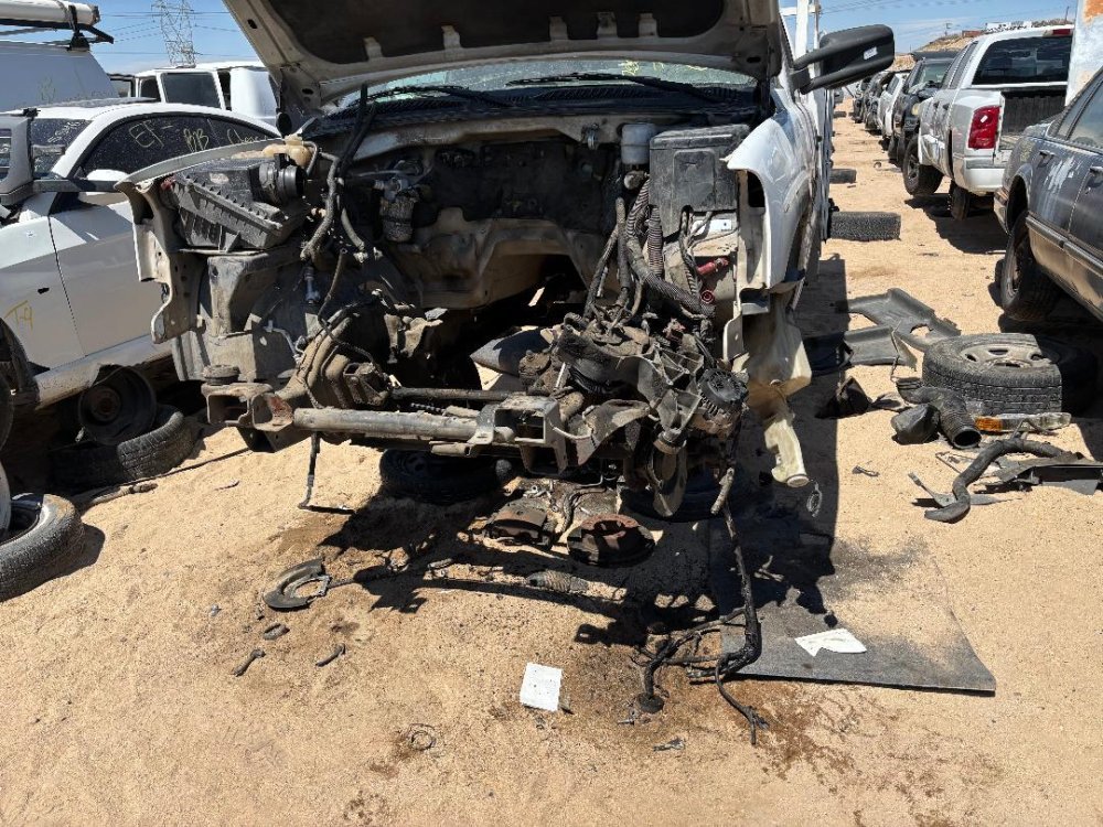

So LKQ Pick-A-Part has now started charging separately for any fasteners and integrated pieces of equipment. Example: when I harvested the GMT-800 axle with disc brakes, I was charged just for the axle. Now they would charge for the disc brakes, parking brake cables, etc.

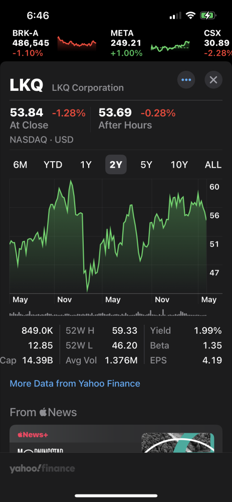

This past weekend I honestly revealed the hardware for the u-joints on the drive shaft I harvested. They said I needed to go back and pay for those. I bitched they had not done that before, but no go. That said, I own LKQ stock, so it get back in the form of dividends and share price appreciation.

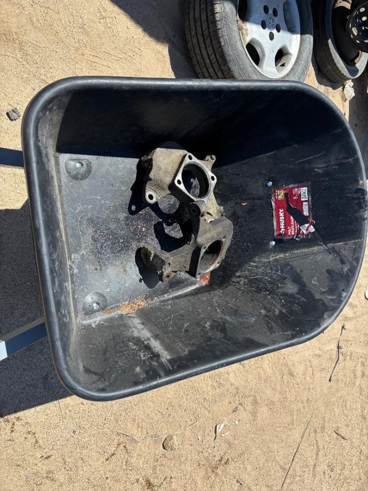

Question- apologies if it's already been covered here-
Will the GMT400 wheel hub/ bearing assembly bolt into the GMT800 knuckle? And will the 800 series rotor slide over the hub without issue? I'm doing this conversion first to a '93 which didn't have ABS sensors.
I know the 800 rotors slide over the hubs while the 400 rotor was held in from the backside by the studs, so several variables to consider.
