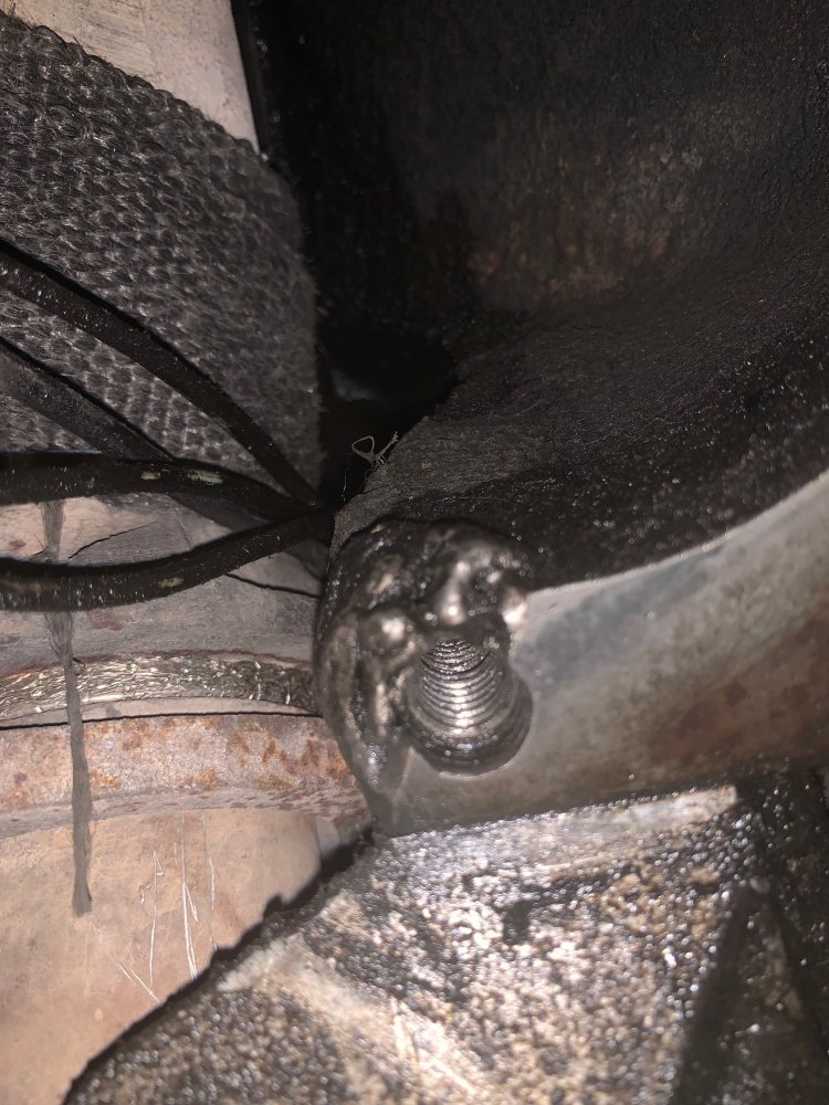

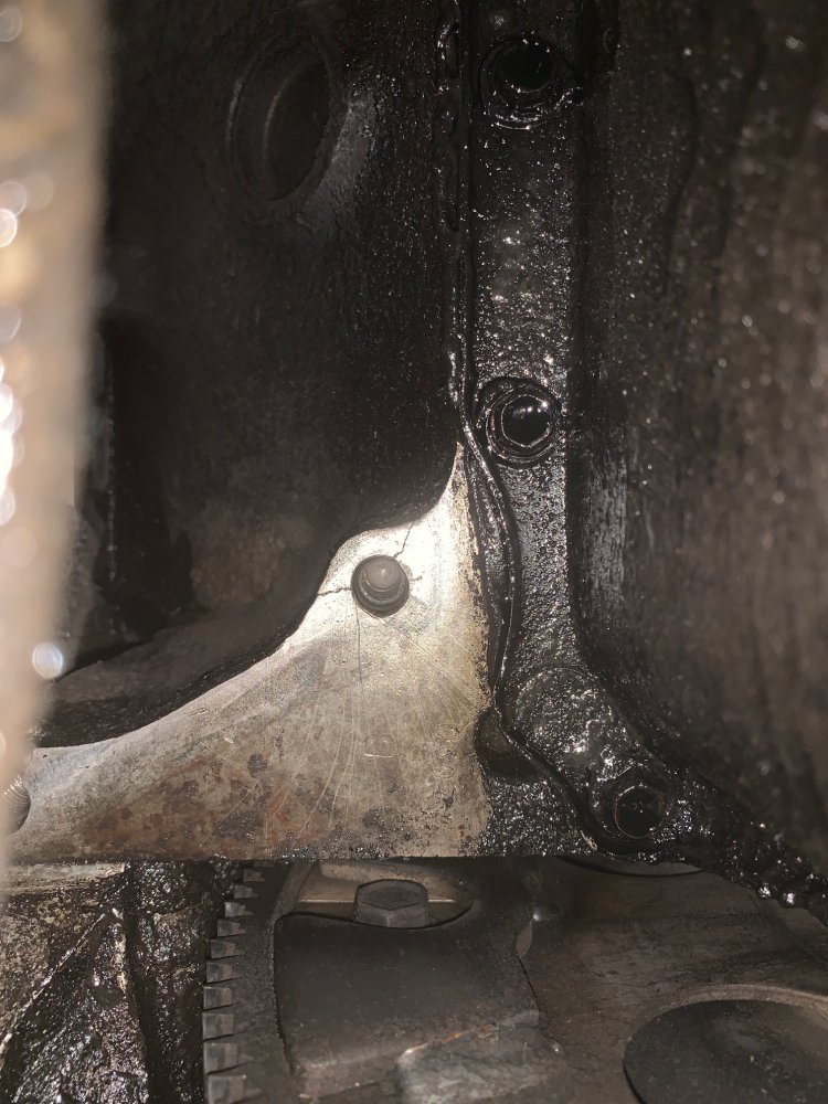

a side note: always make absolutely sure the small bracket is installed and secure on the back side of the starter for these engines. if not, the amount of torque the starter makes can and will break bolts and the block! my 95 truck is living proof for block damage from a missing starter bracket. the previous owner neglected to inform me about the damage which he had welding done on the block. it's still alive and kicking but it's a ticking time bomb for when that weld repair lets loose off the cast iron.
Here is photos of the damage on my block.
I have thought about them busted out starter bolt drillings.
I believe that 3/8ths inch could be machined from the starter surface of the block.
A piece of 3/8ths flat stock cut and carved to fit the shape of the block.
Holes bored to bolt the starter to then tapped.
Two more holes bored and countersunk for counter sink screws. That piece set onto the block and the two countersink holes marked and drilled then tapped.
Two counter sink screws bolted to the block, or if there is room, three counter sink screws could be used and I think the block could be used for many years with such a repair.
At least stock starters would be able to be used.

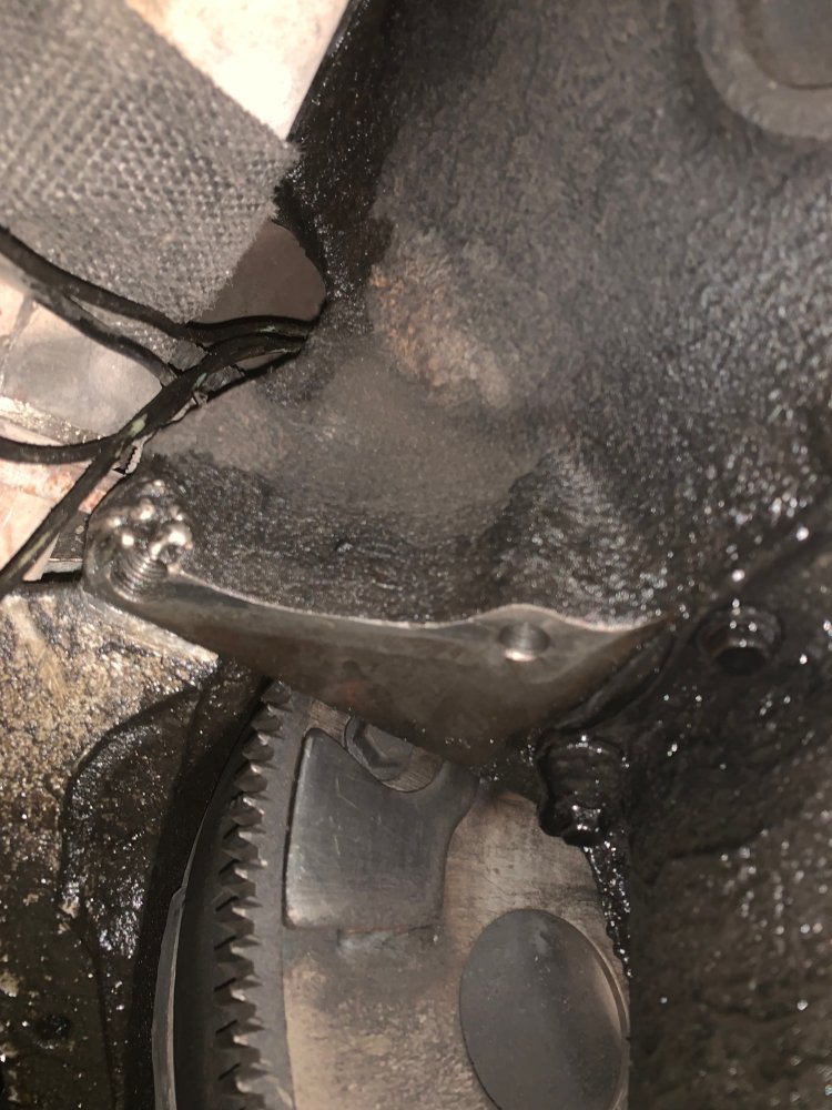

it would have been nice if GM had done a three bolt starter for these engines. GM small blocks use a starter bolt pattern that is straight across, others use the diagonal like ours do. if Gm had used all three bolt holes I think this issue would possibly have been eliminated.
@dieselolds I might one day need to do this. this engine runs perfect, has a little blow by but doesn't use oil like the 93 does. one of these days when I find the need to have to pull this engine, I think I will first check the block for main web cracking, if it's good, I would want to sent it to a machine shop and see if they could perform a miracle on it LOL
I had a 599 engine that ran great at one time but the outer bolt hole was repaired by welding and whoever repaired it did a very nice job on it.I sold that engine for $400 to a guy and some time later the crank broke off in it because the webs let go I’m thinking.I didn’t pull the pan to check for cracks but that’s my assumption.

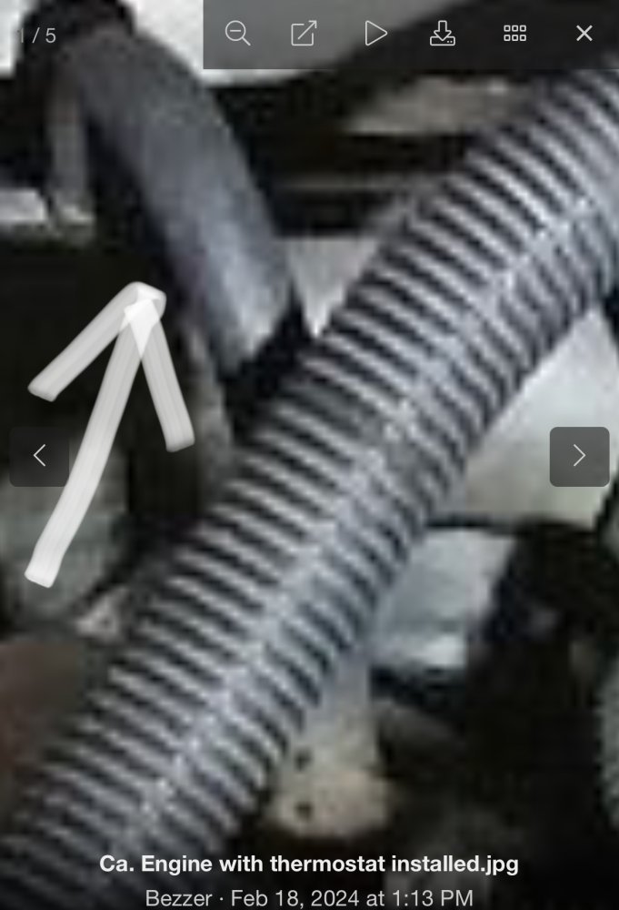

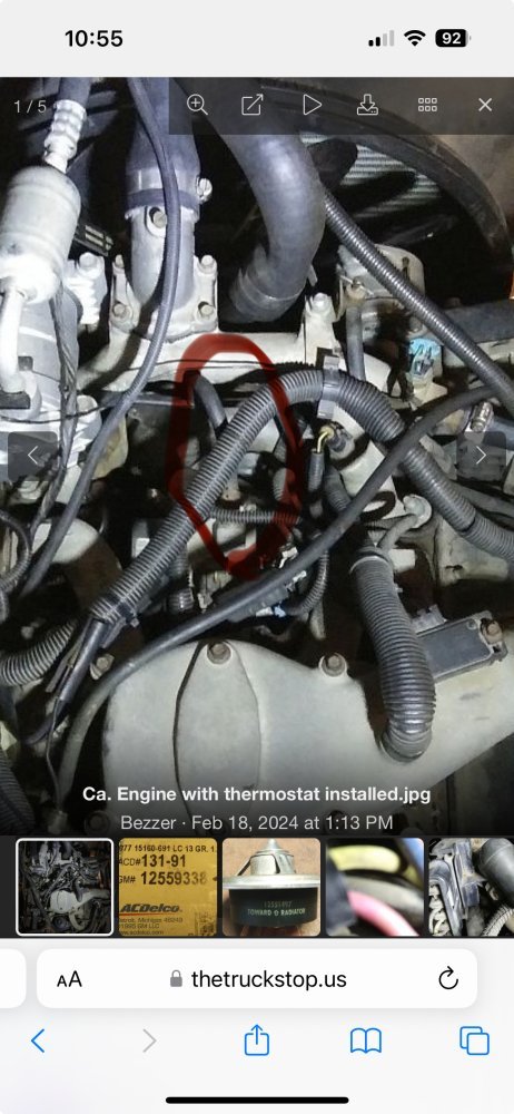

#2. I've read somewhere about changing a black hose to a clear hose? (or hoses?) Where is this black hose they're talking about?
#3. I found the steel fuel lines to the injectors. If I need to bleed them...it looks like it's right close to the glow plugs. Also how do I check for the leaking injector that someone suggested? If that's right I will need to take the wheels off and all the rest of the crap again....LOL
The clear hose: replace the ip return line with clear. The 1/4” hose out the front of the ip in an upside U shape. Here is the ideal hose. https://fuel-line.com/collections/fuel-line/products/1-4-fast-flow-fuel-line-1
Otherwise some that will last about 4 years is at hardware store. Its all sold by the foot. buy one foot cut in half.
Getting a trapped bubble in there is normal. If you see any frequency of bubbles flowing through- that is a problem to chase.
I red circled the hose in your picture, then other picture is zoomed in with the white arrow pointing at it.IMG_0242.jpegIMG_0243.jpeg
