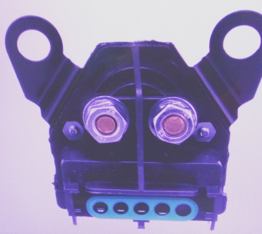

Will L. : Here's the picture for glow plug controller that replaces the one in my motorhome...it's for a 6.5TD as per O'Reilly.
Standard Ignition 4 Terminal Multi-Purpose Relay - RY139​
The one on the motorhome is the original.

Glagulator: I'm only going by what O'Reilly and Rock Auto lists as the correct controller for my RV that is a GM 6.5 turbo diesel engine.
How are you coming up with a three wire ? They say three wire and the four wire will work.

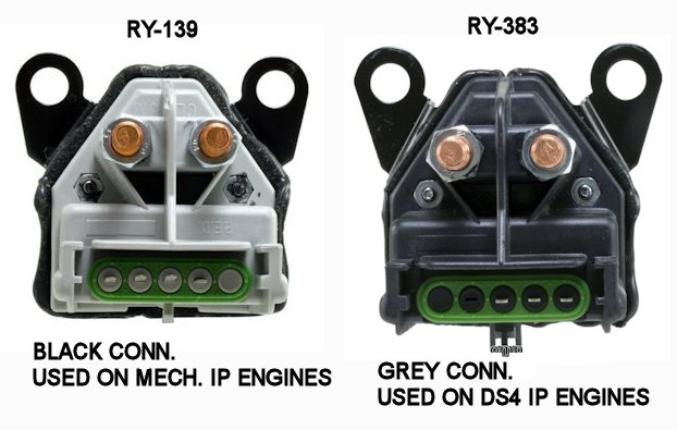

The old RY139 GPR was self controlling and is used on mechanical IP rigs, has 4 terminals, black conn.
The new RY383 GPR is PCM controlled and is used on DS4 IP rigs, has 3 terminals, grey conn.
Both connectors have 5 term. spaces and look the same but are keyed different and will not interchange.
Without disconnecting-count the terminal wires going to it. The older is 3’wire and newer is 4 wire- but I have seen rv built that have a ds4 ip and use the card style related controller which is older than the 3 wire.
The reason I am saying look at it now is incase you have to replace it in the future you need to know which is appropriate for your rv. DO NOT go by what a pickup uses because they can throw whatever they want into the rv.

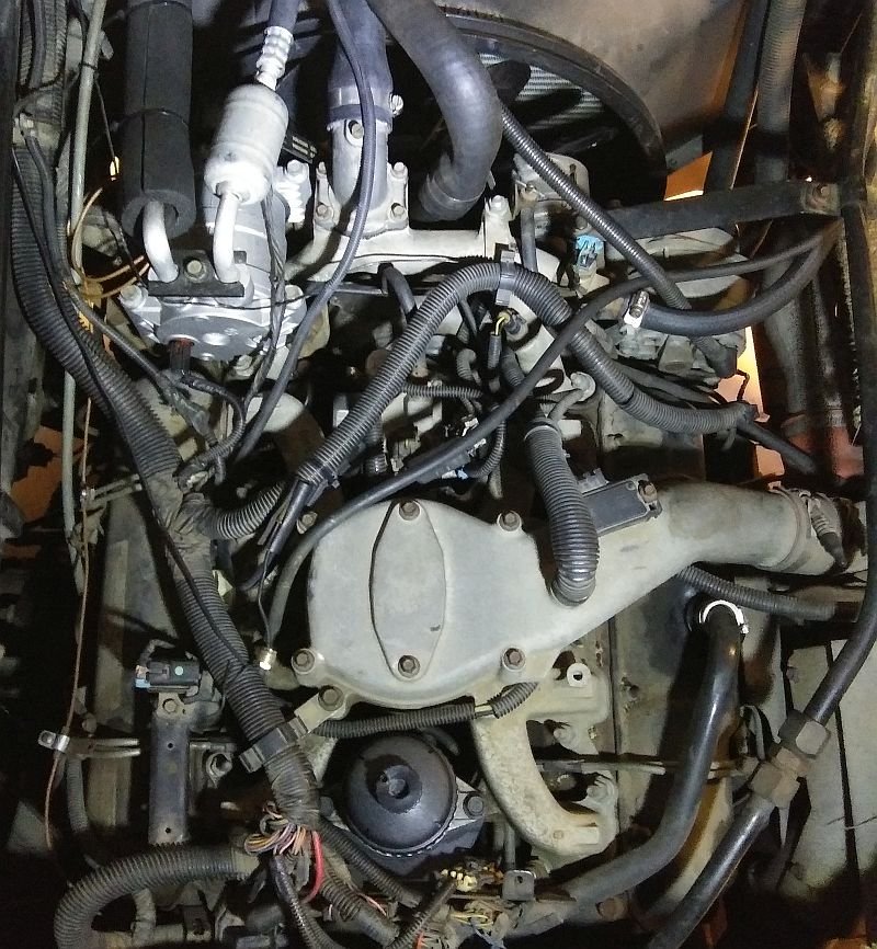

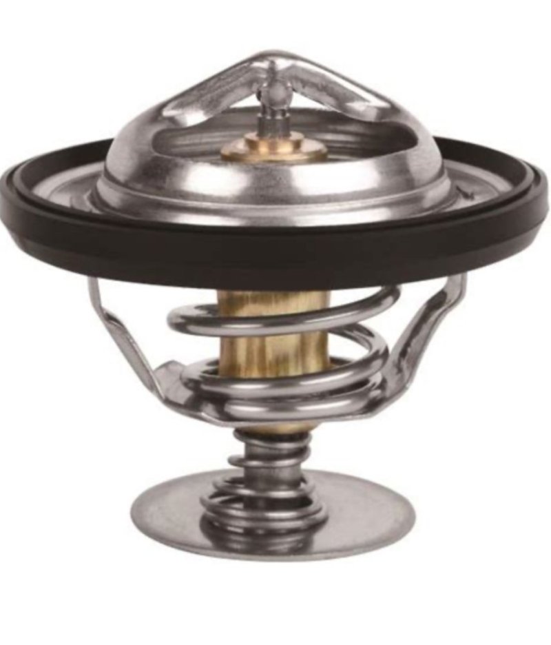

I see you have your thermostat out. Can you post a pic of the new thermostat?

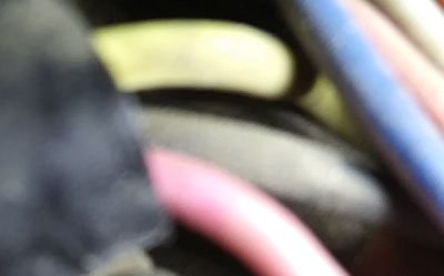

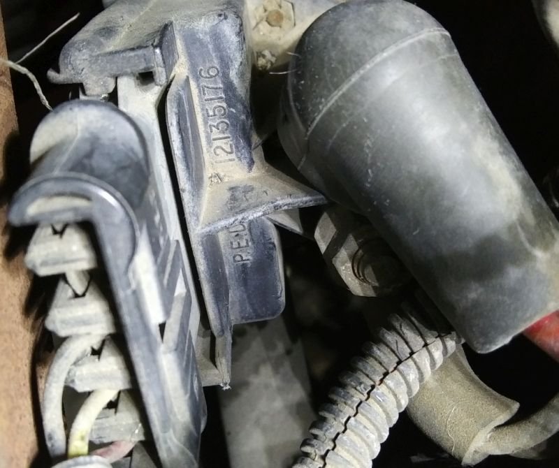

I have a three wire controller. See pic A1 and A2 showing the colored wires.

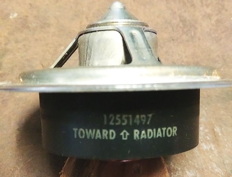

Thermostat answers: Here's a picture of the old thermostat that I changed while doing maintenance and changing the anti-freeze. (See pic Ba)

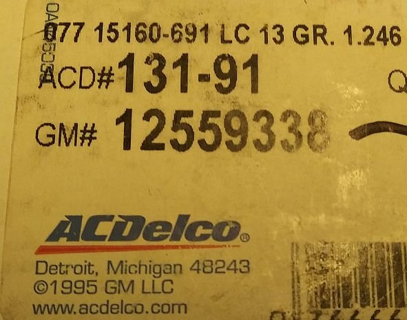

Here is the box with the new thermostat part number that I put in. When I put it in a few years ago - another truck site swore to not get any other thermostat except this one for the 6.5TD. (See pic Bb) The old and the new are 190 degrees and have worked just fine.
This one is special for Will L.: You saw an old engine picture with no thermostat housing .... I was waiting for my new thermostat. So here is today's updated picture. (See pic Ca)

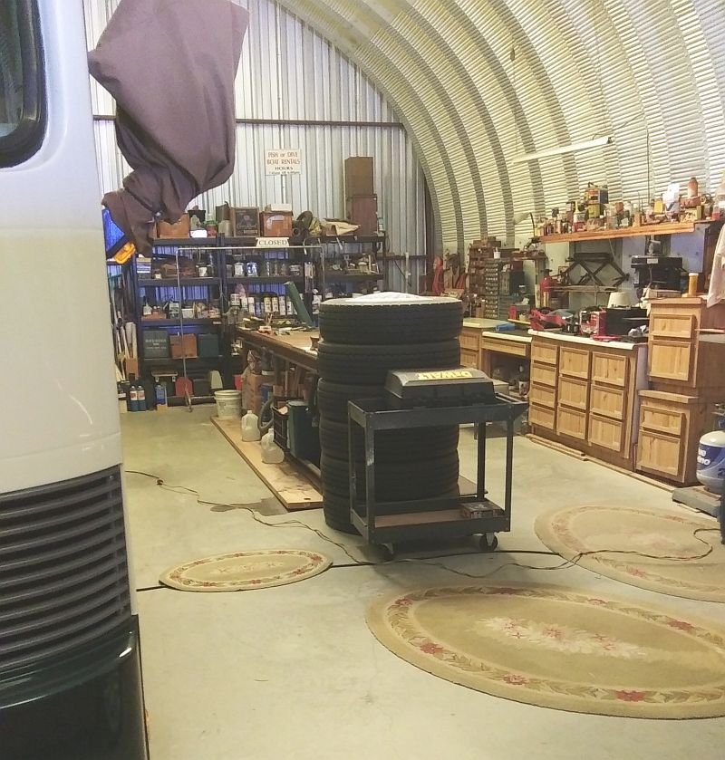

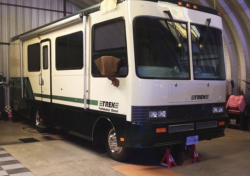

Took these pictures today of my garage and workshop. My garage is 40'wide by 50' deep and 18' high. And part of my workshop.
your glow plug controller is for a 95+ year model. take note of the GM part number in that photo stamped on the controller. if you ever need to replace it you can use that number.
On your thermostat, did that one use an o-ring on the housing or a gasket? just curious. I see that's a 190 degree one, but doesn't have the lower block-off plate. your t-stat housing might not use the style that has the lower block off plate. our trucks use those!
Thats a really nice shop! and even better looking RV might I add :)
Doug- look up the part number in his pic- that IS a block off style thermostat.
Beezer: Thats a great set up to have. There is two crossovers that are very similar that use the 4 bolt pattern for the housing- one has block off the other doesn’t. The 131-91 ac delco IS a full block off- so that is awesome to see. If the crossover ever gets cracked- have it welded up and fixed, do not try going to a different style if at all possible.
Just because we were talking starting components- is why I was asking what type you have, incase yours goes bad snd a parts store gets you a wrong one. There is two that look almost the same but one has the 3 small wire connections and the other has four. And if you accidentally put in the wrong one it won’t function quite right.
