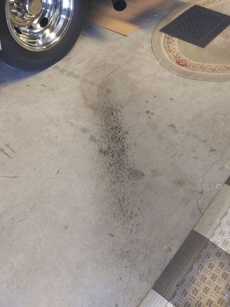

After the R&R repairs I have made to this engine tested the motorhome several times.... I believe the problem is 2-leaking injectors after the engine is turned off.
After the engine is turned off and the fuel pump stops running....How long does the engine hold fuel pressure? When the pressure is gone - it shouldn't leak any more?
When I restart the engine the next morning it spits out a spotted area of moisture along with a puff of white smoke. See attached plain picture I took of the floor moisture- I haven't touched it to smell if it's diesel fuel.)
Is there any way I can test these injectors without removing them?
After the original first start the motorhome always runs perfect as it always has - even after we stop some where and then restart there's no smoke or noise or moisture on the road.
I did take a plain picture of the exhaust mark when it started.

Injectors are always a possibility. how many miles are on the current set of injectors? Will and others will tell you they need to be replaced at 100k mile intervals. there is no way to test them in the engine. the only way to test that I am aware of is to remove and send to good diesel shop to have tested. @Rockabillyrat is the guy when it comes to injectors!
Heated exhaust cools and any moisture condenses and blows out at the cold start.
This happens to most vehicles.
80K to 100K miles, lower because his have worked harder pushing a bread box and then consider the impact of just age. He said his injectors have 79K miles. I said early on he had leaking injectors, but he never provided video for a thorough diagnosis.

I can tell you from days with bad injectors on cold mornings in Montana, he’s got worn injectors. If he does not replace, he’s at risk of burning pistons.
Oh, 100% agree if worn. Search back on this forum and you’ll see I brought the recommendation here of 100,000 miles intervals on injectors. Because thats what I recommended in the fleets I ran.
But from what I saw- I don’t suspect a problem with his injectors.
By his mileage- I don’t suspect a problem with his injectors.
Is it a horrible idea to buy another set of injectors, or rebuild these and have them tested and balanced? No, but not really prudent economically considering the amount of miles put on the rig since new and he is the original owner.
Imo there are other things to do before that for the age and condition of the rig.
Start with a decarbon. Inspection and replacement of certain components that will go with age regardless of miles like oil cooler hoses, harmonic balancer, coolant hoses, fuel hoses.
then things like clear return on ip, fuel pressure gauge tapped at ip inlet, consideration which type lift pump is in use, etc.
Then if the rig is going to start getting a bigger increase in its use- a larger turbo to help with fuel consumption and egt drop while getting a few ponies for free out of the deal. At that point I would say having new & balanced injectors would come into play.
Gotta remember, low mileage and his factory injectors were built in the old location when they were still being built well. Just a random swap, especially if some sub par parts are used, it will do more harm than good.
