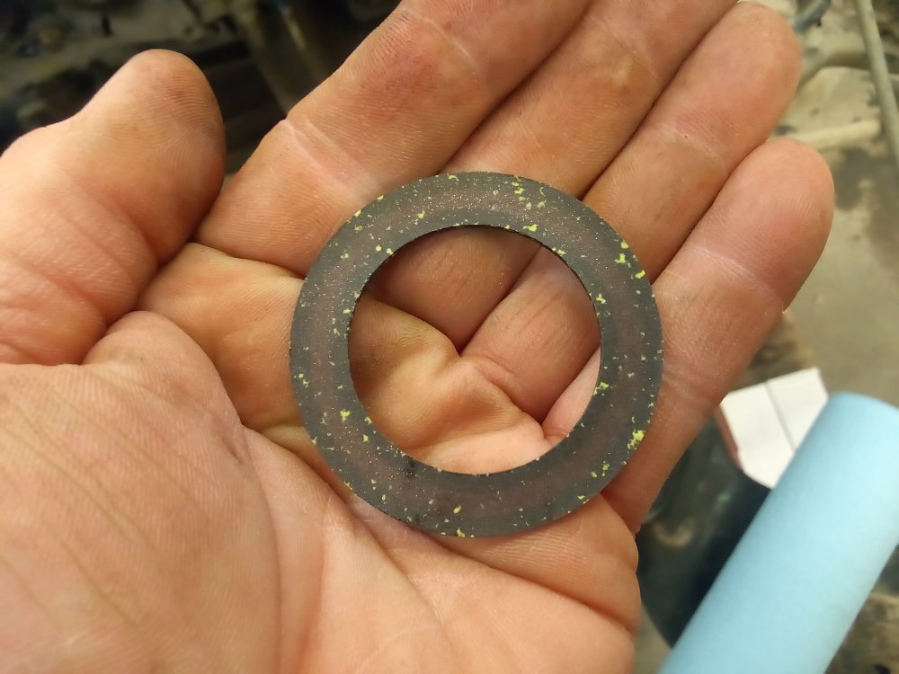

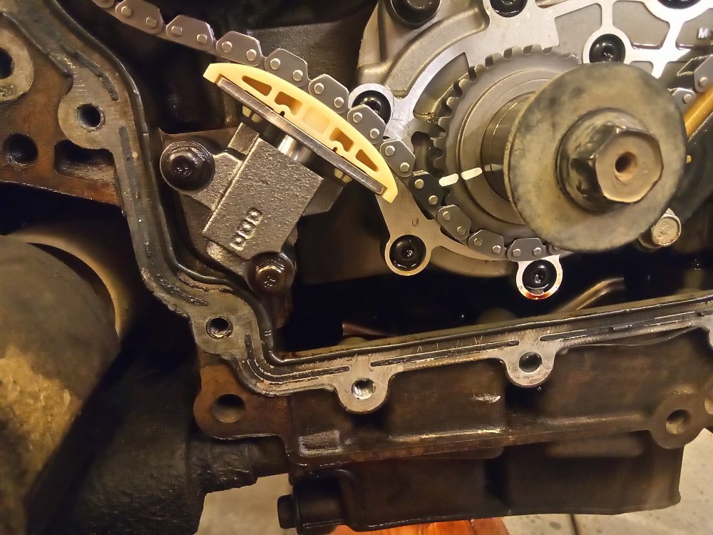

So my local dealer only had 2 so they told me that they would have the others in a couple of days. Then later today they called and said one of the dealers in Anchorage had some so he had all 4 waiting for pickup.IMG_20221220_195124.jpgIMG_20221220_195131.jpg
The thrust washers seem strange to me. They appear to be a semi brittle fibery plasticky type material. Not at all what I would have thought a thrust washer would be like.

Before disassembly I decided to check the gap where these fit and as far as I'm concerned the washers are too thick. I took a mallet and a small pry bar and moved the cam as far as I could, which wasn't alot, and the washers wouldn't even come close to sliding in the gap. The cam has a ring that fits in a groove in the cam cap. I had Chris coat the caps and I'm thinking it took up some of the clearance so I'm just leaving them out. Besides that it ran for 150k before without issues.

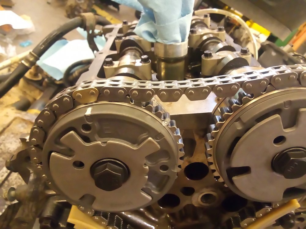

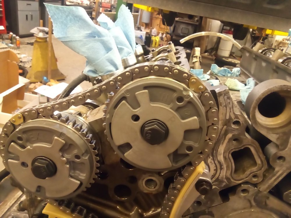

But back to the car still won't start,checked spark that's good, checked compression and low compression. 70 psi
put that cylinder at TDC and put air in it and no air out the intake or exhaust but a fair amount out the crankcase. Talked to Rockabilly about it and he rechecked my photos of my timing marks and he thinks it looks good. So I'm back in the head scratching mode. Probably won't have much time to work on it for awhile
