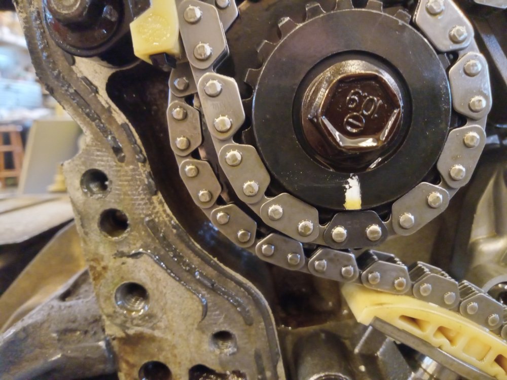

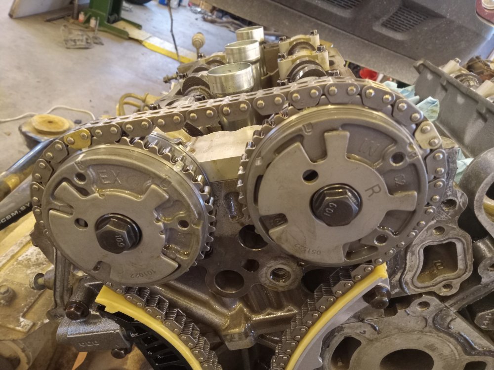

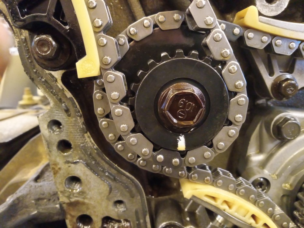

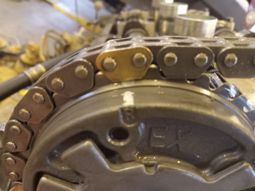

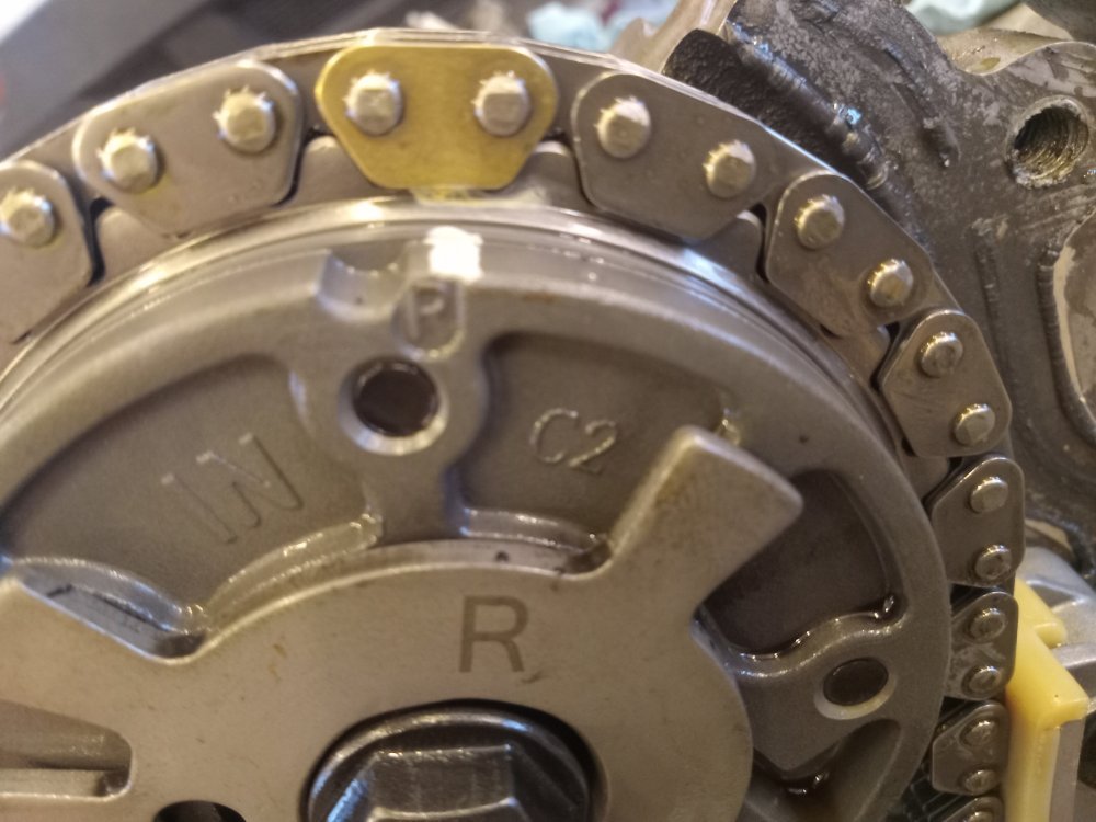

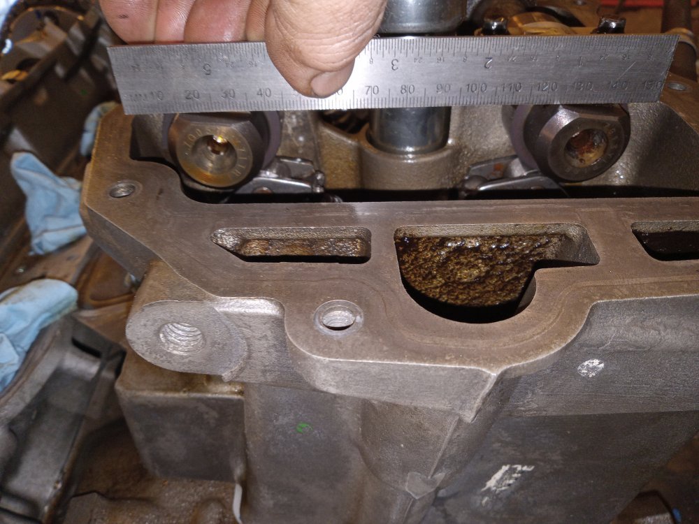

Like the sprockets has to be in a different phase than what they are when relaxed ? I guess that would be the word ?Been thinking about this and I'm wondering if the discrepencies I've been seeing on the flats is caused by the phasers being able to move and the valve spring pressures on the cams
Thats some good news.So I can offically confirm that the timing marks are off. All back together and running better than ever. When I first got it back in and started it it ran like crap. Had 3 codes one for knock sensor circut one for cylinder #3 misfire and one for map sensor. I called it a day at that point, came back out this morning and after thinking about it I decided to check the knock senor by the CKP sensor. Sure enough I had failed to plug it in, not an easy reach to get it plugged in either. Fired it up again and it still ran like crap so I pulled the #3 coil and sparkplug. Did a compression check while I was there just to make sure nothing mechanical was going on. 150 psi with only that one plug removed. Swapped coils with another cylinder and it didn't make any difference except now I just had a generic code for misfire. Borrowed my buddies scanner and it showed that cylinder 3 was still the one misfiring so I bought a sparkplug and put that in. Got rid of the code but still ran like crap, was in the process of starting to remove the intake manifold to look for a vacuum leak when I noticed a hose that didn't appear to be connected. It wasn't until I removed the upper half of the aircleaner and the intake tube that I saw it. Pretty hidden once everything was in place, turns out it was the hose going to the brake booster. Only a minor vacuum leak! (insert face palm here). Once I fixed that it purred like a kitten.
