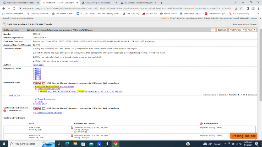

So something has been going on with this and my initial thought was I had messed up the timing but the more I thought about it the less I thought I did. Did a bunch of reading and watching vids etc. Rockabilly has been extremely helpful. He sent me thisScreenshot (10).png
so I did this test and came up with about a 10* variation from what the scanner showed. So it looks like I'll be pulling the engine again to check this and the chain timing again.

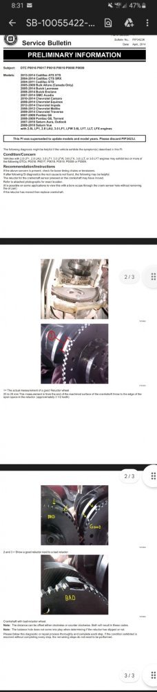

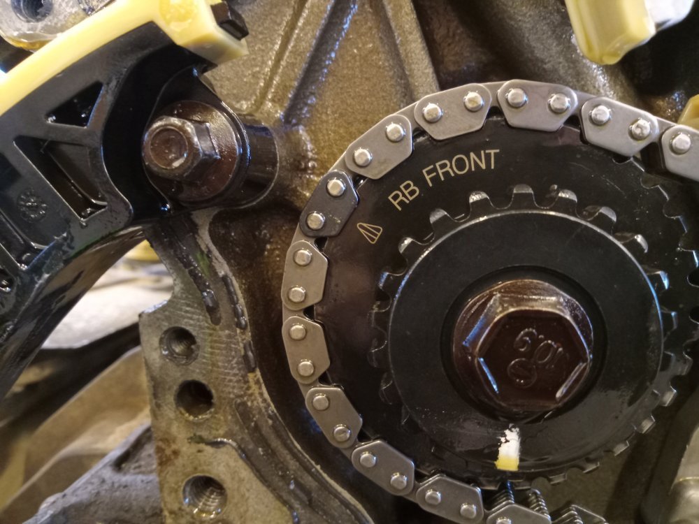

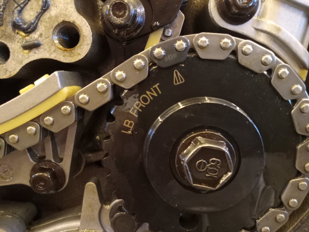

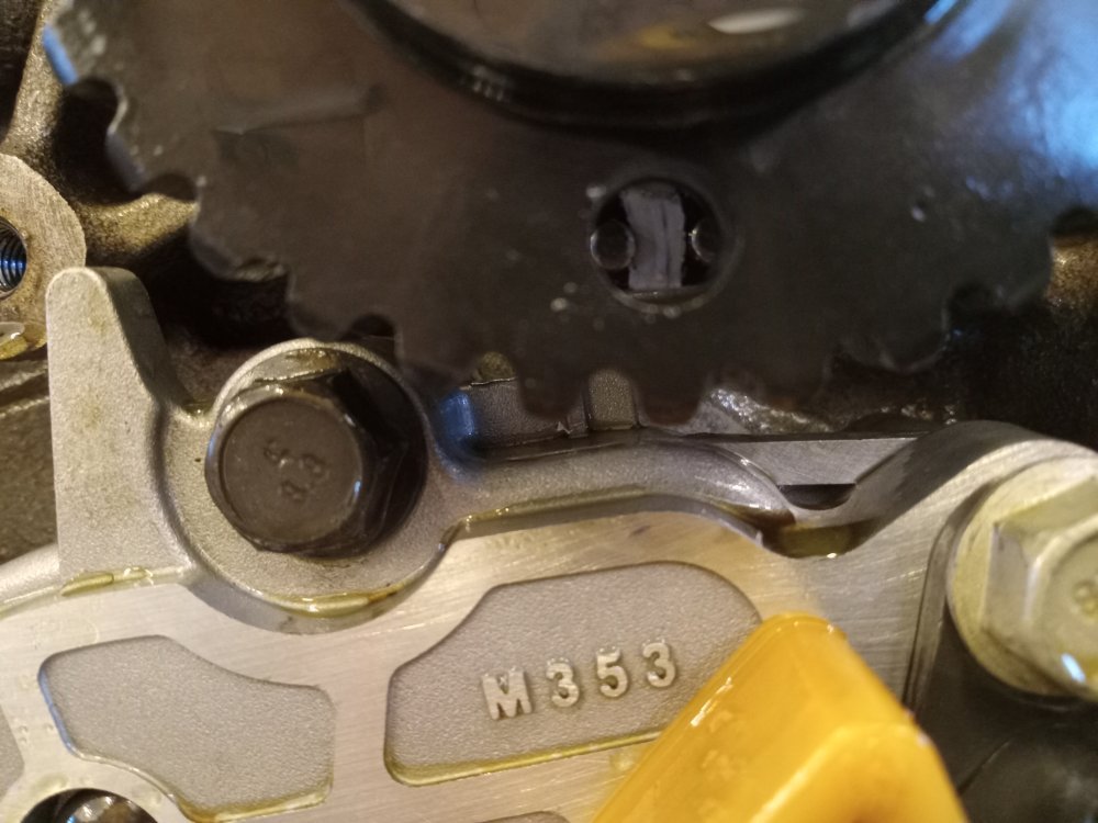

So I thought I'd update this. So I pulled the engine down to a long block, pretty much had to to check the reluctor on the crankshaft. Turns out it was fine. I still don't understand why the timing light showed so much difference. So I put the oil pan back on and remounted it on the transmission and subframe. My thought process doing this was maybe turning it a little backwards made the chain shift.

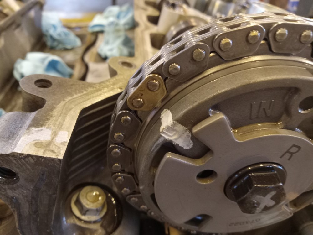

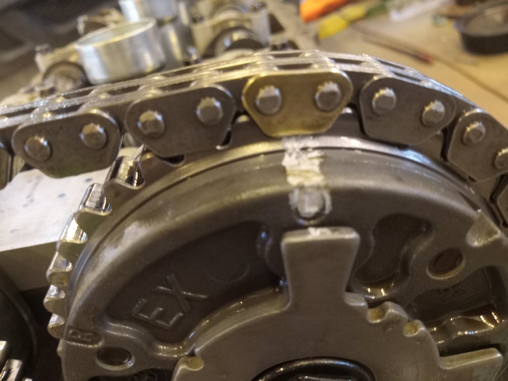

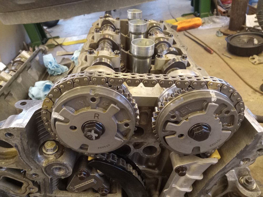

Finally got around to redoing the chains, when I did the stage one chains everything lined up slightly better than it ever had, the flats on the cams were never perfect but pretty darn close. This time it seemed perfect. Went to the stage two position and put that chain on and the flats didn't line up very good, worse than I remembered for sure. So I moved the chain one tooth off on the idler pulley and the flats lined up pretty good, not perfect but much better then it was. Only thing I can figure is something on the chain or idler is mismarked.
Still trying to decide if I want to try and run it this way or not.
