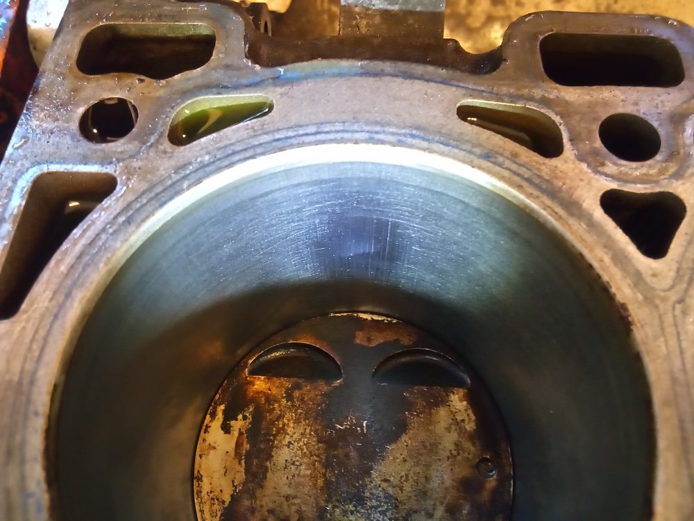

Inspecting the cylinders closely and I find thisView attachment 78851

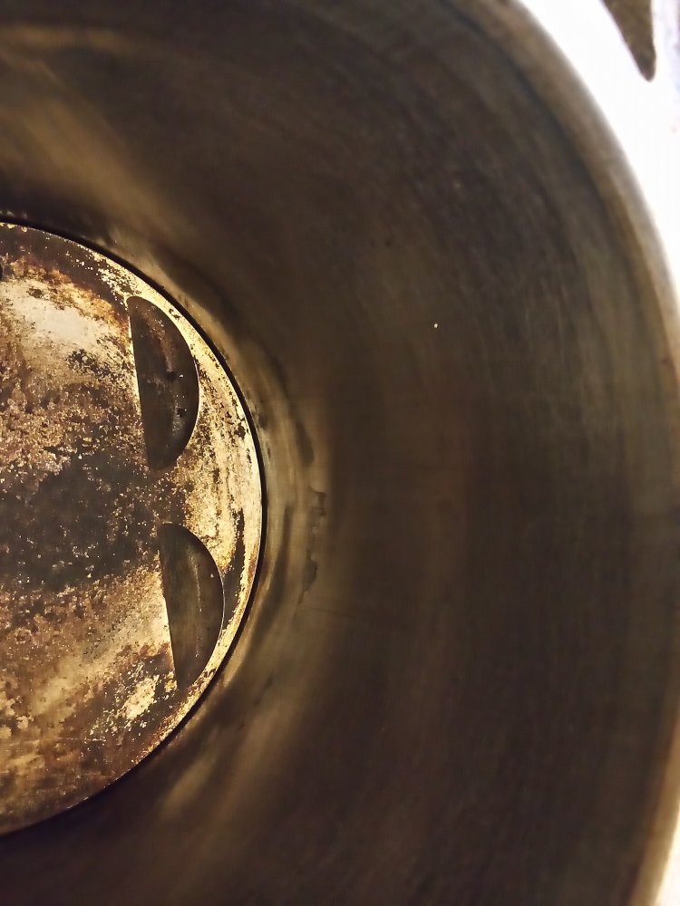

Some discoloration and then this View attachment 78852
Actually shows up better in the pics then in person. Can't feel the marks though
Unless the piston is much worse than the cylinder. 🤷‍♂️
I’m not seeing in tje first pic what You is intending to show.
My eyes aint so good though. Go in Monday for a fix.
If the scratches in the cylinder wall can not be caught with a fingernail, if it was my engine, use some 400 sanding paper and dress up that area, get a new piston and figure out why that gapless ring seized within its groove.
That one piston alone could cause a case of blowby.
Inspect the rest of the pistons and rings too. Make sure that all of the rings will feely rotate within their grooves.
The shiny spot may be a high spot in a warped cylinder or the stuck ring was the thrust bearing for the piston.
IMO the rings that were stuck are destroyed, but, I would ask Total Seal about it with the pictures. My concern is the cylinder scratches also scratched the ring to cylinder sealing surfaces.
Yup, I would not reuse any of those rings.
Only check them to see if any more is sticking, and, try to see why that one cylinder ring was sticking.
I would not even use that piston.

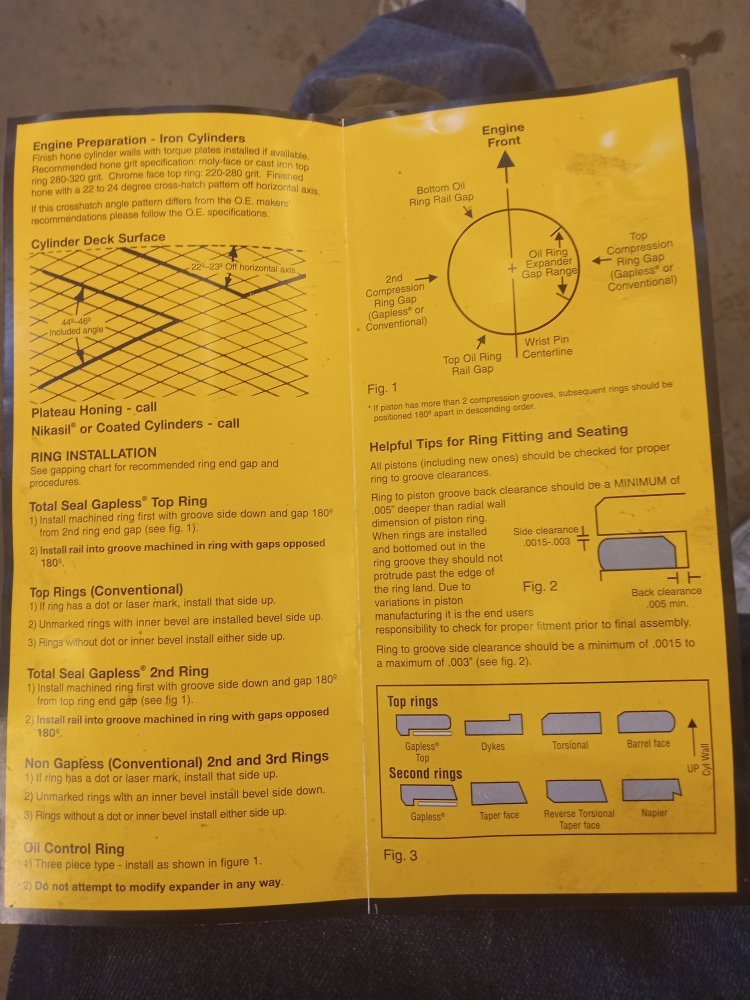

So a little update. Finished putting the bottom end back together just now. Thought I'd post what I learned about gapless rings. In the past I always just sent them the second ring and I got them back in a package without any literature. When I was contacting them this time I got on their website to get their number and got noticing the pictures they showed of gapless rings, and the pictures all had the ring installed in a certain way. So while I was on the phone with the tech I asked him if it matters which way they go in? Oh yes he says if you put them in the other way it'll suck oil out of the crankcase and you'll use oil. I gave him a little piece of my mind and told him they needed to send literature. Kind of a big deal IMO. So you guessed it I had them in upside-down. Explains the oil consumption and the rings being stuck in the groove.20230228_151740.jpg20230228_151801.jpg20230228_151808.jpg
