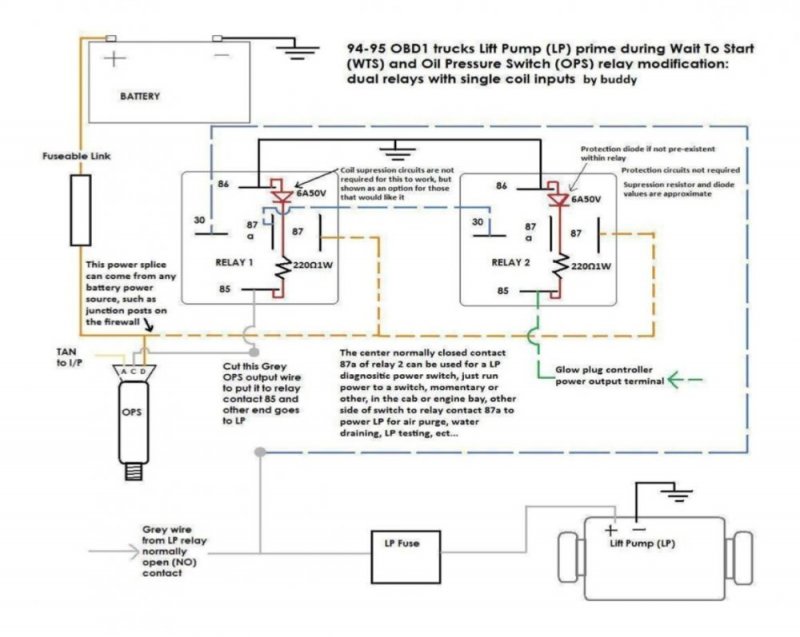

iT HAS ALWAYS BEEN MY OPINION That the prime feature is very nice to have. I incorporated it with Buddy's schematic. I do not care for the momentary switch either. I prefer a toggle switch. I also prefer a mountable relay socket instead of a mountable relay.

For the prime function, I'm pulling power from the glow plug relay post. This is what is laid out in the schematic.
My harness is made from the schematic that I've referred to a number of times - Is this not the way to do it?

If your tapping the heavy post going to relay then that is the wrong place IMO, that will overload your LP relay big time. I am betting this is where your problem is. Try removing it and see if LP will come on normally.
If I were to add a prime feature I'd tap into the control signal (one of the small wire on GP relay). I have not look into it yet so if anyone out there knows witch of them is hot only while in WTS let us know.
